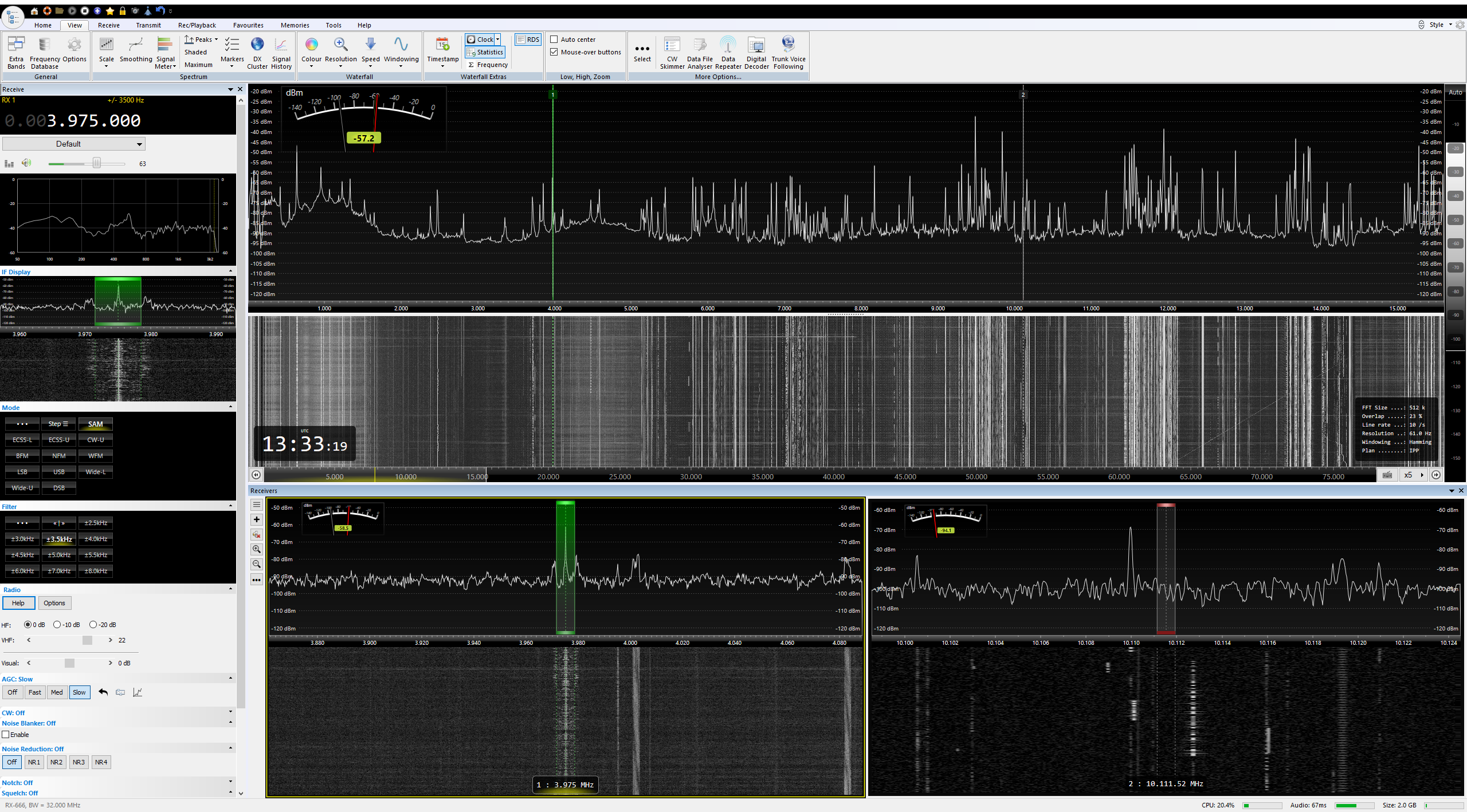

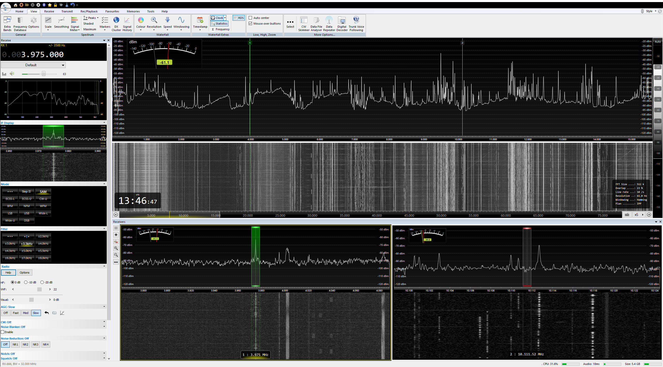

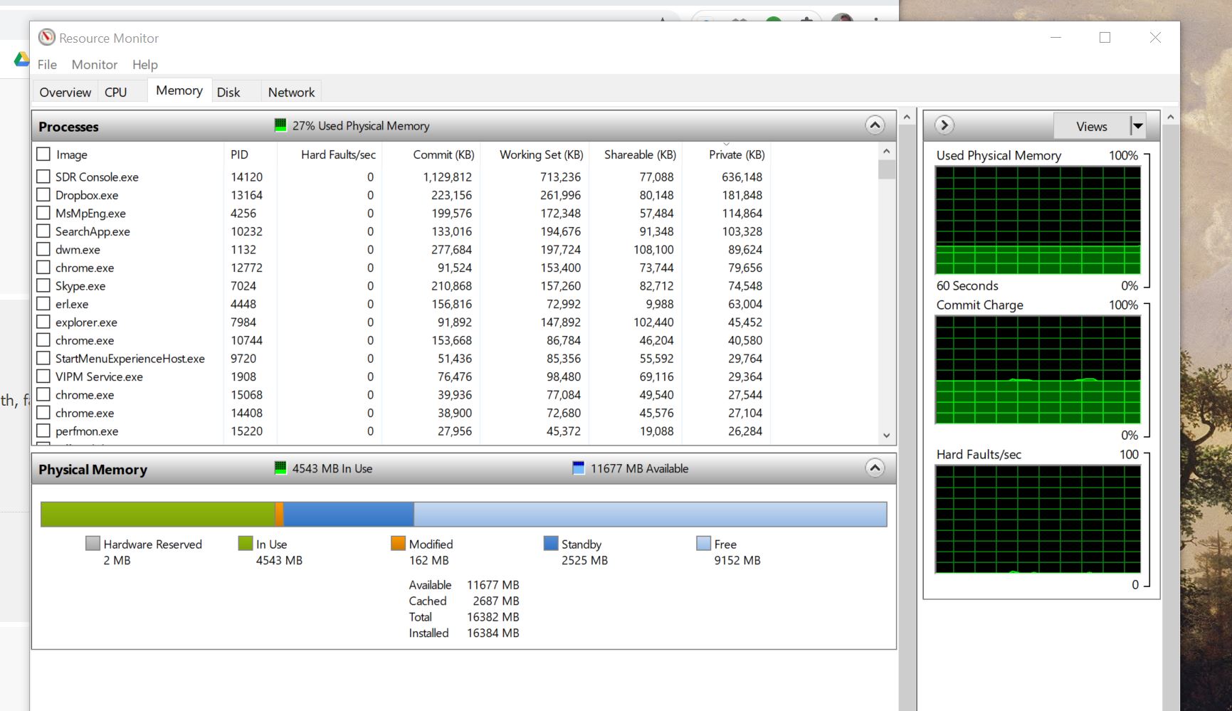

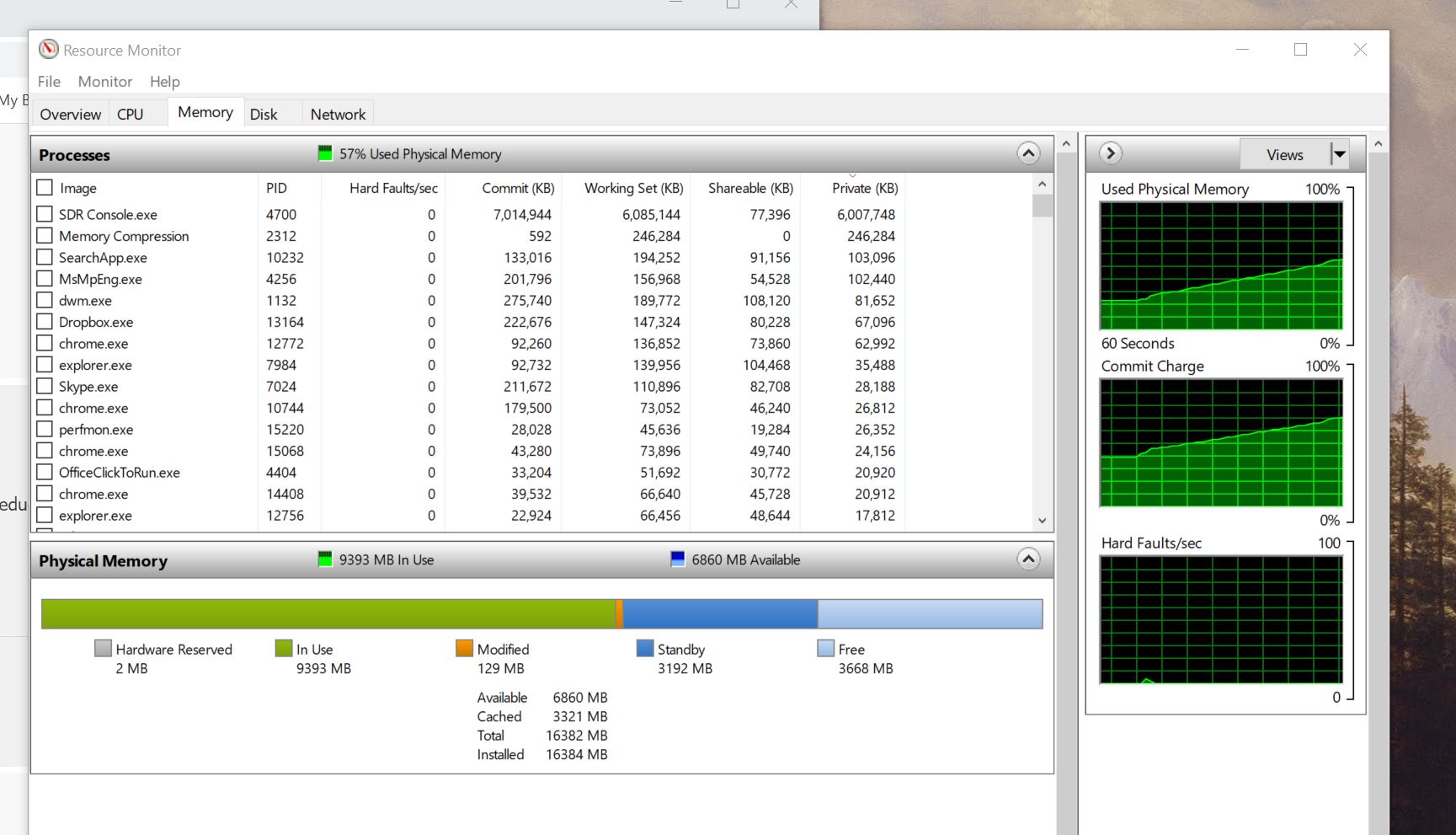

Ok, here they are ...
The lower was taken after running the Console for a few hours, RAM usage is constant at 2GB and all is working perfectly.
Then I stressed my system by opening Ligthroom, but it also could have been just Chrome with many tabs open or whatever brings my (weak) CPU to the limit. This (of course) limits the ressources for the Console, stuttering starts and RAM usage is increasing constantly while beeing in this overloaded situation. After going back to normal system load (closing the other programs, no stuttering anymore), the used RAM size stays where it was brougth to during the overloading situation, but counting up again as soon any overload/stuttering appears again. See second screenshot, having now 5.4GB of RAM usage. As I wrote before, I can drive this up to 20GB before my system is chrashing (meaning: no reaction at all, hard reset needed to come over this).
Of course this is not the right way to use Console ... but if any short overload situation is counting up RAM usage till system crash, maybe this could be handled somehow by limiting the allowed RAM usage and stopping the radio. I also tried to find out what could free RAM, but I found nothing else then closing and restarting Console.
