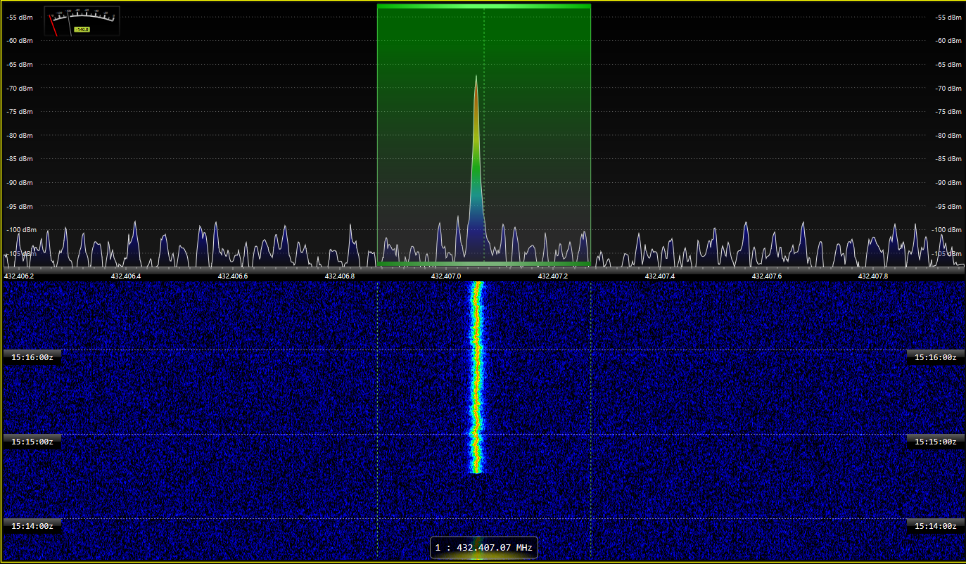

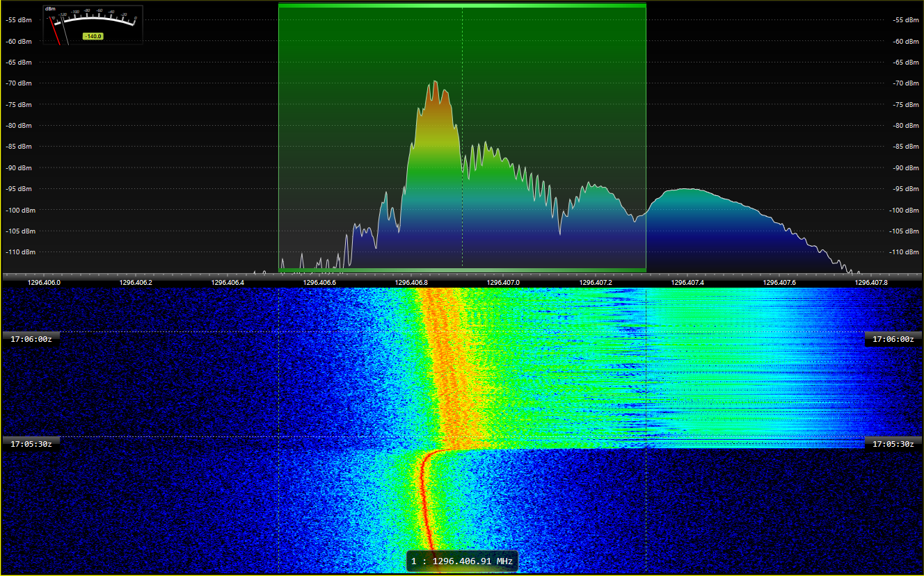

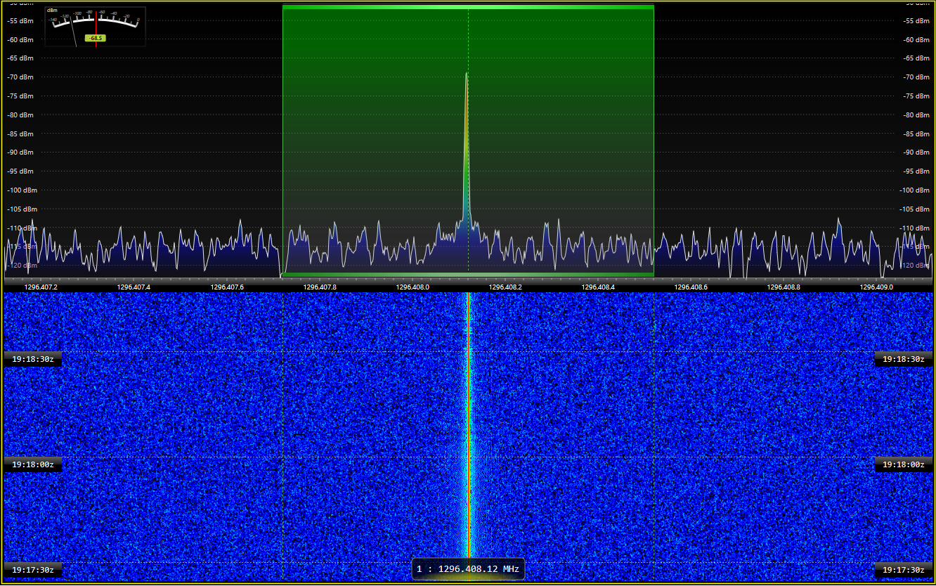

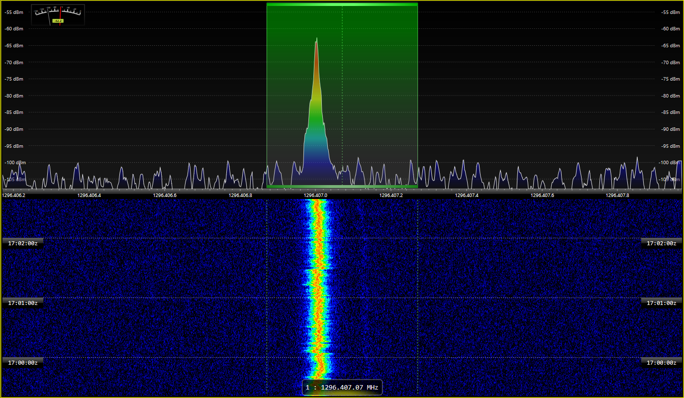

I have now looked more at the frequency stability of my RX-888 at UHF (432 and 1296 MHz) and compared with two other SDR's covering these frequency bands.
LIME SDR USB and ADALM Pluto (clone purchased from "shenglongsi" eBay shop August 22nd and received on September 28th.

The ADALM Pluto clone show large frequency instabilities that probably indicates a faulty unit. Has anyone else any experience of these Pluto clones (presumably designed by Justin Peng, fei666888, https://twitter.com/fei666888, but not sold by him)? I will claim and return this faulty unit to the vendor "shenglongsi".

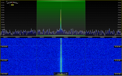

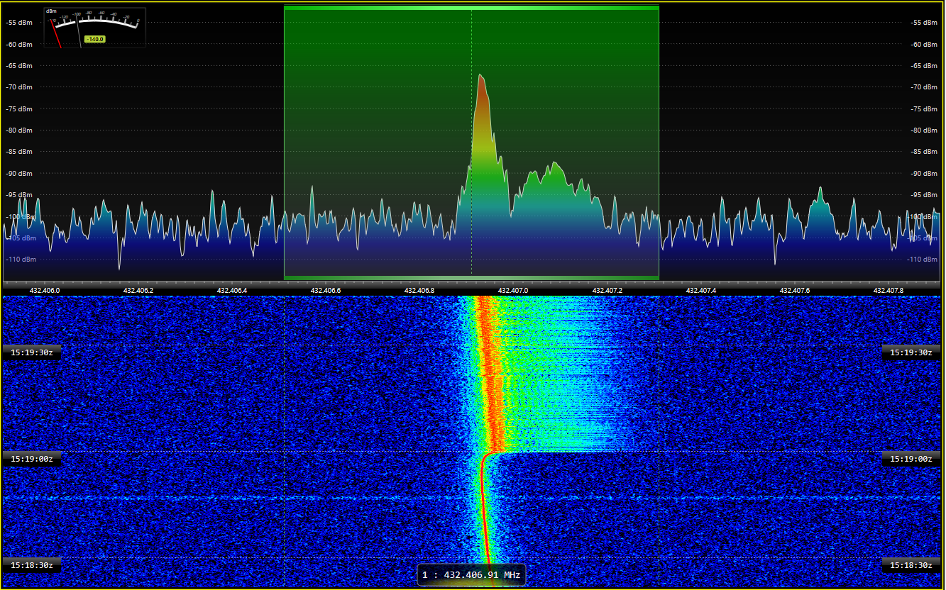

I used SDRC to display the signal used as stimuli where I used both a On The Air signal as well as a HP8665B signal generator with the low phase noise option and locked to a high quality ovenized 10 MHz crystal oscillator. This 10 MHz reference is calibrated to a Rubidium reference. You can in fact clearly see the difference between the different SDR's using this method.
As I mentioned above, the Pluto clone show extreme frequency instabilities (are temperature related and appears about 30 to 60 seconds after turning the unit on) as can be seen in the attached screenshots (HP8665B_432_407_MHz_Pluto and HP8665B_1296_407_MHz_Pluto). In the screenshot you can see some thermal drift after turn-on and then after about 30 seconds it just bursts into a wild jitter. I do not know the reason for sure, but it looks like a bad reference oscillator.
The LIME SDR USB is extremely frequency stable both on 432 and 1296 MHz. On 432 MHz the frequency drift from turn-on until it has stabilized is in the order of a few Hz. The frequency jitter is very low and it exhibits a very clean note when listened to. Very pleasant. See attached screenshot HP8665B_1296_407_MHz_Lime_USB.
The RX-888 shows, as reported in the first posting, an initial drift after turn-on in room ambient to thermal equilibrium of about 3.4 ppm. On top of that is has an frequency jitter that can clearly be seen on the screenshots. It does not have a clean note when listened to via SDRC. Irritating already on 432 MHz and even worse on 1296 MHz. I can not recommend the RX-888 for any serious UHF HAM usage. It would work with FM but is not acceptable for CW or SSB. I have not noticed any disadvantages at VLF, LF, MF nor HF frequencies. The reason for the thermal frequency drift as well as the frequency jitter is likely to be the reference oscillator. The jitter could also origin from a phase locked loop that does not work as it should.

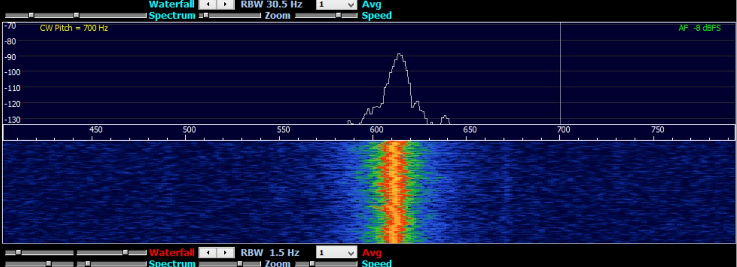

As a complement to the screenshots I made two audio recordings of a local 432 MHz beacon using RX-888 and LIME SDR USB feeding SDRC.
The LIME SDR USB recording is labeled 13-Oct-2020 21h22m46s, 432.435.885 MHz, CW-L
The RX-888 recording is labeled 13-Oct-2020 21h27m43s, 432.436.161 MHz, CW-L
Both are mp3-files each about 40 seconds long.
I hope this illustrates some of the difference in the note cleanness between the two.
