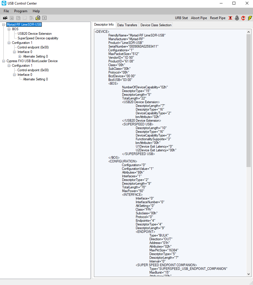

Cypress Control Center finds the RX-888 at first but it disappears there as well after the SDRC crashes. See attached screenshot. Cypress Control Center also finds the LIME and that maybe can be used as a comparison.

Regarding connecting to to the CYUSB3014 I get the impression that it can be done via the Cypress USB Control Center (screenshots in posts above). However, I do not have the knowledge to use it in that way.
Do you know how to do that? If so, I am open to instructions on how to proceed.
