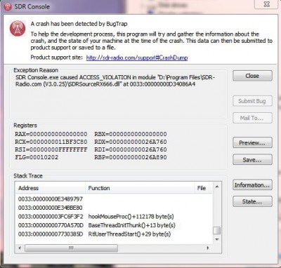

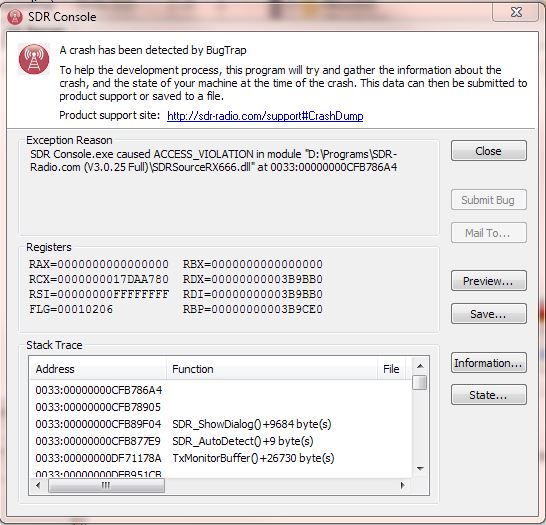

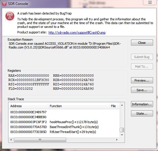

I received an RX888 yesterday and hit a problem with SDRC in that it crashes when initially searching for the radio at the "Select Radio - Definitions" stage; this is on my main PC (AMD R9 3900X / 32GB / RTX2070) under Win7x64. However, the radio runs perfectly on this PC under HDSDR and SDR Sharper using ExtIO 0.4. The radio also works in SDRC on two laptops running Win10, but when I tried it on a third laptop running Win7x64, SDRC crashed again with the same symptoms as per the main PC. On both Win7 computers a system message appeared as SDRC crashed saying "USB Hub Power Exceeded" - I think this is false, as the RX888 was measured drawing only 0.56A running 32MHz on the Win10 laptops, well within the USB3 port capabilities.
Screenshots are attached of the two SDRC error messages, but the dump files are too big to be attached, apparently, as this is my first message in the forums.
