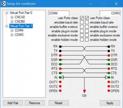

Posts: 808
Re: Adding COM ports with COM0COM
When you define a com port pair such as COM3 x COM4 make sure the "Use Ports class" check box is checked for both ports.

Yes, I have "use Ports class" for both ports and still the ports are listed in Device Manager on their own line and not under Ports.
I have watched this video- Creating virtual COM ports with com0com and it shows the virtual ports under te Device Manager Ports and not on their own com0com line so I think that's the problem. It could be something else.
jdow, how did you copy and paste the com0com screen? I tried the snaipping tool and it doesn't paste to these forum posts.

Posts: 808
Alt print screen followed by paint followed by attaching the file.
