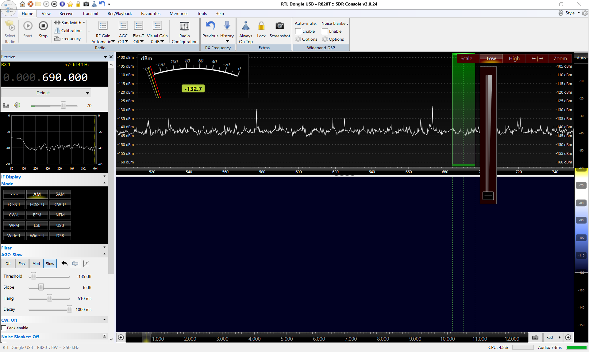

please have look at this picture...

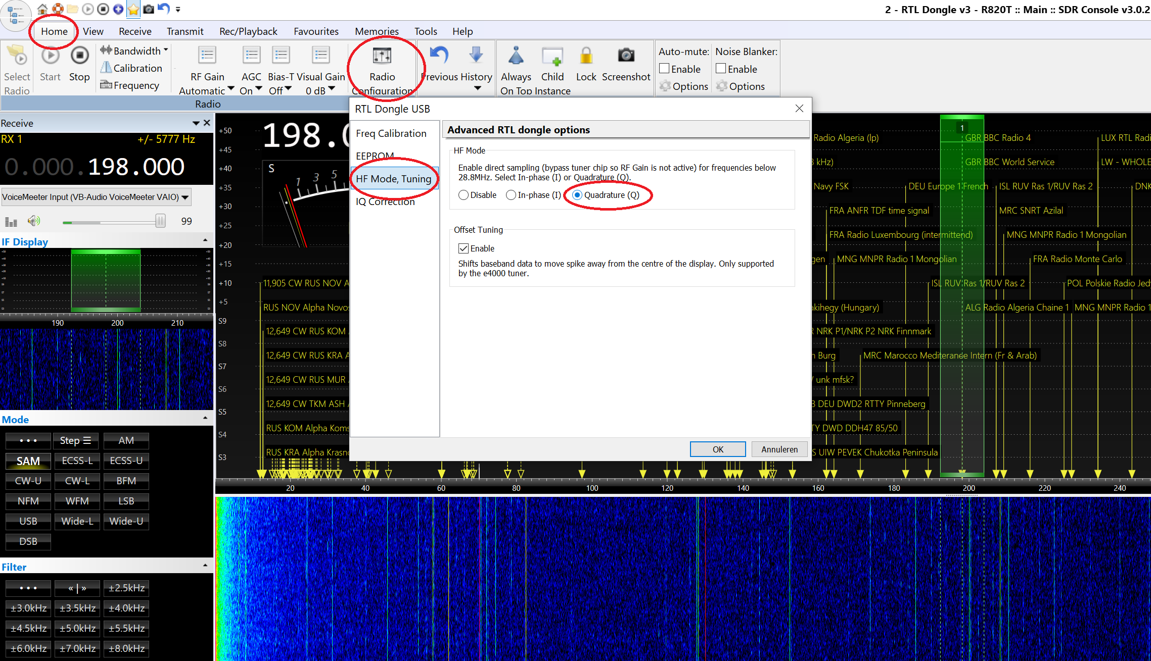

for HF reception you should choose for Quadrature.

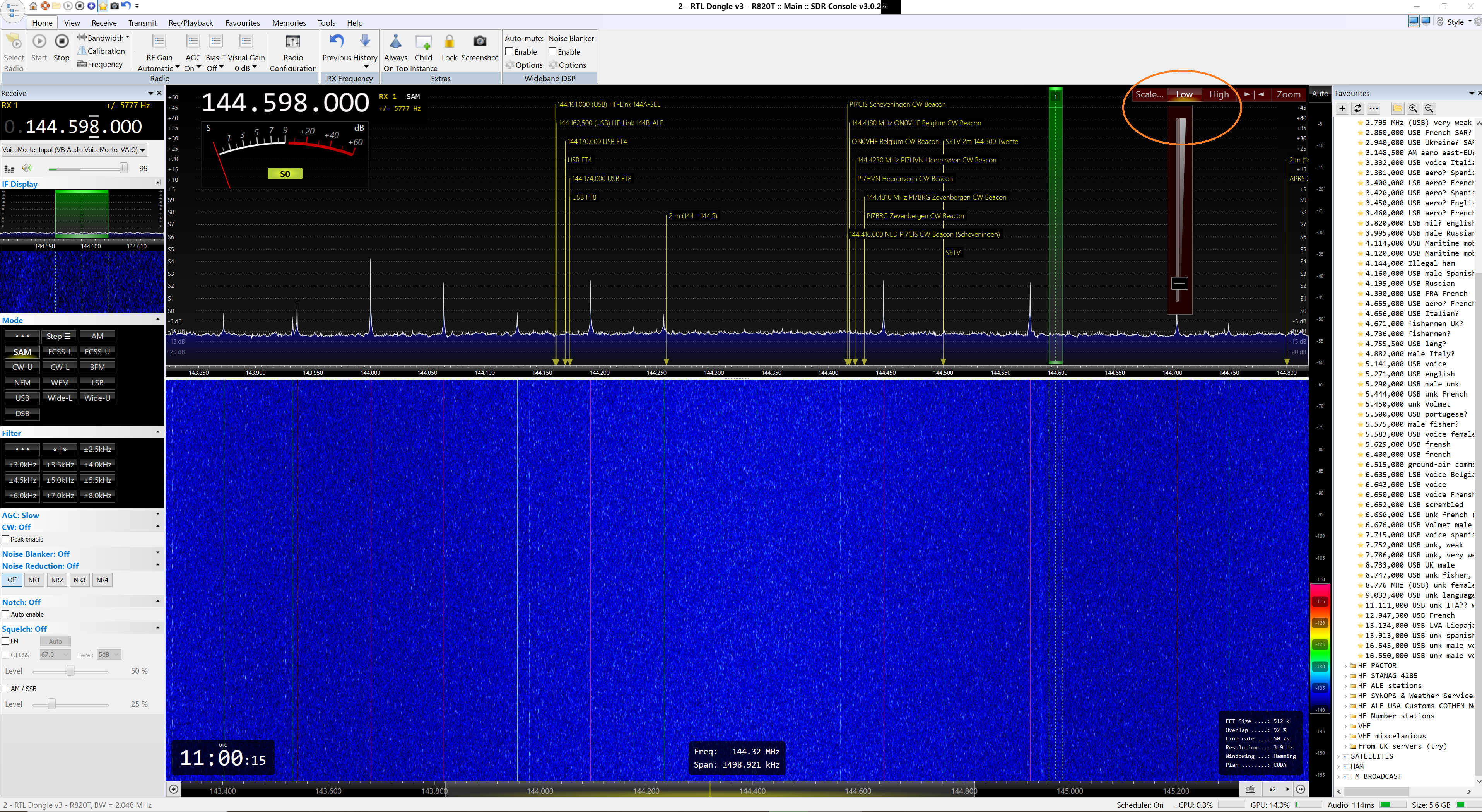

btw are you aware of these sliders? (hoover over them with your mouse)
(i don't have a antenna connected hense the spikes)

I have set the Quadrature in HF mode tuning but still, I can not receive any channel and I am hearing only noise.

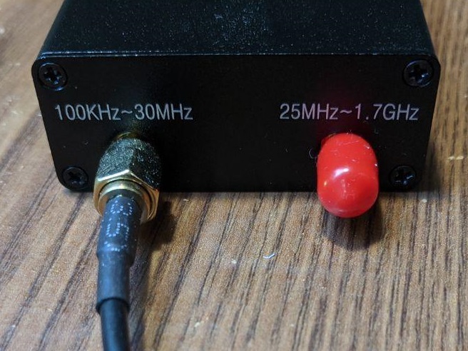

Maybe a stupid question, did you connect the antenna to the HF port? otherwise i don't understand why you don't receive something on HF.

that's the correct port, please look at the connector....it has to be a MALE connector.
You will not be the first person who uses a cable with a female connector....

Yes exactly, It is Male connector.
