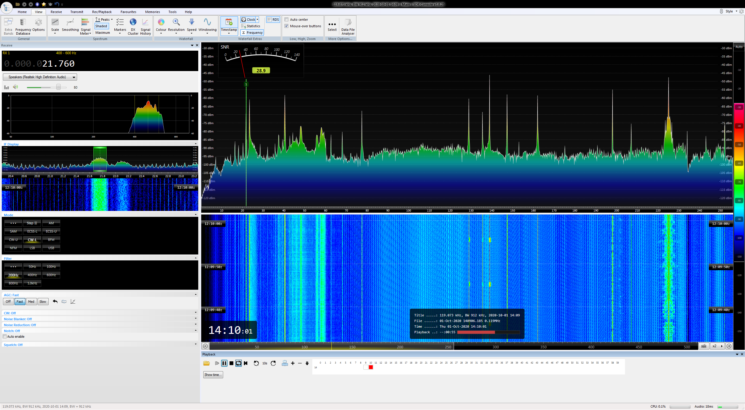

01-Oct-2020 140906.185 0.119MHz, AirSpy HF+ Discovery (Screenshot-2020-10-02-211002.png)

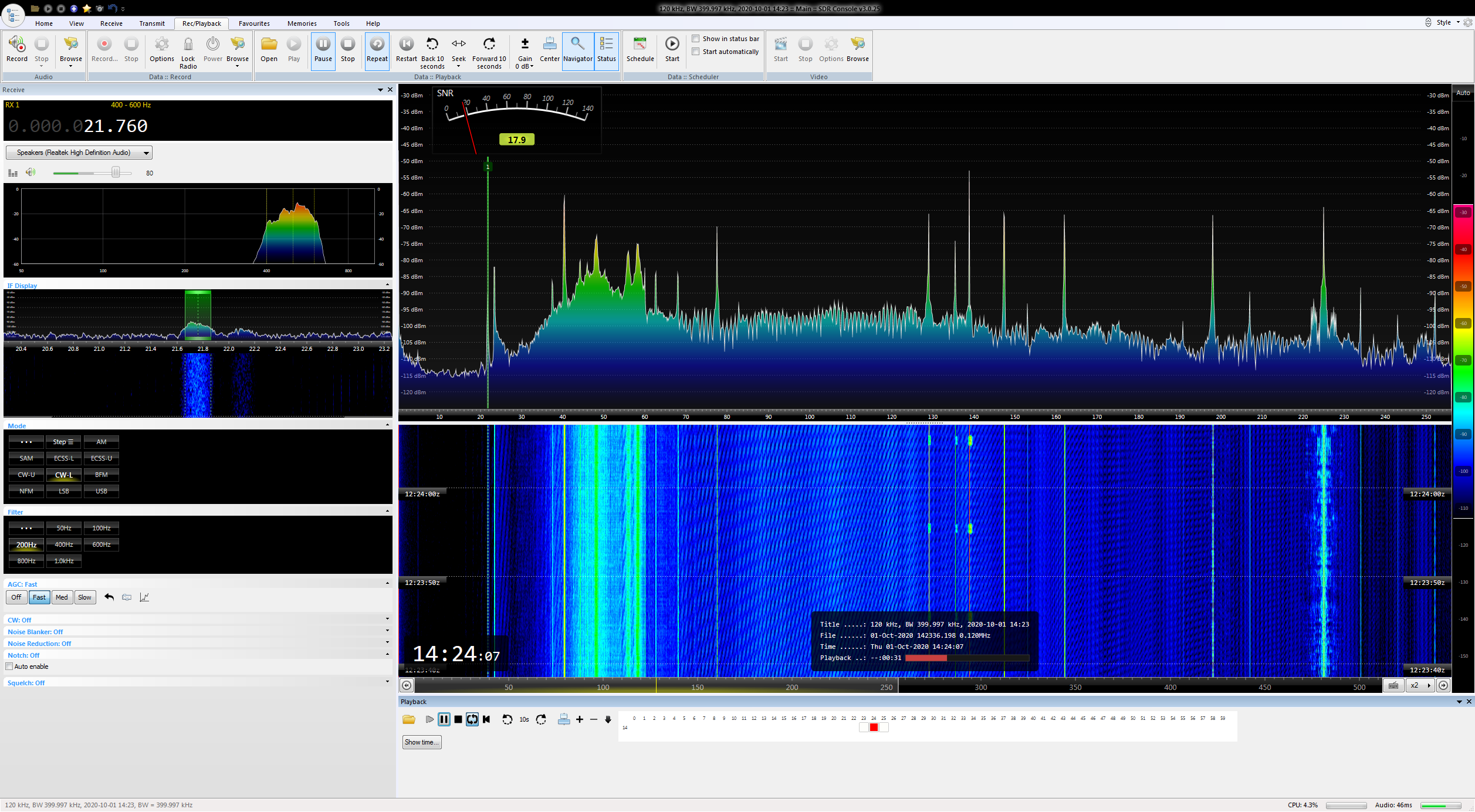

01-Oct-2020 141347.908 0.119MHz, AirSpy HF+ (2 connector) (Screenshot-2020-10-02-211258.png)

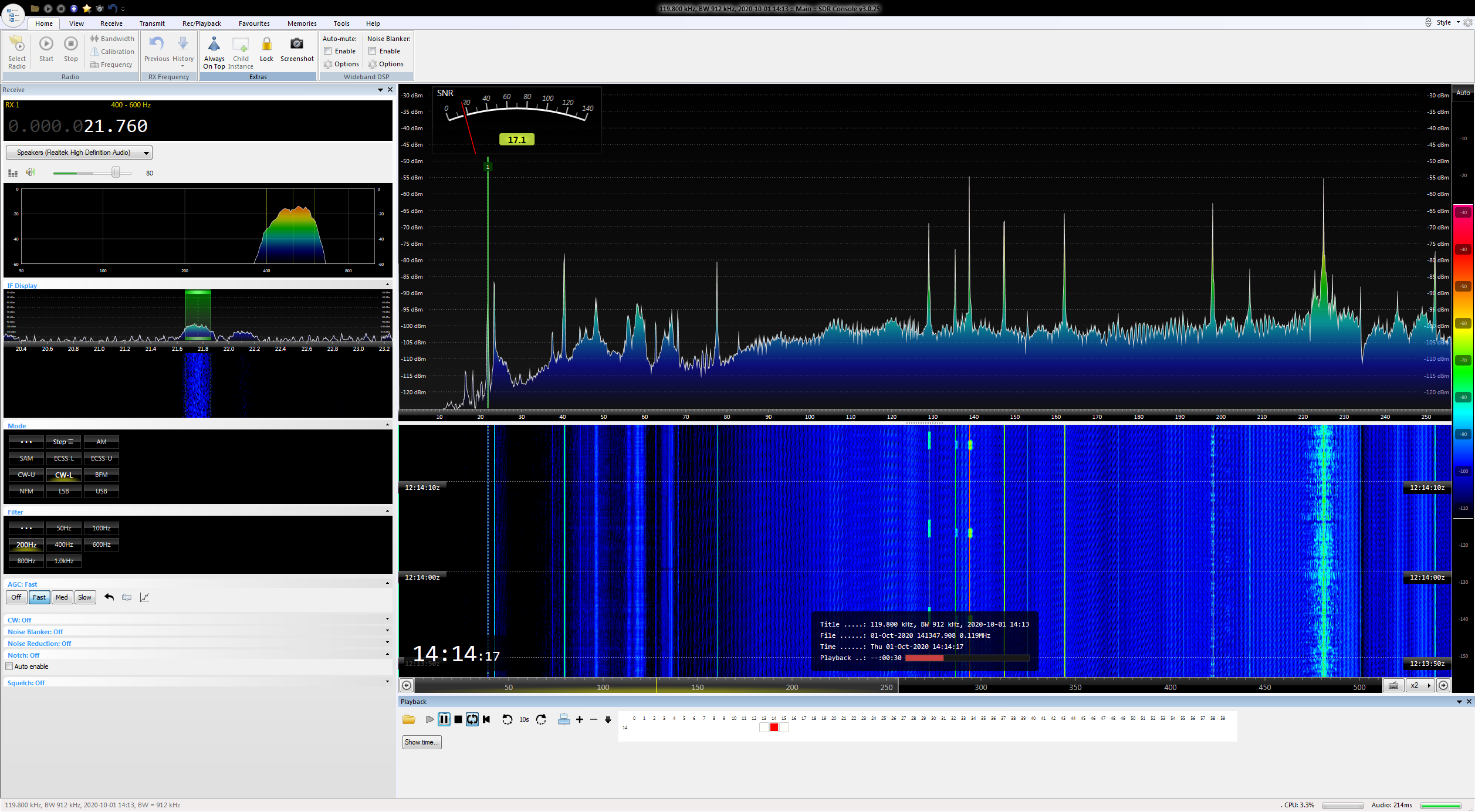

01-Oct-2020 141837.636 0.125MHz, RX-888 (Screenshot-2020-10-02-211351.png)

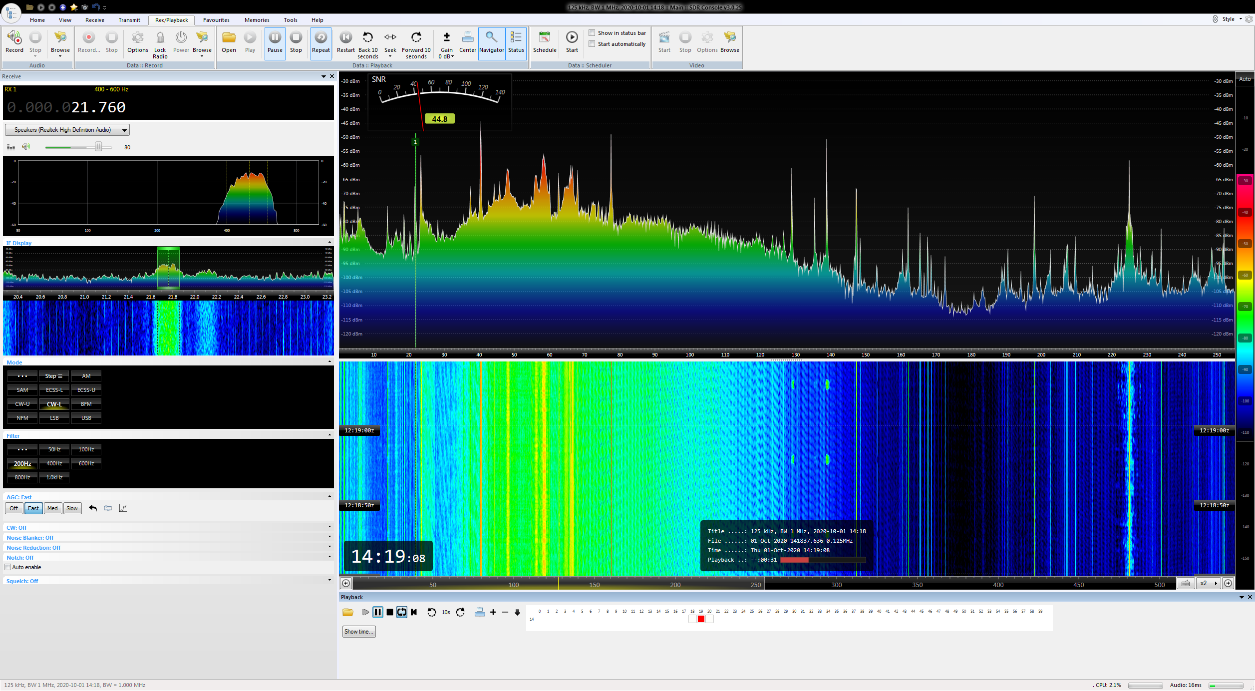

01-Oct-2020 142336.198 0.120MHz, AFEDRI Net (Screenshot-2020-10-02-211439.png)
You can clearly see that the AirSpy HF+ (2 connector) roles off below 40 kHz while the AirSpy HF+ Discovery holds all the way down to below 20 kHz.
You can also see that the RX-888 has a big hump at 40 to 120 kHz that is not as pronounced at the other SDR's. It also has a dip at about 180 kHz that you do not see on the other SDR's.
Interesting. I do not know how to interpret it.

looking at al 4 pictures i can only conclude that your antenna is hardly suitable for the VLF frequencies.
Shouldn't the LW BC stations not be more stronger, even in Sweden? What is your antenna?
Noise at 180Kc seems to be slightly lower, i see this too with a RSP2 here in the NL. 73, PD3LK

As I write in the first posting, the antenna is a 135m BOG directed in zero degrees (due North).
There is a certain amount of F/B-ratio so the Eu LW stations are somewhat discriminated.
I have heard NPN, Pearl Harbor, HI on 21.4 kHz using it, so it probably works quite OK in it's forward direction.
The dip in noise is visible on all SDR's and that made me curious. And the spectrum look so different on the different SDR's with the same antenna.

Great test, it would be nice to see the radio gain settings for each of the devices under test.
It looks like the gain is set too high on the Afedri, on mine I need to set the RF gain to 23 or 26.
It is very sensitive, so the gain must be lowered (at least with my antenna).

I played with the AFEDRI gain before making the recording and tried to get about the same signal strength reading on DCF77 on 77.5 kHz on all SDR's.
I can't recall exactly where I ended up with the AFEDRI gain but around 11 I guess. That should be good and I did not see any major differences when increasing the gain a few steps (enough margin). A gain setting of 11 is fine during night time in the MW band with all the big signals, and this was during day time.
