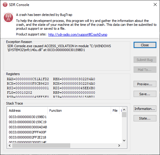

My name is Akira JA1OGZ. The SDR Console is very useful in receiving satellite telemetry. It works fine on other PCs.
It is a symptom that is occurring on the PC I am using now, but within a few minutes after starting up, it will enter Trap as shown in the screen below.
Please tell me how to avoid it.
PC:WIN 10, SDR Console 3.026 64bit.
Thank you very much.

CRASH ACCESS_VIOLATION

Hi Akira,
mfc140u-dll is used by several programs, some program's install older versions and overwriting newer ones.
Try downloading and installing the latest version: https://wikidll.com/microsoft/mfc140u-dll
The file has to be copied to C:Windows\System32 regards, Leon

Re: CRASH ACCESS_VIOLATION
Thank you for your support.
There seem to be many problems with my PC.
Once I Uninstall the SDR console, I deleted the following folders using the Windows registry editor HKEY_CURRENT_USER \ Software \ SDR-RADIO.com.
It was overnight, but it worked continuously. So far, I got into Crash Dump in 2-3 minutes, so I think it has improved.
Also, FM Squelch now works properly.
For a long time, I think that a lot of garbage with various settings changed remained. I plan to use it for a while.
Hi, maybe there are more files from the C++ redistributable corrupt or overwritten..?
Try reinstalling them all. Info is to be found here: https://www.sdr-radio.com/CppRedistributables
Thanks Leon-san.
I didn't pay attention to the notes. Thank you!!
