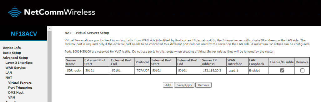

I would like to operate my SDR from the comfort of my armchair using a second laptop computer and thought I could use the remote server feature for this. I tried the streaming option but I'd like to do bandscans on multiple bands and streaming didn't allow this.
I've gone through the setup procedure for the server but I found that when searching for my radio on SDRSpace.com, it is listed but there is a yellow warning triangle next to it and not the green tick. I also discovered there is a red icon listed in the Server Manager setup under "On Air".
I assume this is most likely a port forwarding problem. I used a several online services to check my port 50101 but it's still showing as closed. I have a NetComm NF18ACV wireless modem, and another wireless router attached to this for improved coverage around the house. Rather than tackle port forwarding in both units, I've initially set up the port forwarding on the wireless modem only and initially just using this to connect my "remote" radio and my armchair laptop to. I assume the attached additional wireless router wouldn't cause any issues here.
Attached is a screenshot from my wireless modem port forward window with my local address in. I've also tried my online IP address in there but I'm not getting very far and would like to ask for some help with this please.

I had a good step by step with photos on how to do it properly, but the images are now gone. Only the text is there:
https://sdr-radio.groups.io/g/main/message/51472
But I did find this:
https://sdr-radio.groups.io/g/main/file ... Guide2.pdf
Getting ports open and forwarding to the proper PC with a static IP set is important! My ports show 'Open' with my server PC's up and running.
73 Kriss KA1GJU

Hi Kriss,
I must give you a big thank you for the step by step guide. Even without the images it was still very helpful. I pretty much started from the beginning and went through your guide really carefully and finally managed to get it going! I'm not sure what I did wrong earlier although this time around I also tried port forwarding 50199 as well as 50101. I also reset my account names... I possibly had too different names set up there too rather than identical accounts.
Unfortunately although it's working it is not giving me a consistent level of data and buffers considerably, to the point where I can't use it. My partner has had Netflix going all day as well as my daughter playing Minecraft and using Messenger video so I suspect there's some serious data hogging going on there. I've been looking at the Quality of Service settings in my router today and there will have to be some major throttling back of data with preference given to my SDR connection! So I've spent a few hours playing around with that while trying not to disrupt the family's internet enjoyment too much. I'm sure that's only going to be a minor setback and I should have it working properly pretty soon.
