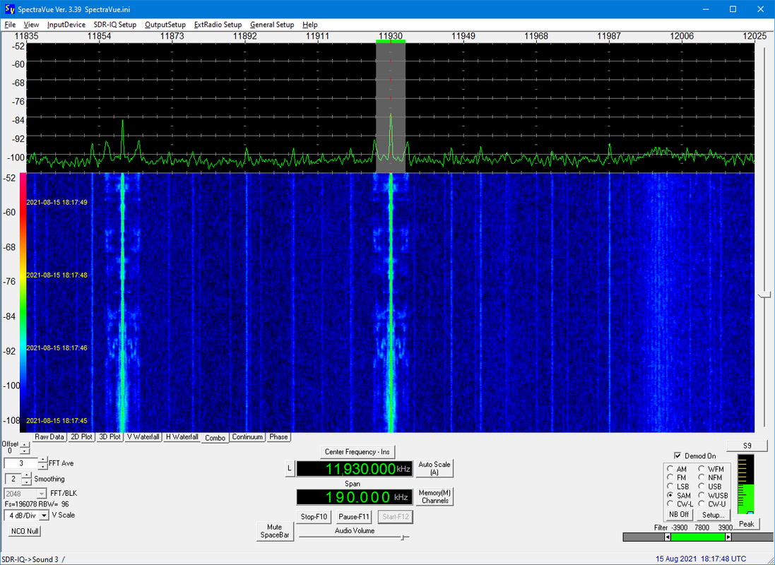

Here is the radio playing under SpectraVue:

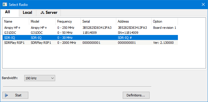

In SDR Console I am able to successfully add the radio. The software does see the radio and allows me to add it.
However, and this might be a clue, a serial number is not shown. I cannot recall if it did show the serial number when it was working before or not.
When I select the SDR-IQ from the dialog, SDR Console does nothing. I do not get an error. Trying the START button results in the hourglass showing for a second or two, then it goes away. It's pretty much like the SDR-IQ is a phantom radio, not doing anything but haunting me with its presence.

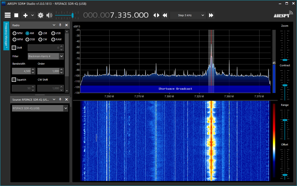

SDR# Works:

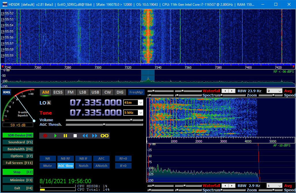

HDSRD Works:

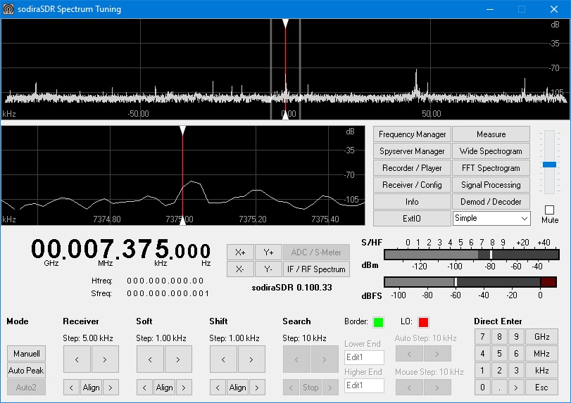

sodiraSDR Works:
