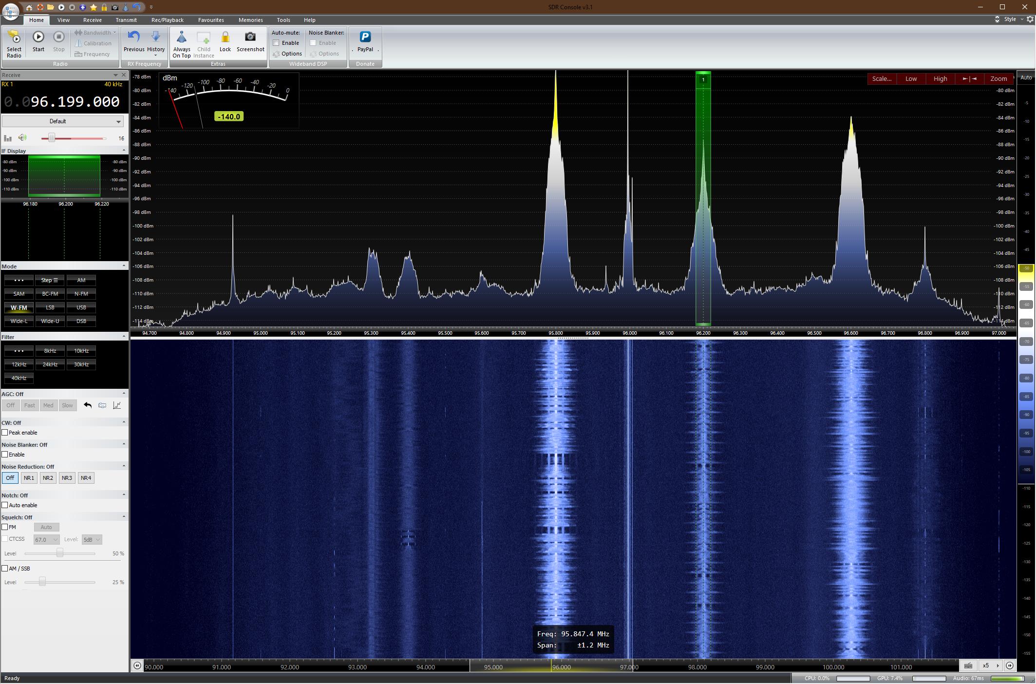

attached you can find the log and the screenshot.
Just to make sure that there is no misunderstanding --> sdr console does work (if i replace the libusb) but the gui performance is unbelievable bad.
