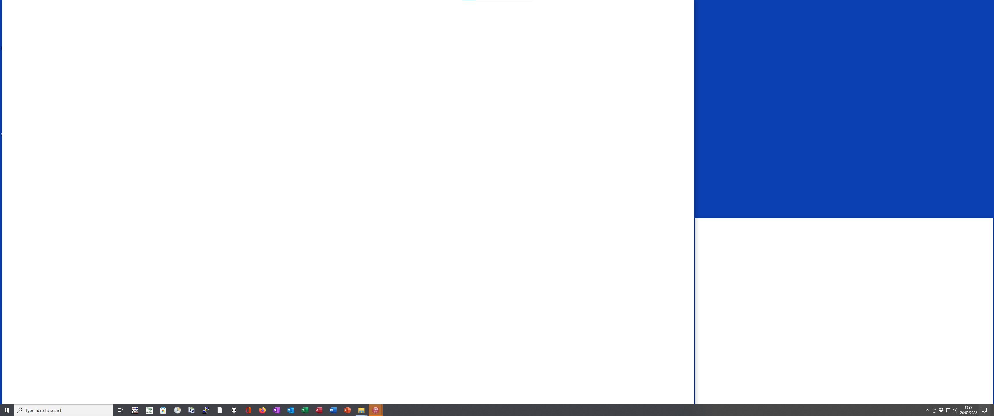

I know Simon loves a screenshot so have included what I can once all resources have been exhausted

The new kit still failed when I initially ran it with my then current settings. Whilst SDR-Radio appeared to keep procesing and memory management was much better, after 35 minutes I could not start any other resource to allow me to investigate what was going on. Disk activity was non-existent so SDR-Radio was processor bound (at about 92%).
When I could not run Firefox I stopped SDR-Radio (which the system did), but I started to get the odd graphics related error.
Only way to get the machine back to normal was a cold boot (but not an Executive reset).
