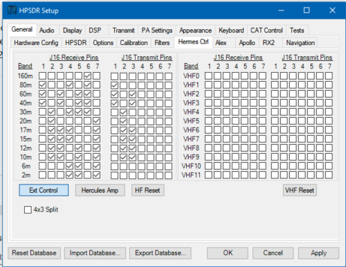

I have a Hermes Lite 2 by EU1SW. I have a screenshot of the settings in PowerSDR, how to set it correctly in SDR Console?

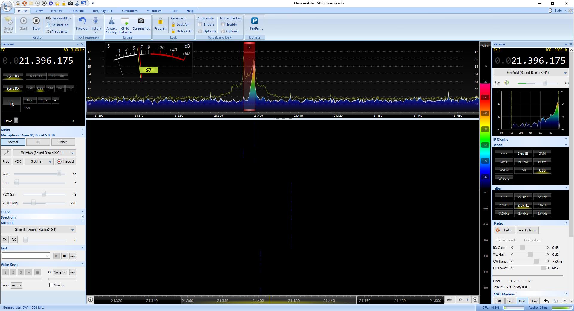

Can you please attach a full screenshot of SDRC when it is in this problem condition? Select the "Home" tab in the ribbon bar. Show both RX DSP and TX DSP panels and do not crop or edit the shot.

scalak
Posts: 9
Joined: Wed Oct 19, 2022 12:48 pm
Re: Settings: PowerSDR -> SDR Console
#6
Unread post by scalak »

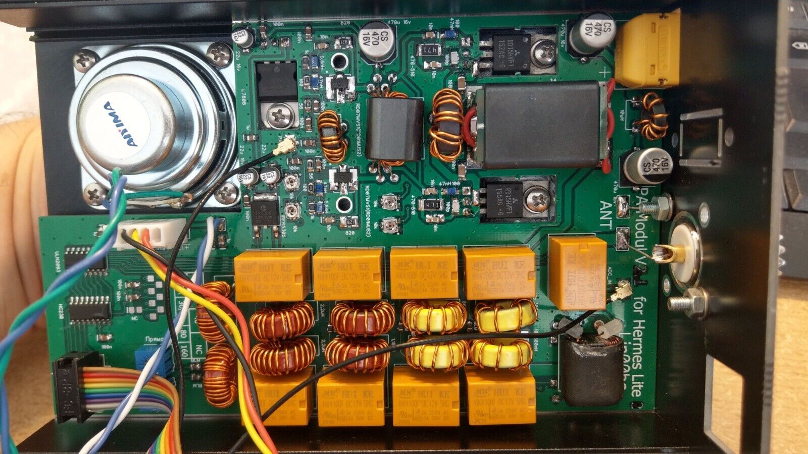

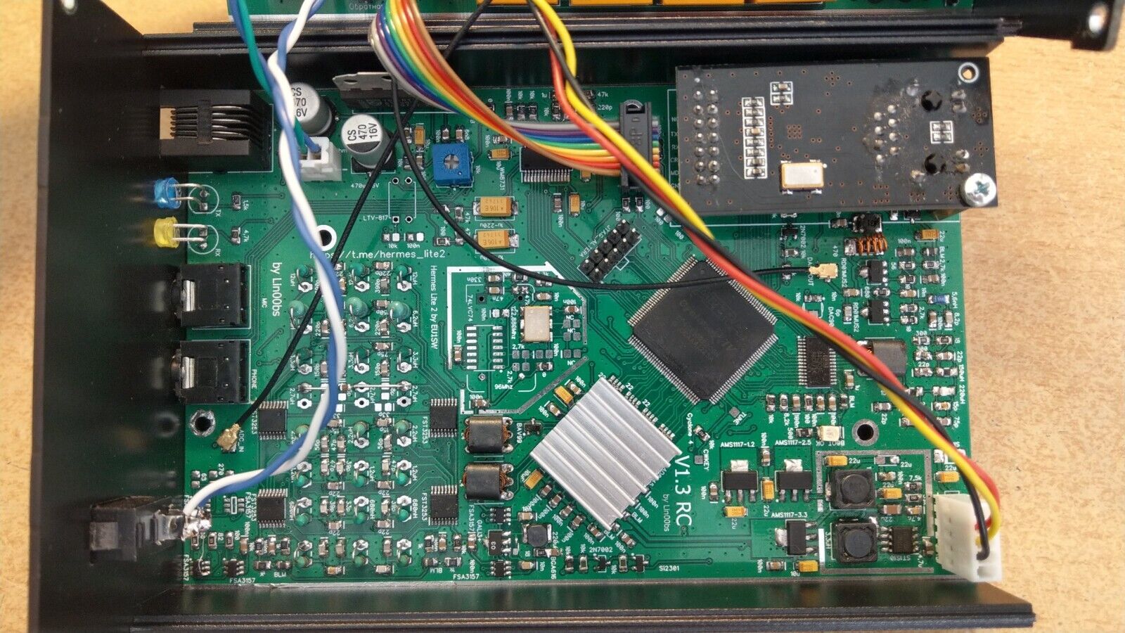

My version is different from MakerFabs, I am attaching photos. As I mentioned in PowerSDR everything works fine. When I'm at home I'll take a screenshot.
As I mentioned the auto mute mic during the RX would solve my problem.

scalak wrote: Sat Oct 22, 2022 4:41 pm My version is different from MakerFabs, I am attaching photos. As I mentioned in PowerSDR everything works fine. When I'm at home I'll take a screenshot.
So to be clear, when you mute the mic this problem goes away, so with the mic muted you do not see the spurious signal?
That makes no sense to me unless perhaos an audio input to the TX audio in is generating a spurious signal inside the HL2 hardware even when in receive? I can say for sure that this is not the normal behaviour of a normal HL2.
Also I can see that there seems to be a speaker in the PA unit. Does this version of the HL2 incorporate features from the HL2Plus (the version with built-in speaker and mic socket on the HL2 unit)?
Also. gateware shows 32.6 but for the normal HL2, gateware is version 73.2? I guess this means that EU1SW has written custom firmware for his version?

This version has a built-in loudspeaker, headphone and microphone input. In PowerSDR these sockets work properly, with SDR Console they do not work. I do not care about the operation of these inputs because I use a sound card from a computer. I'm sure SDR Console doesn't properly support my EU1SW version but for me it's acceptable with auto mute mic.

So after a little research I can see this is not actually the HL2, but a 14bit design that is based on the HL2. I think it started life as a receiver only?
However, unfortunately I have no idea why you are seeing this issue. It still looks to me that with the mic connected or audio at TX mic-in that the HL2 is generating a low level TX signal that is being picked up on the receiver. This does seem like a design flaw to me, but maybe I am misunderstanding how this version works.
