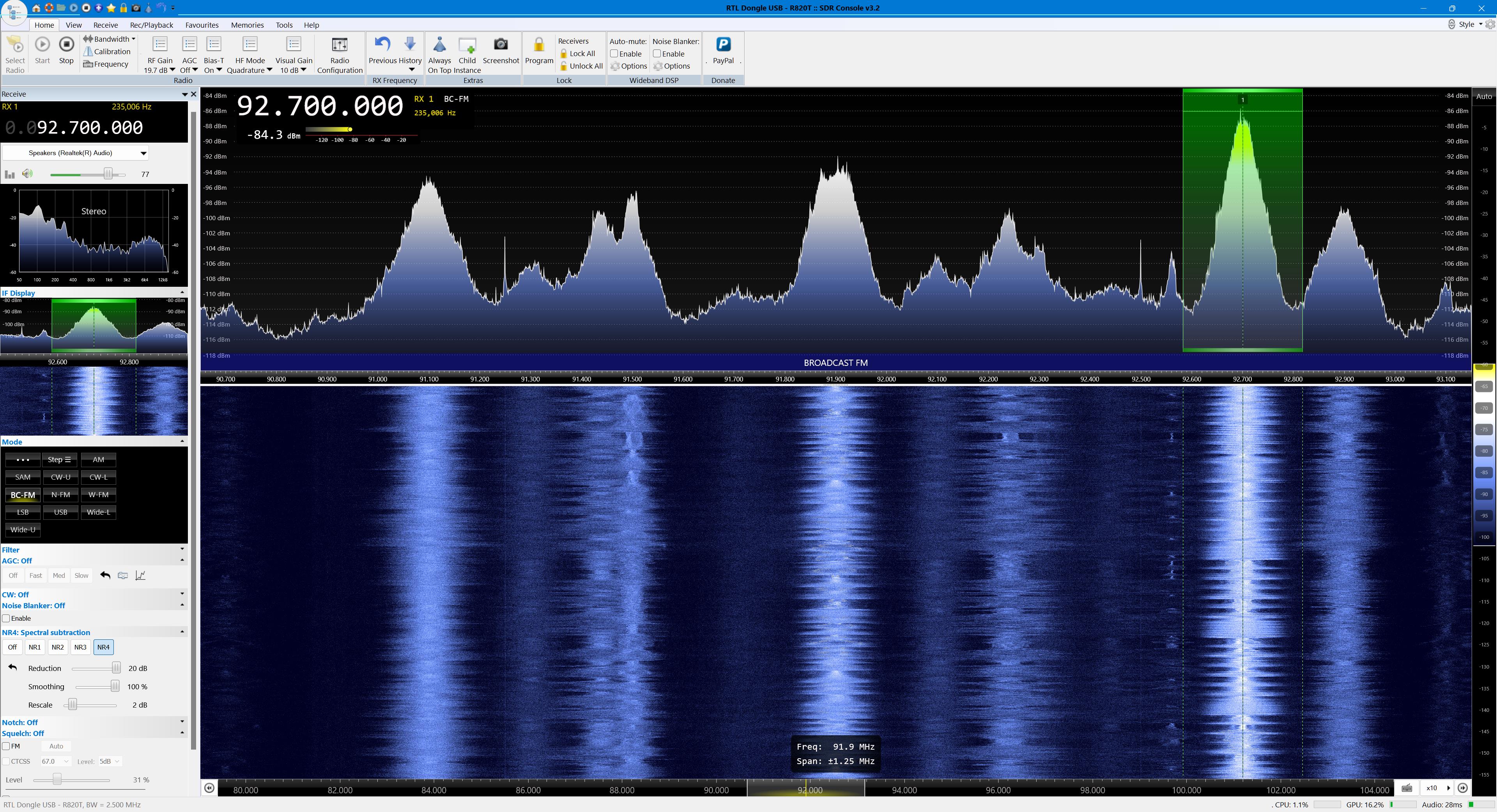

i would like to see just a screenshot so I can clearly see the settings, make sure the ribbon bar, Home panel is visible.
Please make sure you don't have any audio EQ enabled, but I don't see clipping so doubt this is the case.
I see the signal is not super strong, what's it like with a strong signal?

Hi Simon,Simon G4ELI wrote: ↑Fri Nov 04, 2022 2:53 pm i would like to see just a screenshot so I can clearly see the settings, make sure the ribbon bar, Home panel is visible.
First of all, I would like to congratulate you on all your hard work in producing such a fantastic program! Will be donating more funds next week.
The sound seems to be sorted now. I just need to improve on the antenna and then start listening to some other signals, as I'm sure the world is our oyster!
''Please make sure you don't have any audio EQ enabled'' Hmm, not sure where to find that setting.
Here is the screenshot in case something is a miss.
Cheers!
John. VK4JRH

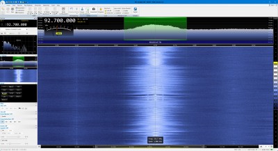

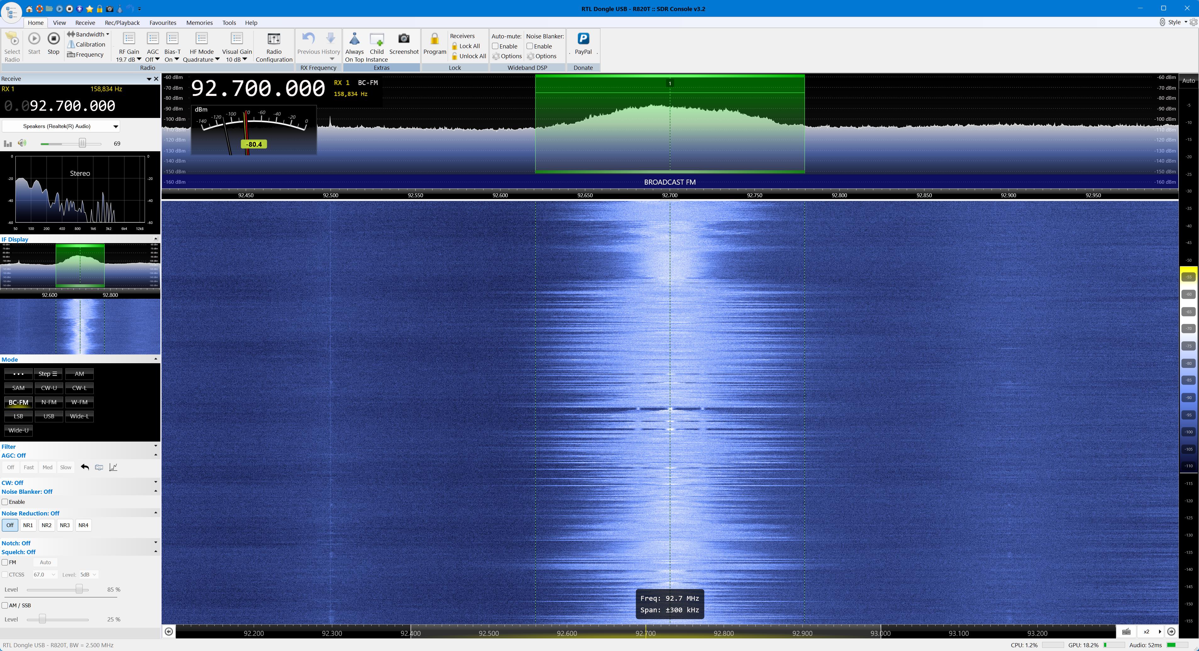

Hi Simon,Simon G4ELI wrote: ↑Sat Nov 05, 2022 6:06 am Hi John,
Depending on the dongle 2.5 MHz is just too much. get a decent antenna and you'll see the RDS text. I also suggest zooming to the max to see more stations.
I tried a lower frequency, but I found that I couldn't get the span in the spectrum section, it was cut on the ends. It seems happy at 2.5 Mhz.
Anyways, I've been playing with it and this is the configuration I've come up with.'
John. VK4JRH

Looks better. Now switch on the RDS:AussieLand wrote: ↑Sat Nov 05, 2022 11:22 amHi Simon,Simon G4ELI wrote: ↑Sat Nov 05, 2022 6:06 am Hi John,
Ribbon Bar, Receive, Mode, Broadcast FM, Spectrum. If the signal's strong enough you'll see the data.
