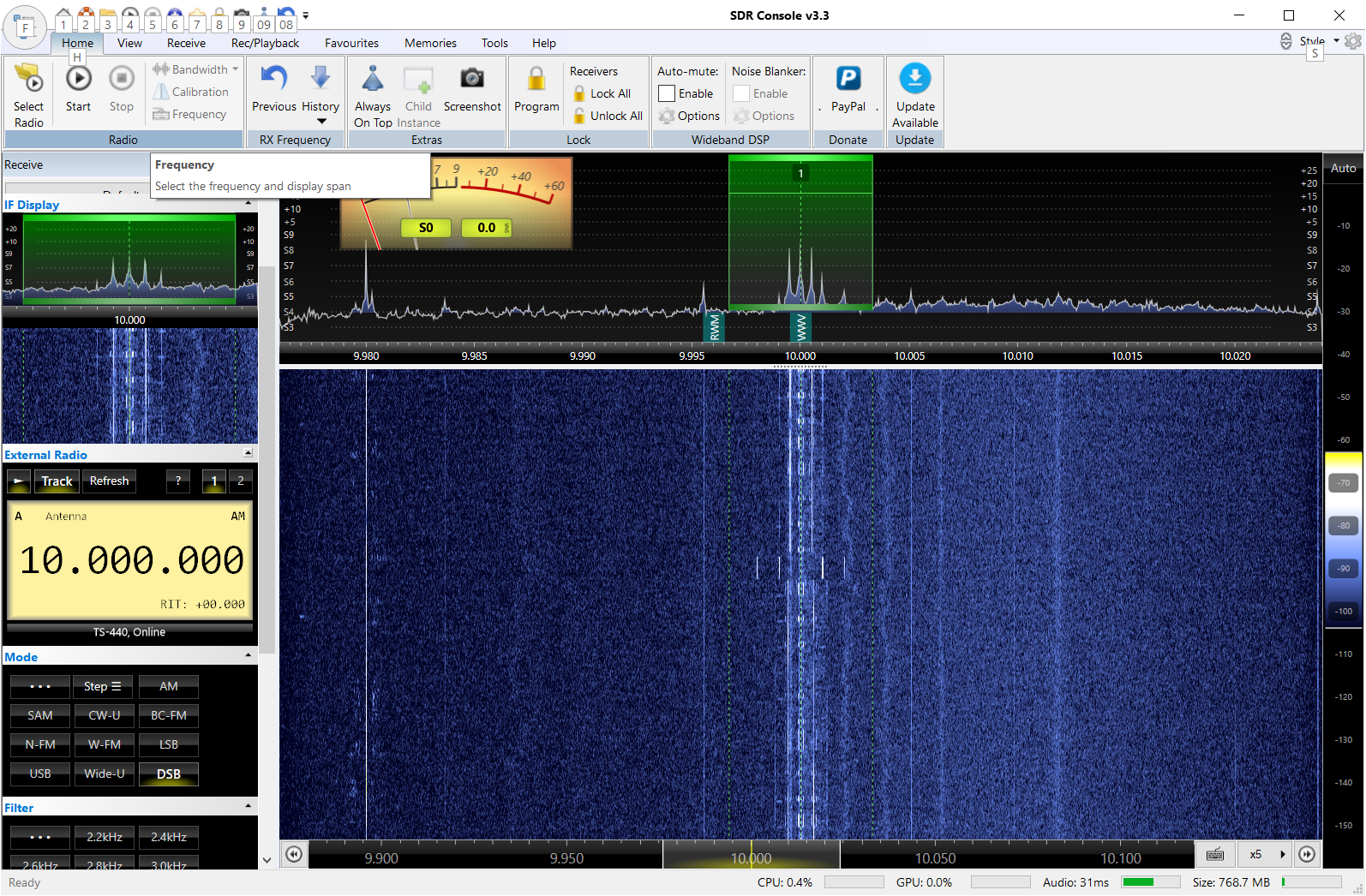

jdow... Do you not see the three pics on the Amazon Photo site with that link? Am I missing a way to upload an image? What I see is the "image" icon, next to the insert URL button, but it seems to only want a http URL, not an actual pic from my PC. That's what happens when I try to load the Amazon Pics link, as an image, for the folder. What do you see if you try that URL I sent earlier? I try it and I see the 3 pics I put there.
When you can see the pics, you see the External Radio window that I'm using, connecting with Ommni-Rig, is emulating a Kenwood TS-440, which is the preferred QDX CAT control set. The RX tuning part seems to work fine, it's the window tuning that seems to be tuning along (in opposite direction) with it, and it shouldn't, that's the problem.

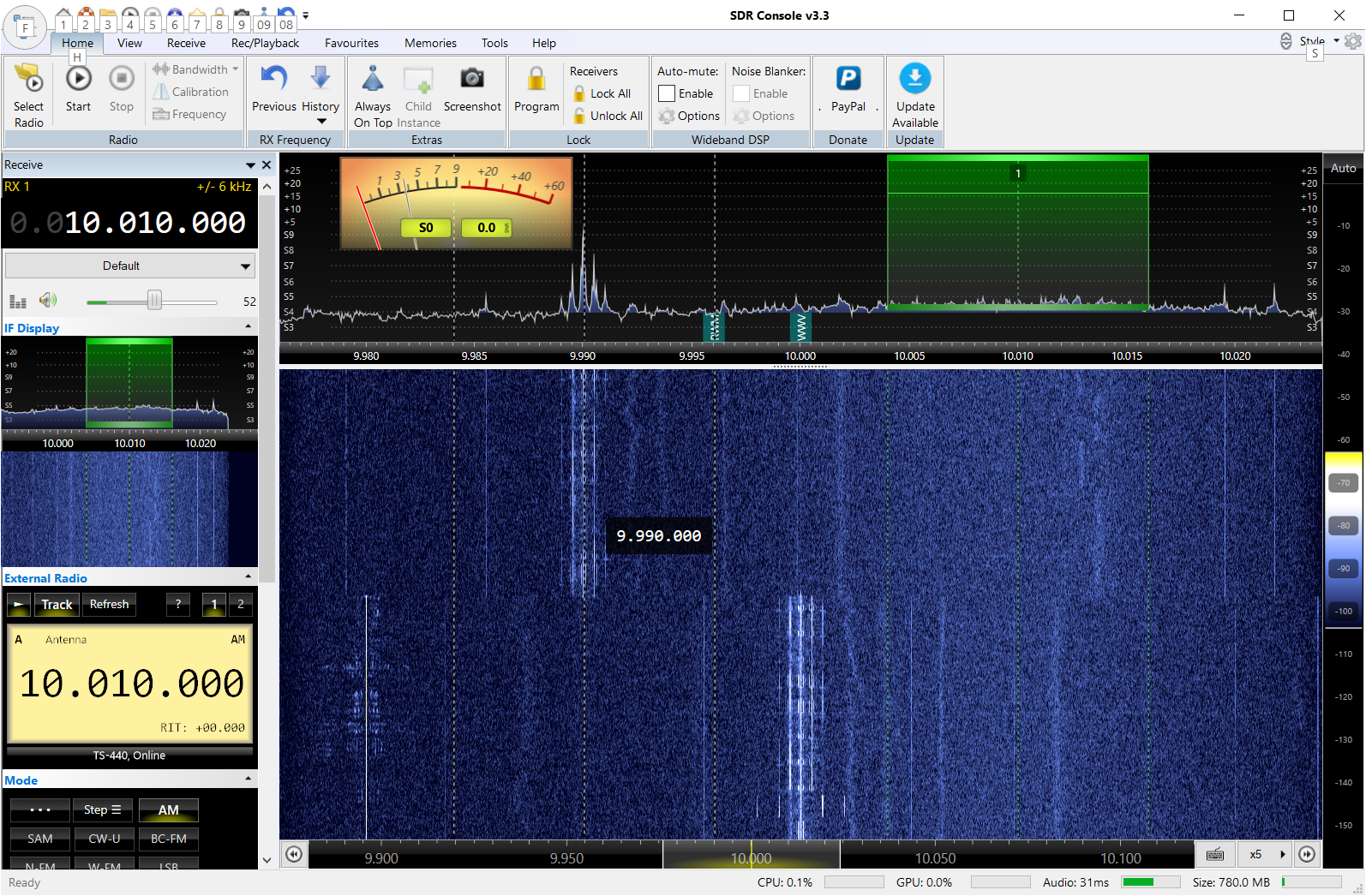

Here's the first pic, WWV on 10.000mhz Waterfall centered on 10.000, RX window tuned to 10.000. Everything fine. Now, here's where I tune up 10khz. RX window now tuned to "10.010Mhz" but you see that the waterfall got tuned/moved in the opposite direction, and WWV is now erroneously appearing on 9.990Mhz. I also let it run for half the screen, you can see the first condition in the bottom half. Here is an attempt to tune on the FT8 digi mode frequency of 14.074Mhz, centered on the frequency. It almost is correct, you see the FT8 stations in that band (14.074 -14.077Mhz) a bit over 1khz up in frequency from where they should be.

Look closely (expand) at the pic where I have the QDX tuned to 10.010 Mhz.
Before this, the starting point was, tuned to WWV, on 10.000 Mhz, and that centered on the waterfall with the >|<.
What you see is:
1. The radio (green bandwidth that is what ends up in your speakers) is tuned to 10.010 Mhz, and has moved up 10 Khz from the center of the screen.
2. The waterfall seems to have moved down 10Khz, with WWV appearing on 9.990 Mhz on the waterfall frequency scale.
3. The waterfall "tuning" bar, at the bottom of the waterfall, is still centered on 10.000 Mhz, despite the waterfall having "moved" down and WWV is no longer in the center of the screen.
Does this fit your description? Simon?
