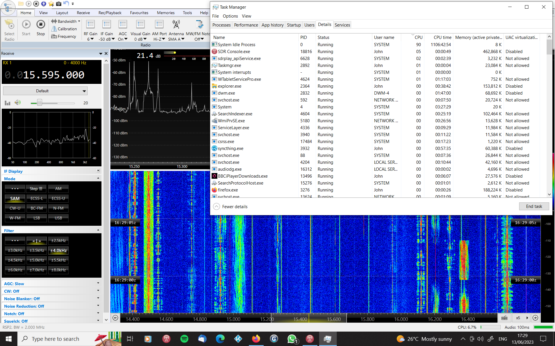

I mean that the panel titled "AGC: Slow" is "unrolled" in the column of controls on the left. See the two screenshots in the reply I sent to jdow.

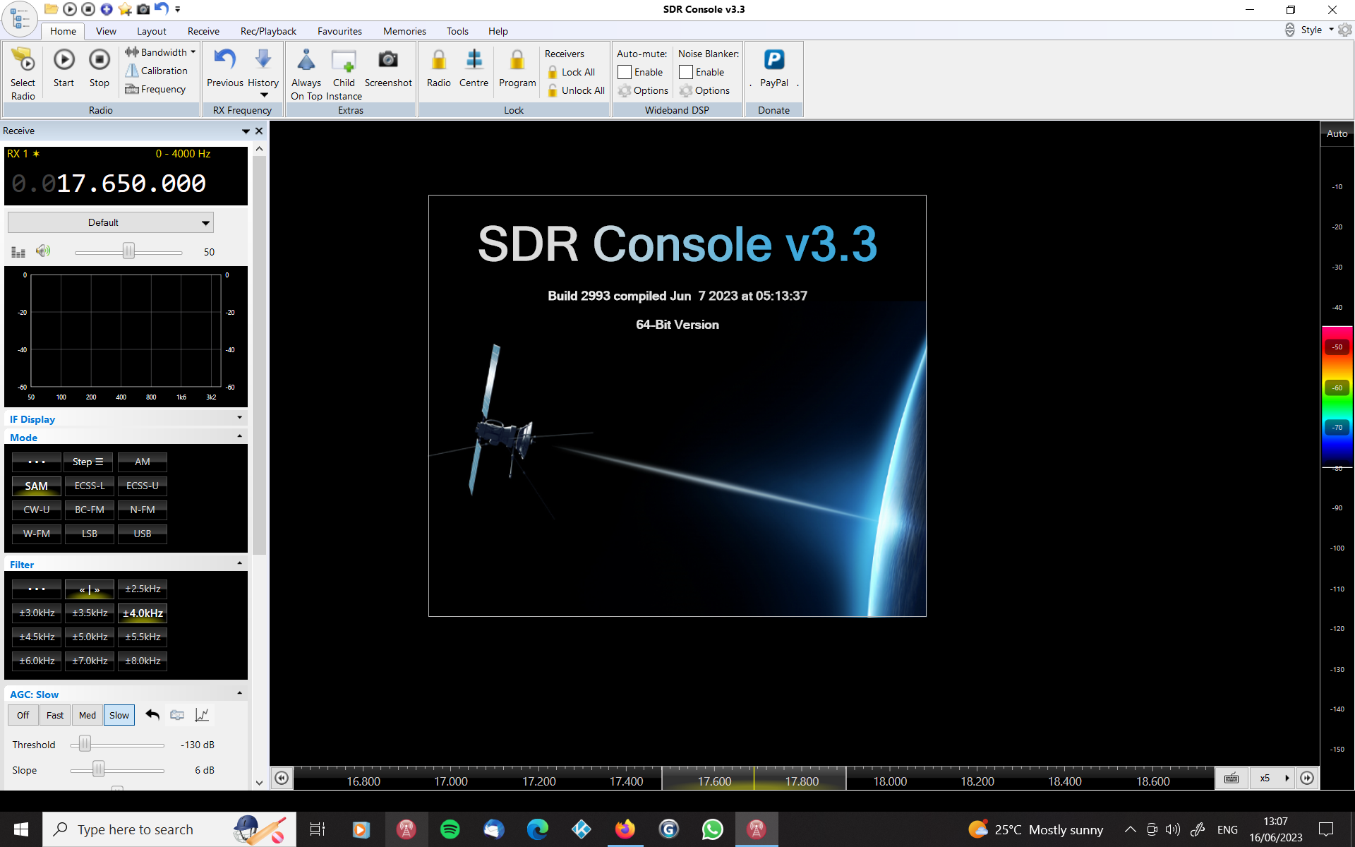

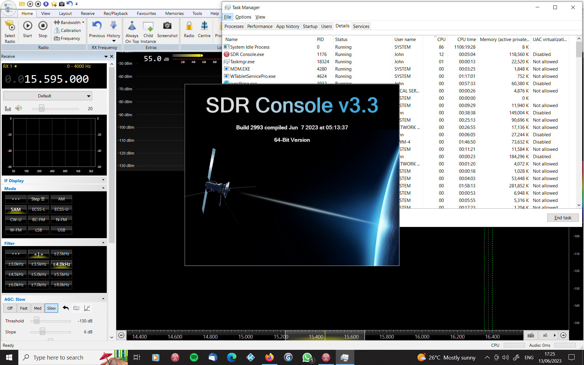

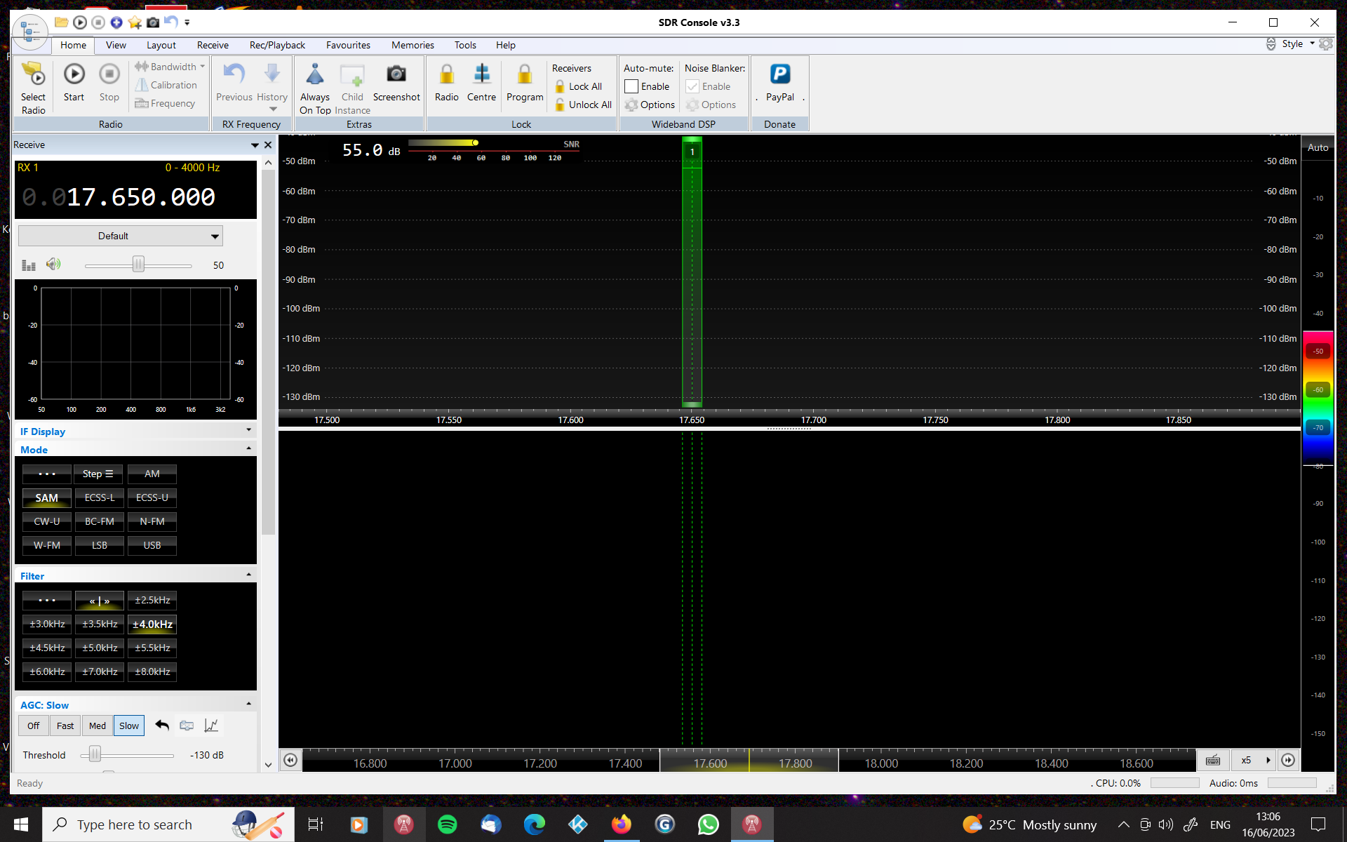

Ah... you're on to something now. I usually have SDRC maximised, so it starts full screen. If I reduce it's size a little (though still leaving some of the AGC panel visible), without changing anything else, and then restart it it starts up cleanly. Compare stuck splash screen...
with normal startup...
