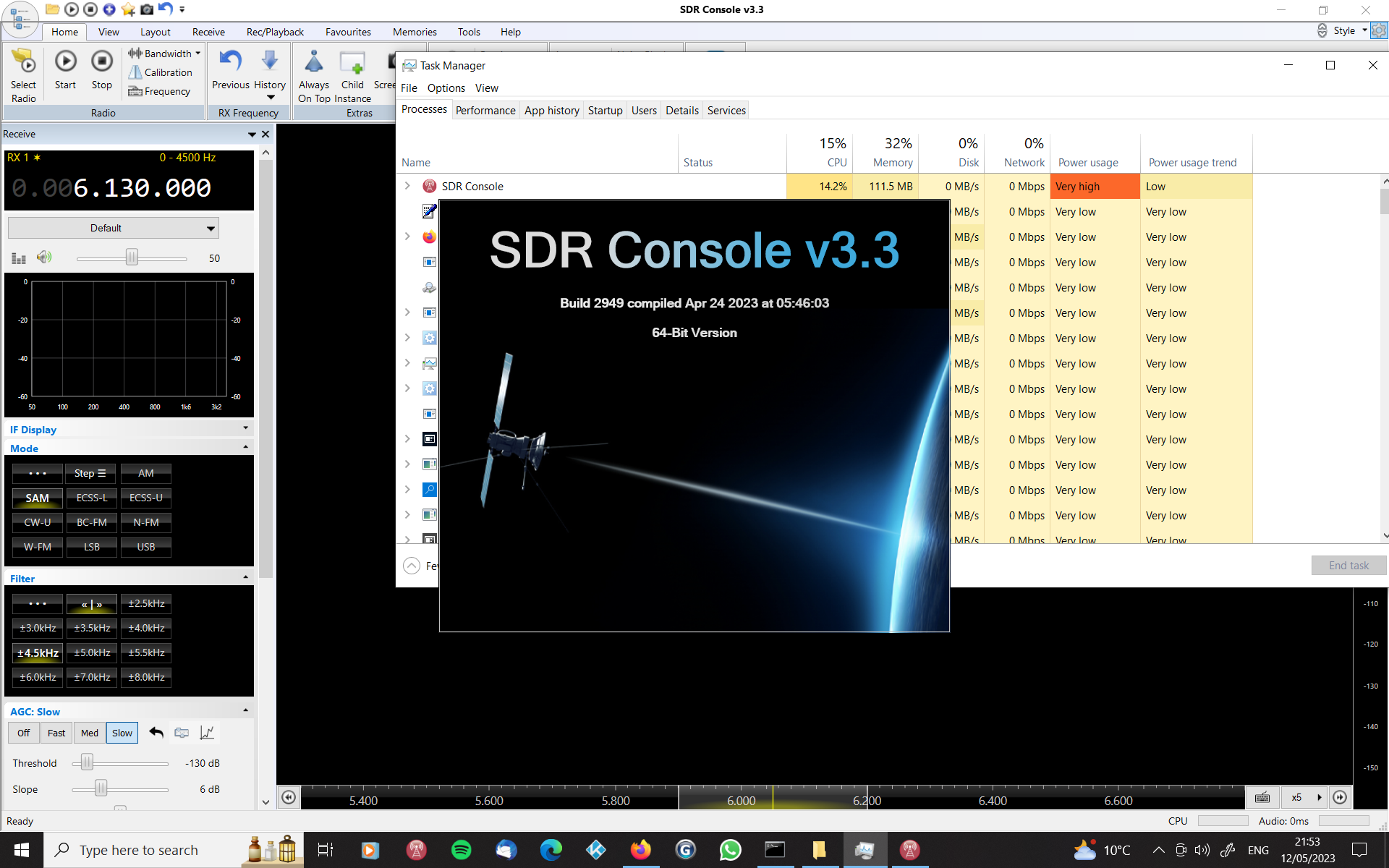

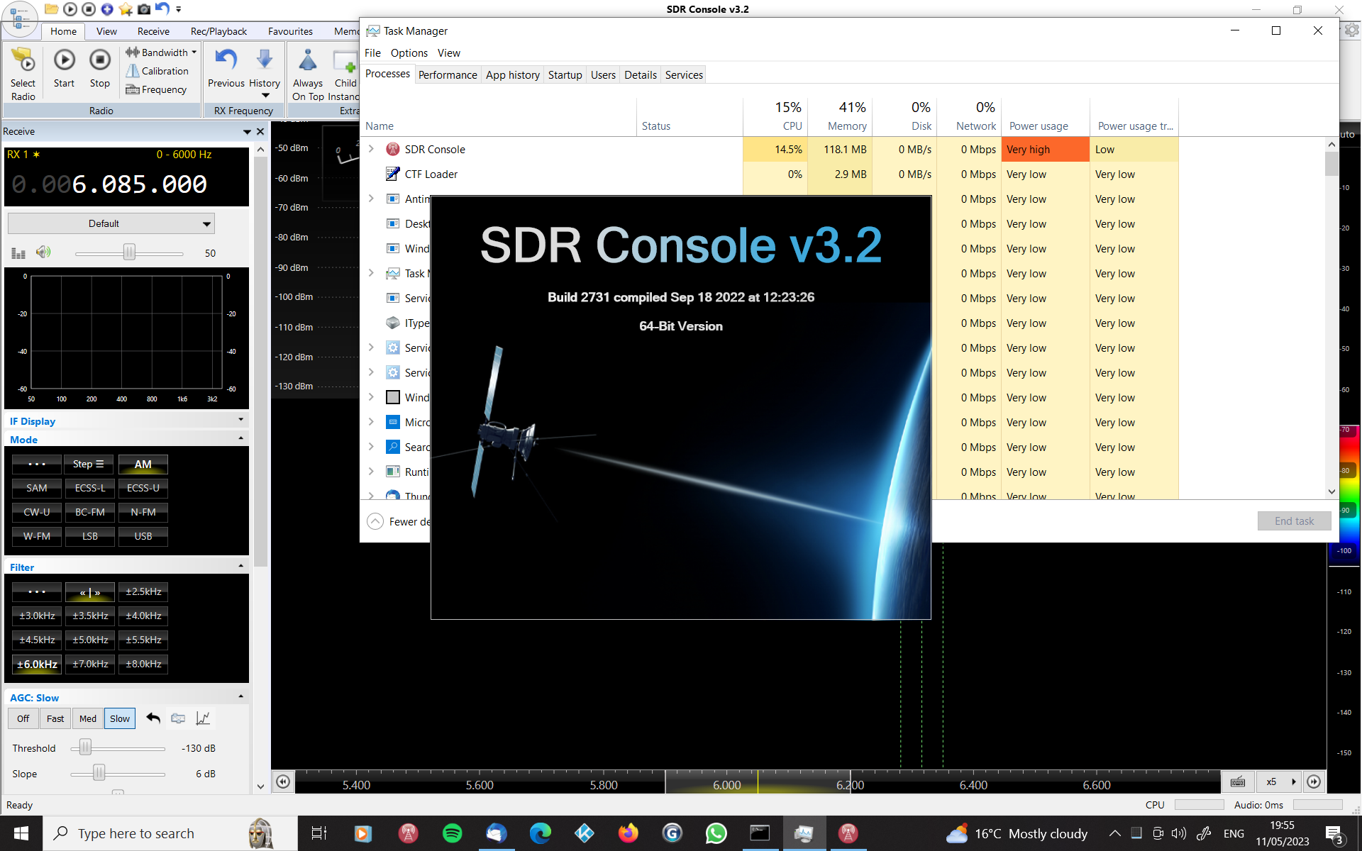

If I start SDRC with the AGC panel visible, then the splash screen stays up indefinitely while the task sits burning CPU (see screenshot). Note, the radio (an SDRplay RSP2) has not been started. The splash screen does go away when I click on the SDRC window, but SDRC remains rather unresponsive with a variety of symptoms (e.g. radio starts playing when started, but the waterfall doesn't appear).

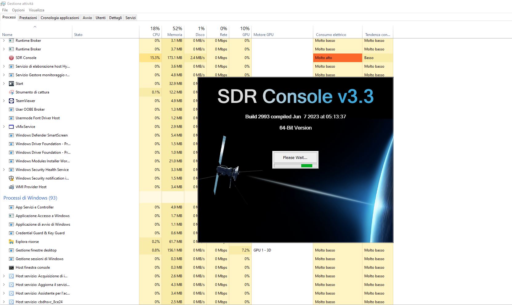

Same here.
Some information:
windows 10 pro 19045.2965 64bit , gtx 1050ti, 8 gb ram.
This is main session, of 5. Only main session have this problem. (Main session using many FAVORITES, can be ?)

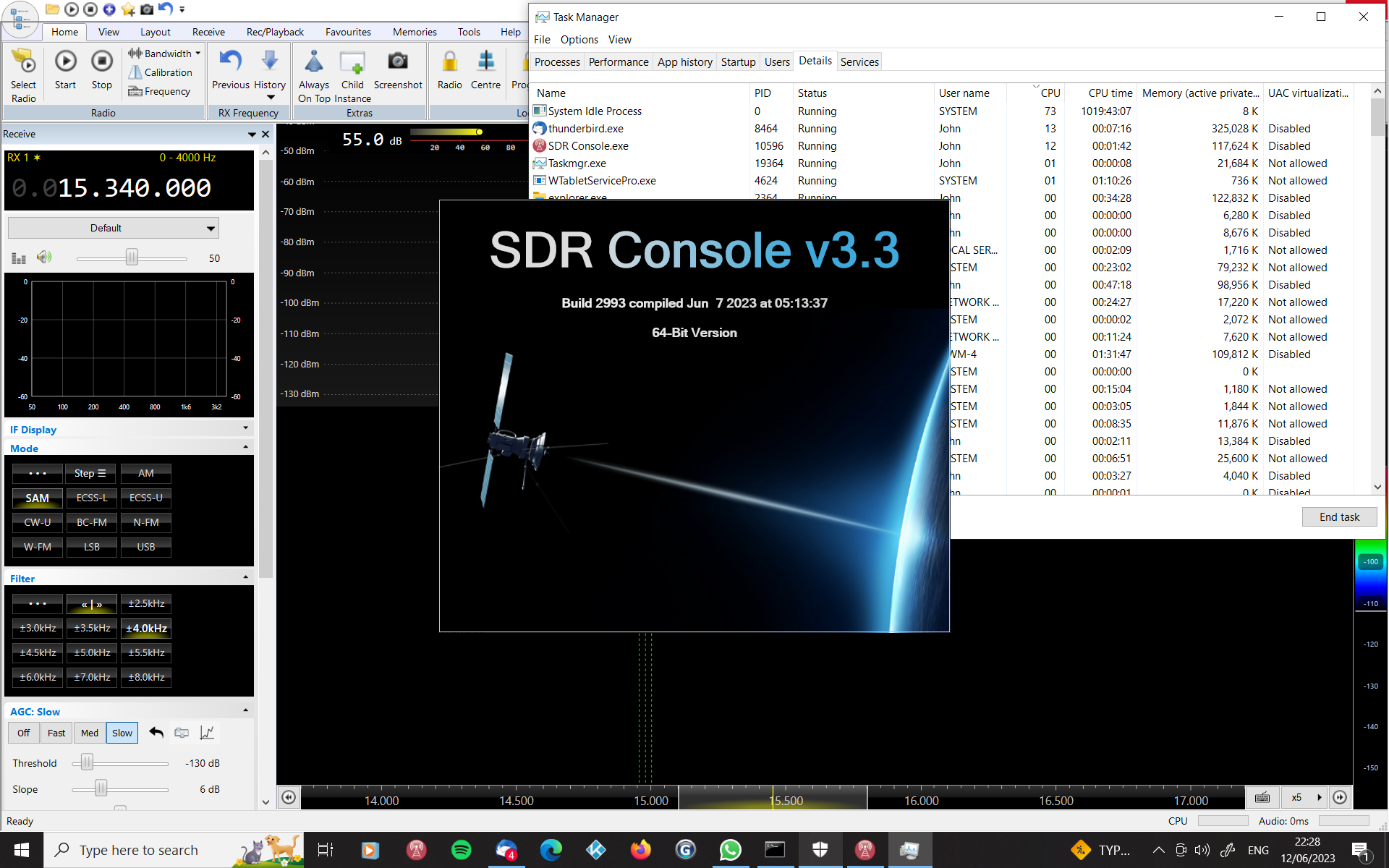

Here's a screenshot showing Task Manager in Details mode. Only SDRC is using significant CPU.
*edit* Oops, this screenshot also caught Thunderbird doing it's occasional fetch. I promise this isn't always the case, but I'll make a new screenshot showing that if you like!

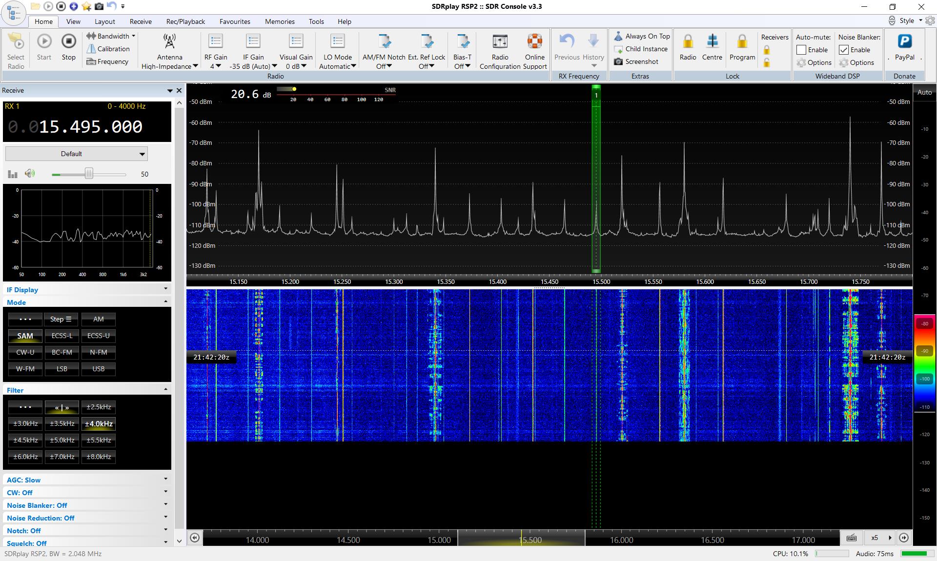

Here's a screenshot showing a successful start (with the AGC pane "rolled up" -- that was the only change I made) and with the radio started. I have no undocked/floating windows.
