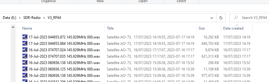

It is attached as a Windows Title.
Best illustrated with the attached grab from one of my SDRC directories.

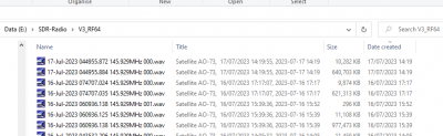

Hi Colin,
thanks for the reply.
It clearly shows that the satellite name is NOT in the filename! (extract from Satellite Tracking Options: The filename includes the name of the satellite as well as the date and frequency) However, that might only be true if the I&Q recorder is being selected.
