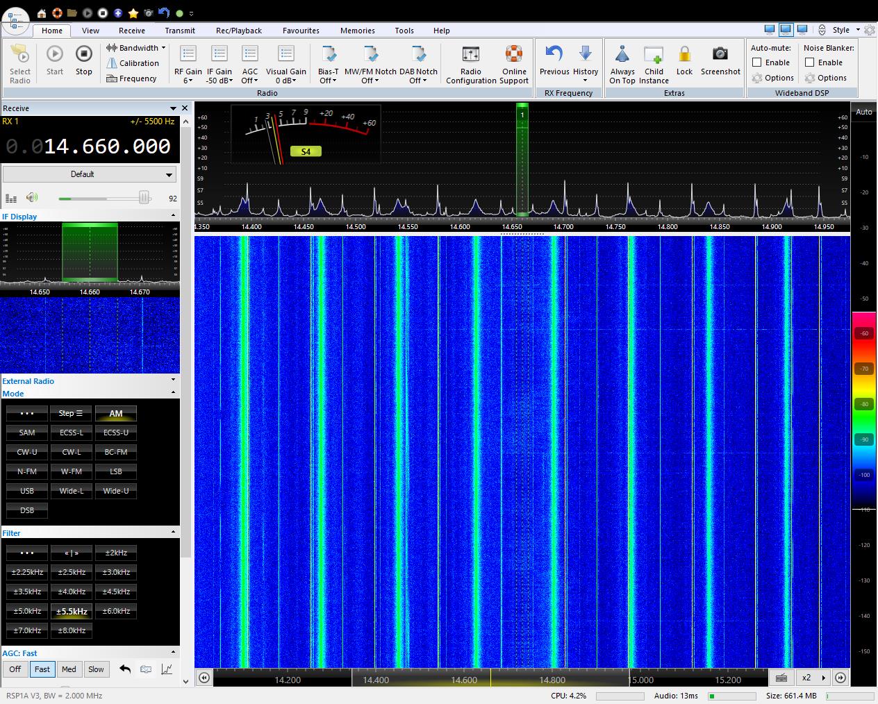

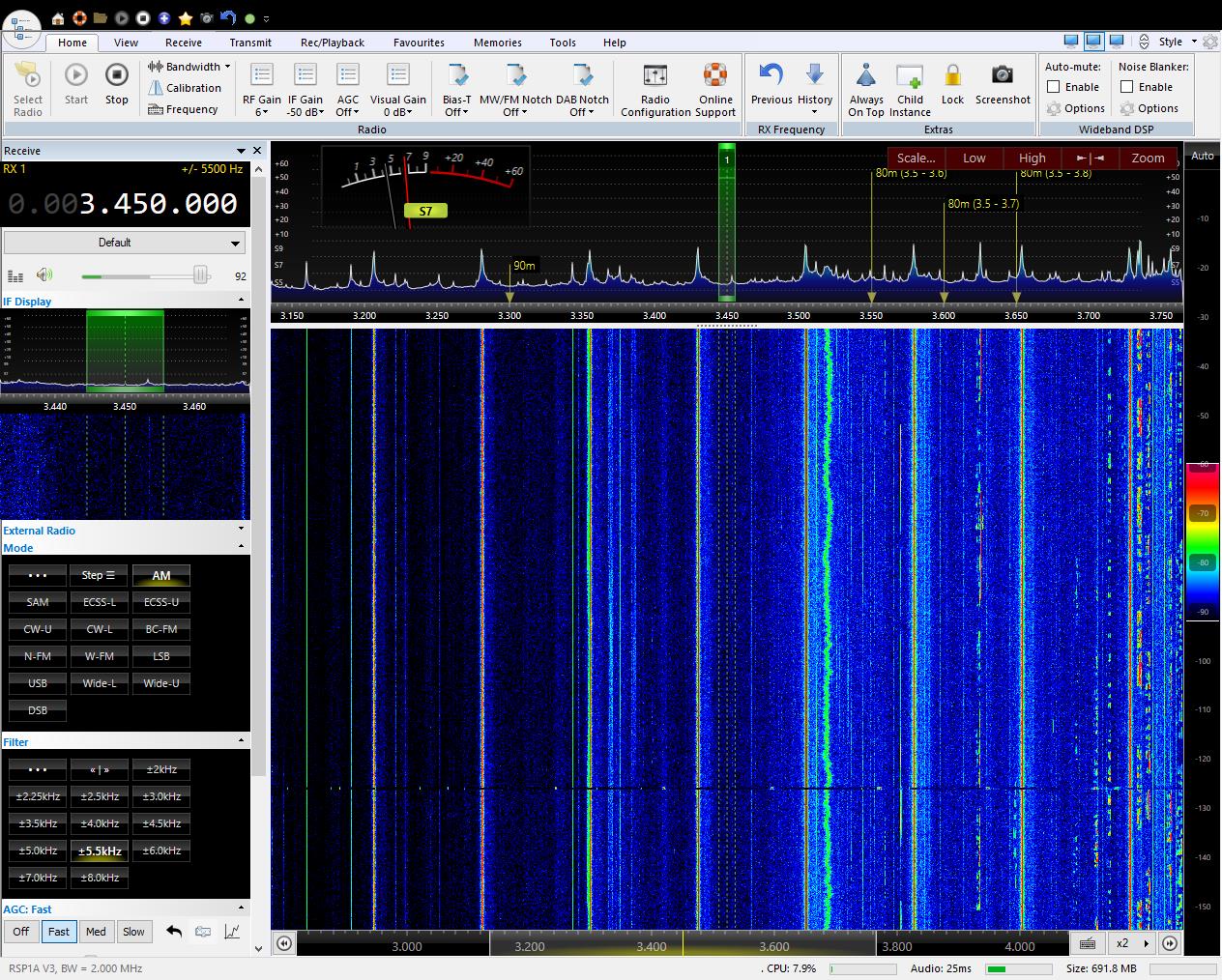

Well that's my listening seriously curtailed.
This weekend broadband interference has appeared across the HF spectrum.
I have new neighbours one side but they are still waiting for their broadband to be connected and the other side say they haven't changed anything.
Really annoying as I went to all the trouble of eliminating it from my own broadband.
When it stops raining I will go out armed with smart phone and SDR to see if I can track the source.

It appears to be 70kHz spacing on the traces, per the top image.
Yes the spacing is 74kHz across HF.
This has to be a SMPSU somewhere. I will do a house power down tomorrow and see what that produces.
