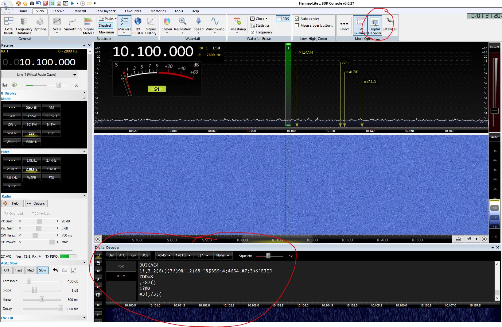

Yep, all good here thank you. Assume maybe you know that SDRC already has built-in decoder for RTTY and PSK? Although admittedly it's not the subject of much discussion on here so easily missed! Just one click away to turn it on (see attachment - sorry, could not find an RTTY signal to show working, not even meteo for some reason).
Just in case you never used it, select USB mode and then tune signal of interest right in middle of USB passband (maybe with a narrow filter bandwidth suited to the RTTY signal of interest). This puts the signal you are listening to just inside the left edge of the decoder window. Any other visible signal further to the right in the decoder window (higher in frequency) can be clicked on and decoded, but only the one shown extreme left in the decoder is heard in the USB filter. i.e. the filter width set in the RX DSP panel is totally irrelevant to decoding ability, only set to be able to tune and hear/identify one audible signal as above. Hope it makes sense.
Truth be told PSK(31) used to be very popular but in my experience at least seems to have been almost totally taken over on ham bands by FT8. I hardly ever hear PSK these days. Shame, because PSK is great as a "chat" mode. FT8 is just a QSO collector. OK for just collecting stats but not the greatest social invention! However, due to it's popularity FT8 can be heard at any time of day a band is open, so useful in that respect, and an FT8 contact is always available to made made pretty much any tome of day or night.

Yes, my next little project, I think, is to see if I can pick anything up with the
two digital modes directly already in Console.
I think multitask is just too much for me these days.
Might take a look at Sigmira too.
Have never really played with the digital "stuff," so will
be interesting.
