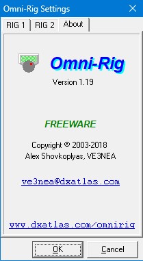

luigi wrote: Tue May 09, 2023 12:52 pm after CW skimmer I tried to interface SDRC with my Easy log software. the same does not work, I believe the problem is in SDRC there is no other explanation or in the last upgrade of OmniRig
https://vac.muzychenko.net/en/
I don't think that your issue is anything to do with the VAC. You say signal arrives fine with CWS. Must be COM/Omnirig issue surely?
You should NOT use Omnirig, latest version. I believe it has many problem issues/incompatibilities.
You need Omnirig 1.2:
http://www.dxatlas.com/OmniRig/
I have SDR Console serial port working perfectly with many other programs. N1MM+, Log4OM, CWS, CSVUB, etc. etc. etc.
Don't use any other version of Omnirig. Could that be the issue?
Actually I seem to be running 1.19 but it works just fine.
I really do not remember clearly if it was ever possible to tune Skimmer from the SDRC end apart from the initial band selection? Sorry, I cannot confirm it just now. Must be others on here using CSW with SDRC surely?
