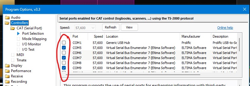

Did you enable the SDRC COM port of the pair by enabling it here?

I flagged port 2 and 5 as I see in your photo I only changed Speed ​​from 57.600 to 19.200 but in your photo I see written Virtual serial Bus etc. while in my configuration it says unknown

After doing what I saw in your picture I decided to change the speed to default 57.600 so the Cat 2 port assigned to SDRC and the Cat 5 port assigned to CW Skimmer remain both flagged.

In the SDRC screen I posted, you should select (tick) ONLY the Com port you assign to SDRC, NOT the one you assign to CW Skimmer, so not 2 AND 5. Only 2, NOT 5.
I always create my com port pairs adjacent, so 5/6, 7/8, 9/10 etc., then I always allocate the odd port number to SDRC and the even port number to the application.
When you created your port pair in VSP Manager, are you sure you created Com2 and Com 5 as a pair? Seems an odd choice not to have them adjacent? What you are seeing would seem to indicate that Com 2 and Com 5 are not a pair?

Yes, the ports with VSPE are Pair he created them automatically and in the VSPE page it says, Device Pair status OK.
now I try to remove them and recreate Com Ports in Pair mode by assigning a sequence.
Of course I only flagged port 2 assigned to SDRC and not 5
