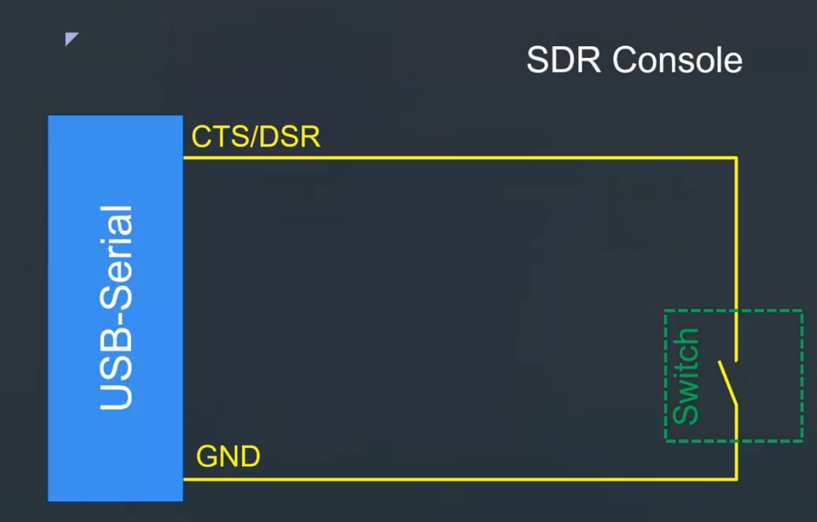

by Max
Alessandro55 wrote: Fri Jan 02, 2026 11:26 pm OK, I'll try tomorrow and post the results, thanks again, I read how to build a ptt but it's not very clear to me
Questa USB funziona se la collego al PC e al PA per utilizzare con elad e console sdr il PTT meccanico tramite pulsante?? Devo poi attivarlo naturalmente dal console sdr
FTDI Serial adapter (any) like this/Adattatore seriale FTDI (qualsiasi) come questo:
https://www.ebay.co.uk/itm/365943351983
See very simple circuit like attached picture/Guarda il circuito molto semplice come nell'immagine allegata
Serial interface.jpg (54.93 KiB) Viewed 2166 times
Taken from here/Preso da qui:
https://youtu.be/F-edK-1KpRc?t=185
Technically better but possibly more complex than needed/Tecnicamente migliore ma forse più complesso del necessario:
https://lance.conryclan.com/home/buildi ... interface/

Alessandro55 wrote: Sat Jan 03, 2026 6:09 pm
Usb2rig is not good, I did not understand how to connect the pen, from the PC to the ptt of the pa??
OK I am now very confused. I thought what you wanted was to connect PTT switch to SDRC to be able to make SDRC enter transmit mode with an external switch like a footswitch for example when using the Elad FDM-Duo. That is what this circuit was for. In this case use switch to ground the CTS, not DTR!
None of this is needed for the Hermes Lite 2 which has it's own PTT on the rig.
Is this what you want (put SDRC in to TX mode with FDM Duo) or are you trying to do something else?
Ok, ora sono davvero confuso. Pensavo volessi collegare l'interruttore PTT all'SDRC in modo da poterlo mettere in modalità trasmissione con un interruttore esterno, come un interruttore a pedale, come quando si usa l'Elad FDM-Duo. Questo circuito serve proprio a questo. In questo caso, usa l'interruttore per mettere a terra il CTS, non il DTR!
È questo che vuoi (mettere SDRC in modalità TX con FDM Duo) o stai cercando di fare qualcos'altro?

by Max
As for my previous reply, connect switch to GND and CTS (not DTR)
Then connect USB to the PC (not to the Elad)
Job done!

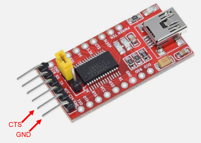

by Alessandro55
Perfect, so PC and in my case PA (RM Italy 505) doesn't it matter that at the PA PTT input I also have other PTTs from other SDRs? Thanks
I took this one, it cost less and it was in Italy
But this one DOESN'T HAVE A CLEAN CONTACT, it has 5 volts! If I get the pin wrong, I'll burn the battery... are you sure about the contacts? Thanks
