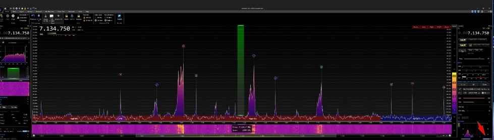

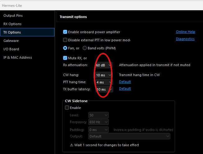

Hi guys, I'm having a major problem with the TX audio and with HERMES LITE. My voice cuts out in spots, and the watts are delayed! There's a lot of latency. I tried lowering the buffer, setting the TX and RX sampling rate on my sound card to 48 kHz, and reinstalling the program as administrator...nothing!!! My voice is still delayed, and the power is intermittent...please help me! Thanks, and Happy New Year!

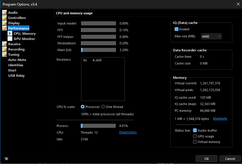

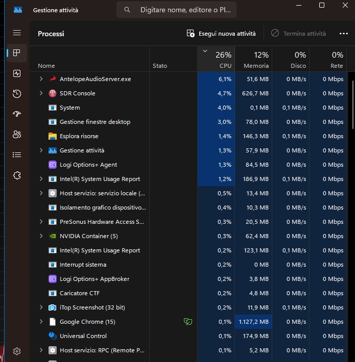

The PC is performing quite well, as you can see.
sdr: Hermes Lite

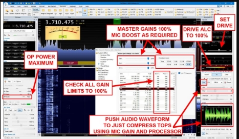

I also performed the fixes suggested in the screenshot without success.

I add the percentage of how the PC works

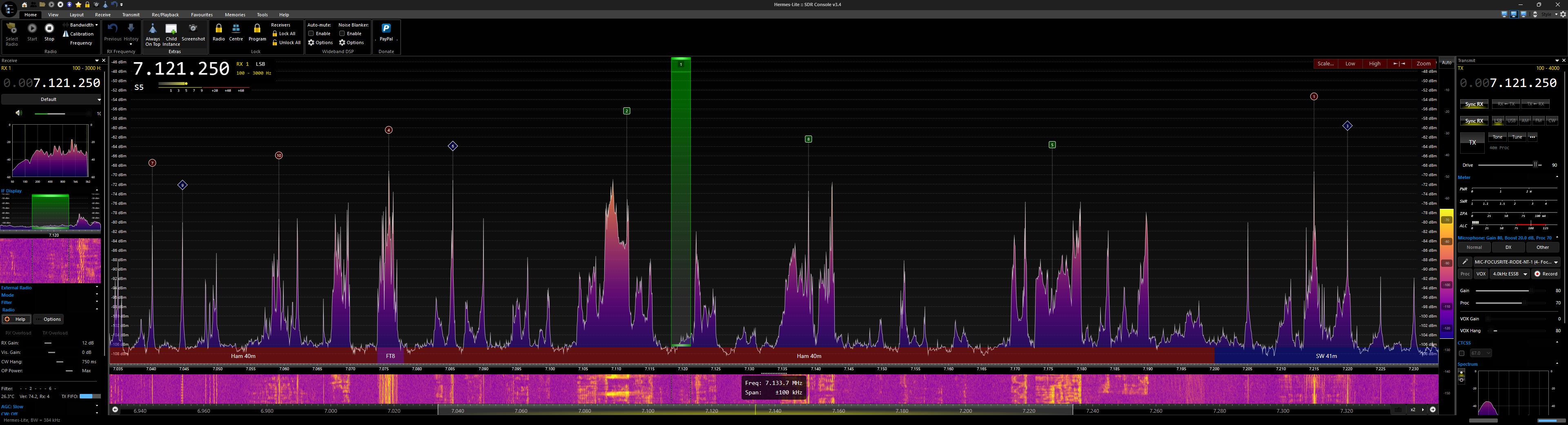

The main screenshot in the first post is not readable. Please take a screenshot using the built-in screenshot tool in SDRC and post it here UNCROPPED as there is information on the periphery that is important.

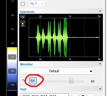

Try to find out where the latency is coming in, audio or RF.
So to check audio latency, in the TX DSP panel, use the audio monitor set to "RX" and tap the mic without pressing PTT (assuming it's not a comms mic that needs PTT pressed). How much latency do you hear? Should be very little. Fraction of a second, maybe around 50ms for me.
You have STILL posted a cropped/sized screenshot. PLESASE USE THE SCREENSHOT TOOL AND POST IT HERE ATTACHED. DO NOT EDIT IT!

I used the one from the screenshot software
I'll try it now and let you know, for the screenshot maybe the problem is the screen I have a 49" curved

OK, apologies. Yes, that could well be the issue. Unfortunately it makes the screenshot hard to read.Alessandro55 wrote: Wed Dec 31, 2025 3:53 pm I used the one from the screenshot software

You posted the screenshot of the audio spectrum, but I only posted that to show the "RX" monitor button activated to listen to the mic audio in to the TX DSP panel so that you can listen for the delay/audio latency. So with RX monitor turned on, and the monitor level turned up, if you just tap the mic, what sort of delay do you hear? Almost no delay? 1/2 second, 1 second? Approximately how much?
