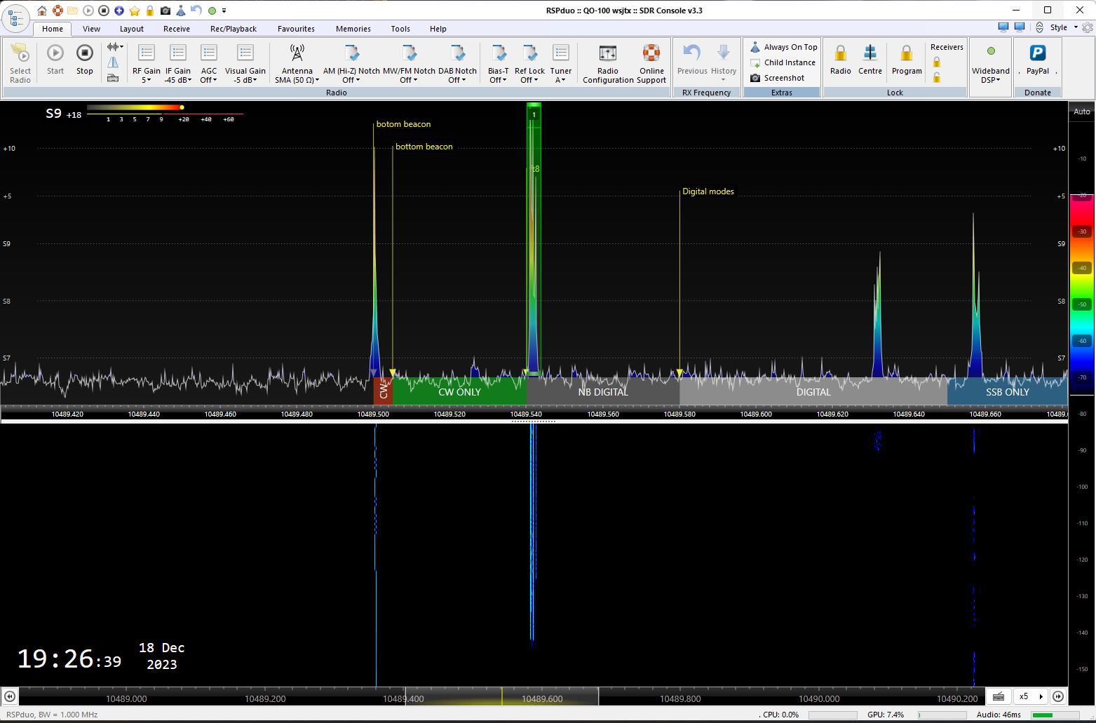

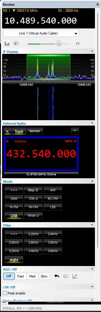

Hi Max
I split the signal from the down converter and feed the 9700 and sdr play duo everything works except rit when i adjust the rit on the 9700 nothing changes on console.

G5TV wrote: Mon Dec 18, 2023 7:46 pm Hi Max
Hi again Brent
Googling I see a few people saying RIT is problematic on the 9700. I wonder if you have tried the 9700 ini file for Omnirig from this site which seems to be modified to make RIT work with SDRC? Don't use the modified version of Omnirig however. You need to stay with the official version from DX Atlas:
https://www.hb9ryz.ch/omnirig/
Be interested if this helps at all? Although now I look again it mentions ini does not work with IC-9700 in Sat Mode? It might be worth contacting HB9RYZ about this to see if he can help?
Maybe test both with and without sat mode to first establish if RIT works in "normal" mode?
