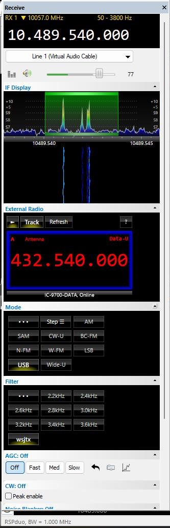

Hi Max
I split the signal from the down converter and feed the 9700 and sdr play duo everything works except rit when i adjust the rit on the 9700 nothing changes on console.
Screenshot-2023-12-18-192912 rit.jpeg (77.16 KiB) Viewed 12299 times
