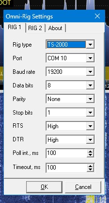

it seems that everything works now. the problem was the incompatibility of VSPE with SDRC. I downloaded VSP manager and the sync works on both sides
only the last request, as you set:
Poll Int:?

I have never changed them from the default values as far as I recall:
