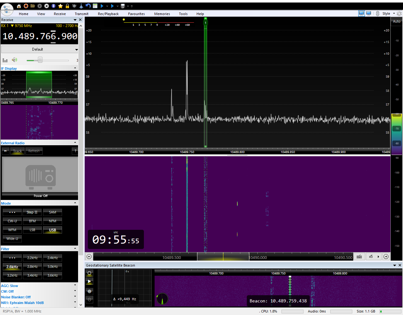

This has "crashed" again in that the display froze but the app was still running. However, I now have more info.
SDRC had been running for some time and the display froze when I switched on the power of the external radio. The radio is connected to the PC via a cat cable but was "off" in SDRC at the time. The log is attached together with screenshot and I also have a dmp file if required.
Last few lines of log:
08:38:20.186: Radio Reader> Sample rate: 1000110.233859
08:40:00.194: Radio Reader> Sample rate: 1000056.053142
08:41:40.183: Radio Reader> Sample rate: 1000104.218751
08:43:20.195: Radio Reader> Sample rate: 1000046.116127
08:49:19.641: OnSysCommand: nID 0000F120 SC_RESTORE, lParam 00000000
10:52:11.043: USB Notification: Device Unknown, A device has been added to or removed from the system.
10:52:11.118: USB Notification: Device Unknown, A device has been added to or removed from the system.
10:52:11.139: USB Notification: Device Unknown, A device has been added to or removed from the system.
SDR Console tmp_device added.txt
(28.68 KiB) Downloaded 275 times
David M0TGC
This is the clue - USB power. You maybe heard the bingly-beep sound.
