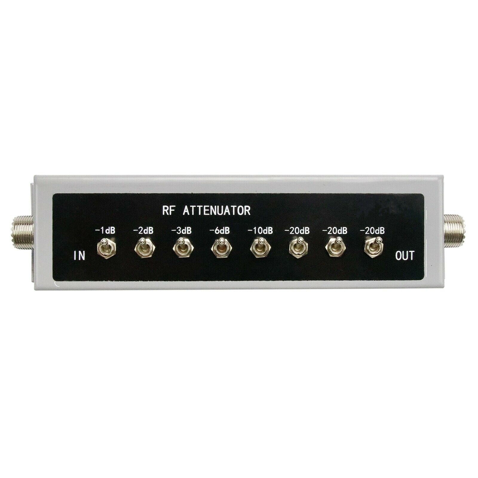

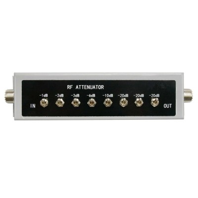

Last week I ordered a step attenuator off ebay. Came in yesterday and It helps drop the noise down without greatly impacting the signal. I use it mostly on the low settings (1 through 10 and mostly a combination of the first 4 switches). If your handy and have some resistors on hand this could be made for much less.
John
Posts: 1044
Re: Trying to suppress this noise...Any ideas?
#12
That is nice at HF. It's not so nice at VHF and above where you need a low noise figure. In fact I'd say it is a required piece of equipment for people with low loss antennas at HF. 30 dB attenuation is not too much on 160 or 80.
