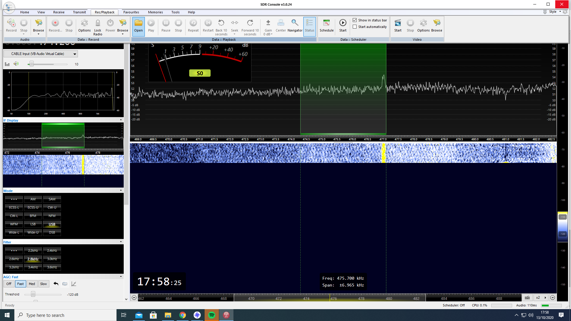

Its the 2nd pic I sent
I also noticed then in the top left window, it flashed up console not responding during the 3 sec blue circle search
sorry for all the messing about, never used snip b4 and it wasnt accepting the BMP file
regards Ian G0FYD
regards Ian G0FYD

Re: SDR Cvonsole crash playing recording
Jim
regards Ian G0FYD
regards Ian G0FYD
OK.
Click Rec/Playback
Click "Open"
Before you click Folder(if that is where you get the crash), open up the snipping tool and take a pic of the area, so we can see the dialog window prior to when you carry out the action that causes the crash.
Also, try this.. access the folder where the files are kept using File Explorer. Check the list of files look as they should be.
Then, move the files to another folder altogether, then try and access the original (now empty) folder in Console.
Click Rec/Playback
Click "Open"
Hi Jim
It crashes as soon as I hit open in REC/PLAYBACK within console so I never get any further. I dont see where its heading within Windows, I presume it has a memory of a previous search but i dont know where its looking becuse it crashes before I see any files or windows folders to select Thats why I think its an issue with my comp somewhere, I did see that vy quick flash up in console of SDR Console not responding in the top left corner of console
As soon as I hit Open its gone in 3 secs so I never get beyond Console. Its a weird one hihi.
I have got as far as compressing the Crash dump file but not sure where the Compressed file has gone to, I am a right computer dork at times, Then i have got to learn how to upload the compressed file
In clicking other icons like Browse etc it does not crash
The ribbon bar changes made no difference Max
Regards Ian G0FYD
Regards Ian G0FYD
