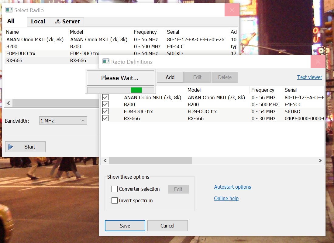

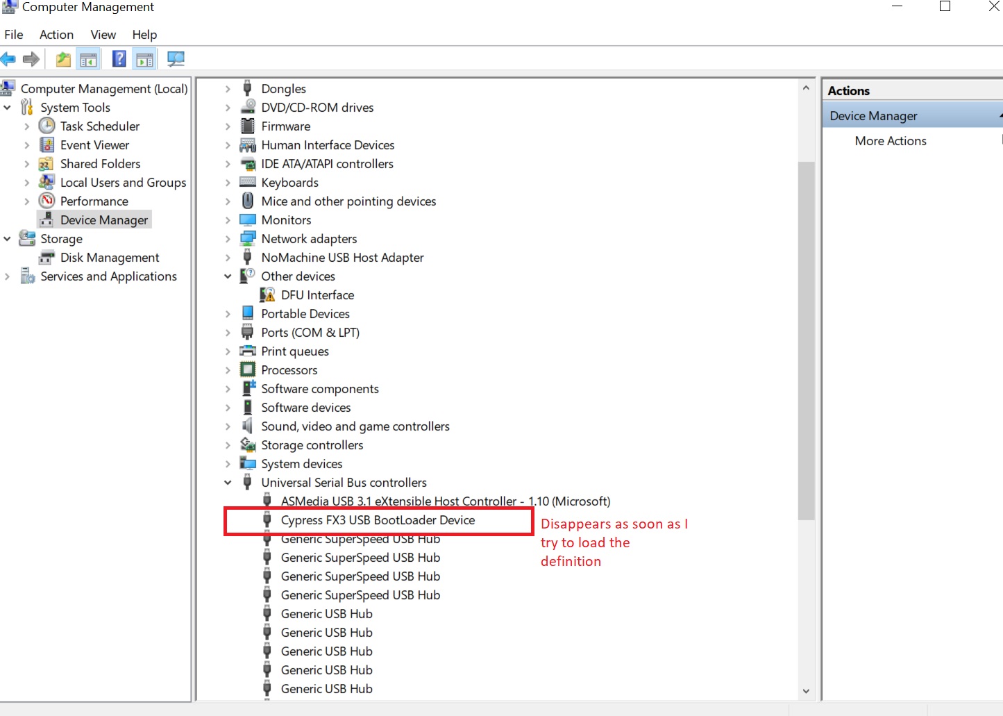

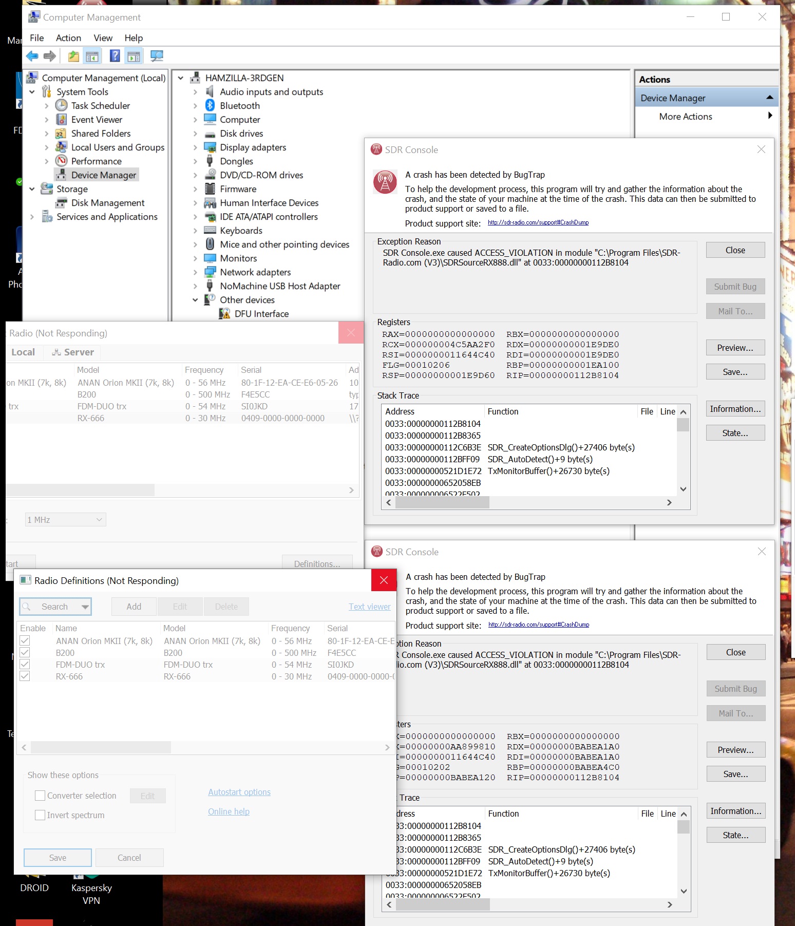

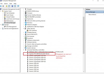

So I have the RX-888 MKII and it crashes SDR Console 3.0.26 when I try to add the definition. I will add some screen shots next time I can capture them. Ironically if I select 666 it will load the definition. It doesnt seem like its really receiving though, just the single spike ever center of the display and waterfall.
I am using the latest drivers FSK Win 10 from the Cypress Site. Anyone else get this working with SDR Console?
Re: RX-888 USB3 problems

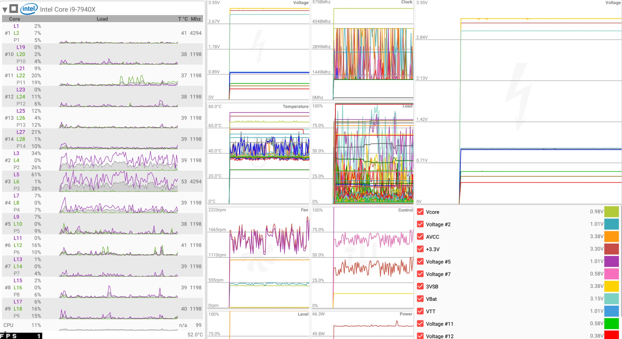

USB 3 RX-888 MKII SDRConsole Crash. The computer is a beast so it cant be that!

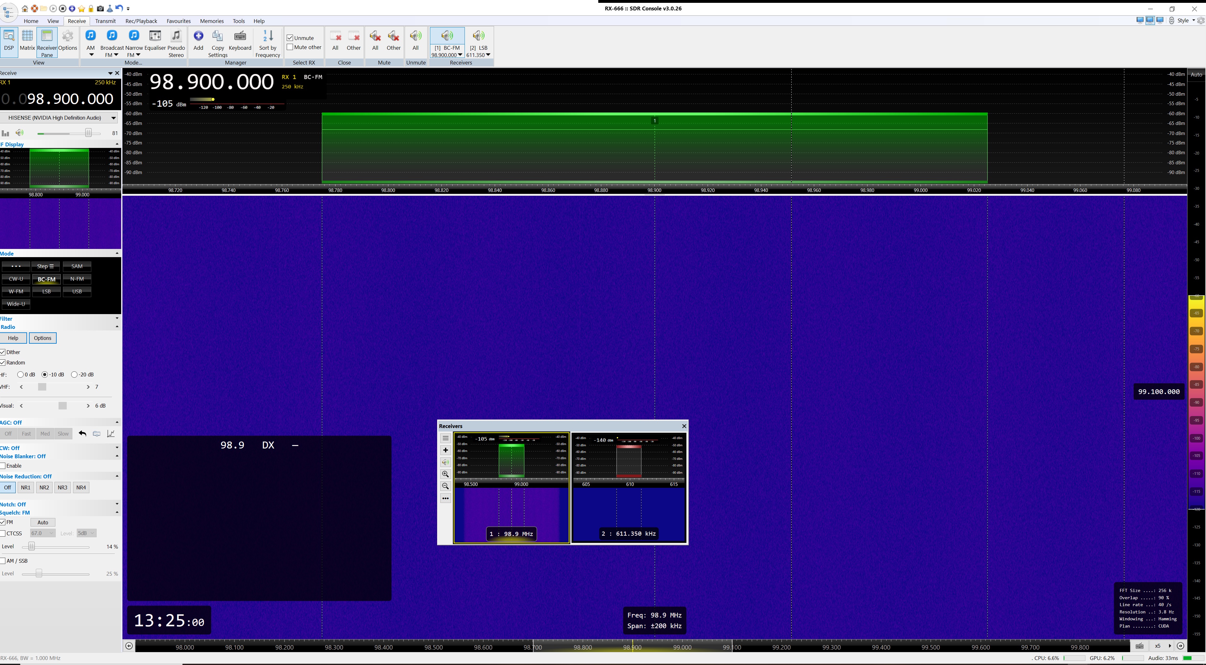

So the 3.0.27 version does not crash. I dont feel like its getting any RF though except interference. HDSDR EXTIO has same result, radio connects and yet I dont see any signals. Its so odd! How do you select which antenna it uses in either program?
