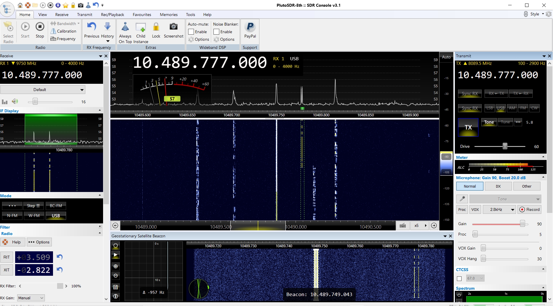

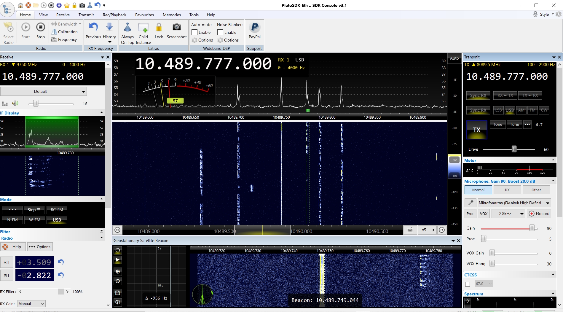

Here the screen shots.
one with dual tone (you can see interruptions very clearly, I was only transmitting once)
one with microphone
At the moment it's hard to do the tests, I can do the tests only in the evening when its already cold outside.
(My system is not a fixed installation, yet)
One more information: I'm using the Adalm Pluto via USB2Ethernet
one with microphone

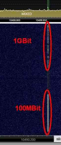

I wrote that my problem was solved using the "low power" option. This was valid only for some time. The issues came back over time.
I found a solution proposal at Amsat Forum
Only allow 100Mbit communication between PC and Pluto solves all my problems (stottering / long delay times while transmitting).
I've attached the waterfall diagram of my resuls.
You can see a two tone signal at 1Gbit/sec and at 100Mbit/sec
