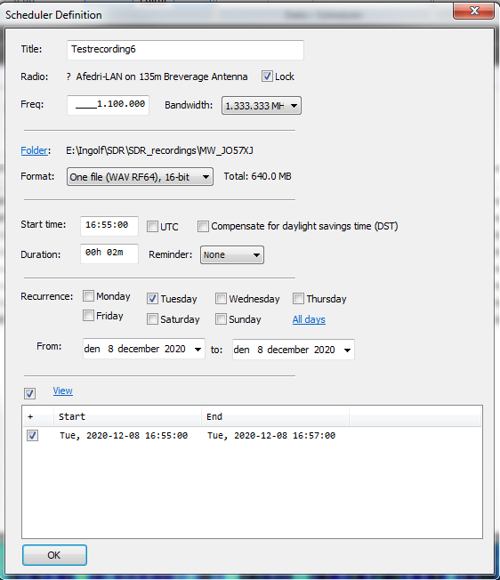

One more screenshot is appropriate for this issue, the "Scheduler Definition Window".
I noted that there is an "?" in front of the radio definition. That might have an meaning.

There's an odd folder name in the scheduled recordings image.
download/file.php?mode=view&id=843
This should always display correctly - maybe you can export the definitions and post here?

Yes Simon.
I got aware of that I had used Swedish characters in the folder name, "Råö". It has worked before but might cause problems now. I have changed the folder name now as can be seen in the "Folder" line
The question mark I was referring to was the one in front of the "Radio" line.

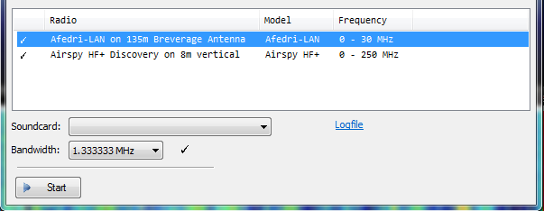

Is it the Radio Definitions as stated in the server you would like to see? If so, I will do so the next time I visit the server site.
I enclose a screenshot of the server connect / start pop-up as seen by the client.
