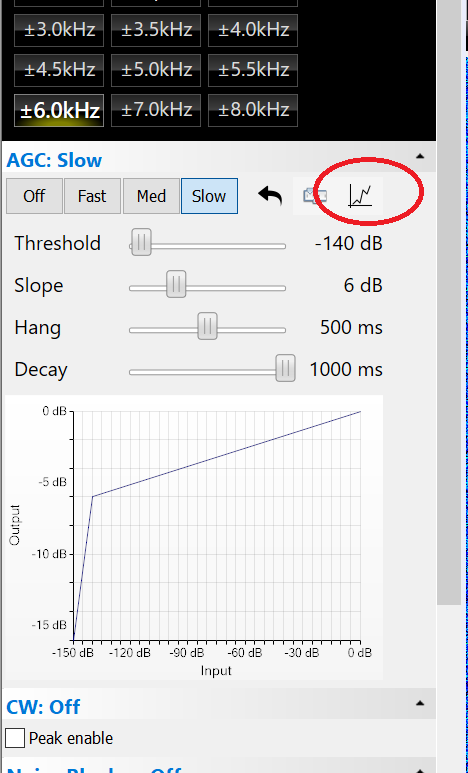

Re: CW?
#14
73 PD3LK Leon
N2EIK
Posts: 57
Joined: Mon Nov 16, 2020 10:58 am
Re: CW?
#15
Unread post by N2EIK »
Thank you. Still have question.
The lowest decay is 10ms on the slider
and I still do not see "real output sampling rate"
