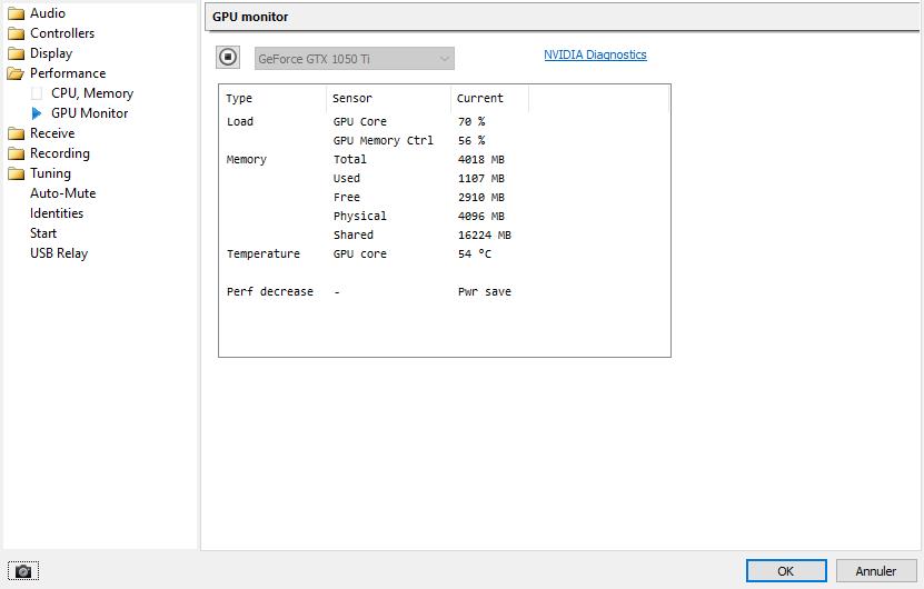

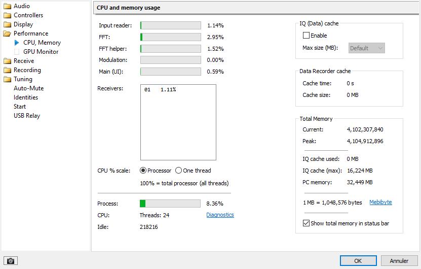

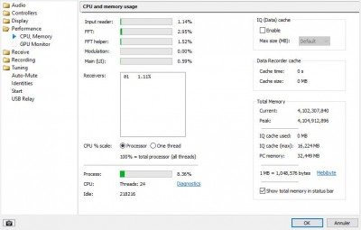

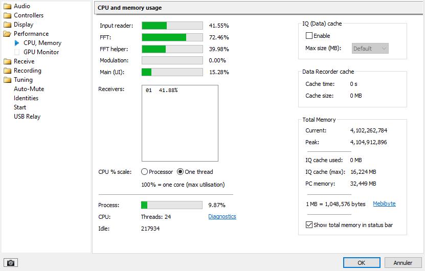

GPU just under 50%? That sounds a tad high. His GUI may be running way behind on updates.
Bizarre reaction with FDM-S3 and console V30.26 build 2085
Moderator: NN4F
- Posts: 2166
Re: Bizarre reaction with FDM-S3 and console V30.26 build 2085
Yes,jdow wrote: Sun Dec 13, 2020 3:53 pm GPU just under 50%? That sounds a tad high. His GUI may be running way behind on updates.
Something's chewing it up. Can be browsers.

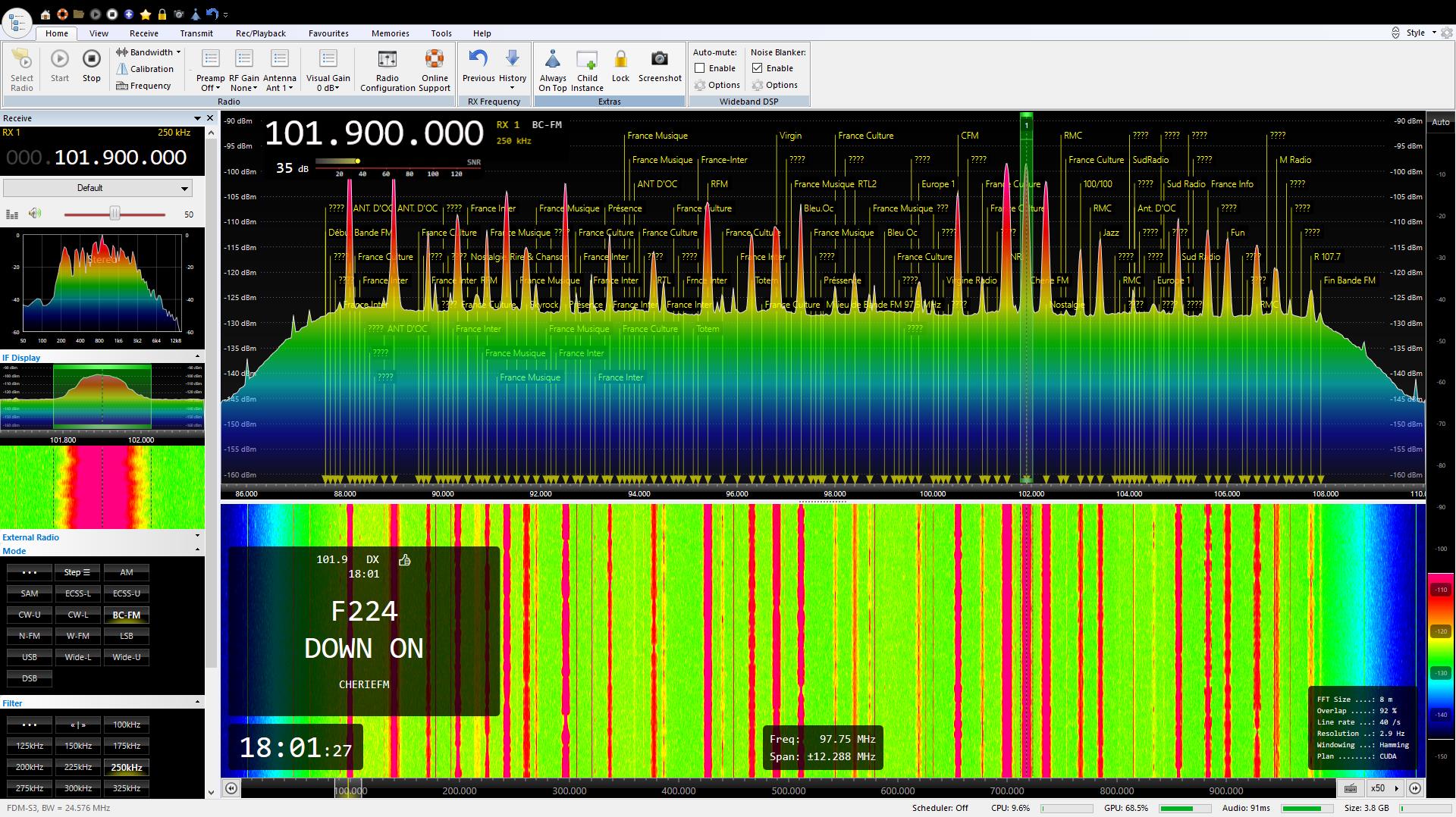

Re: Réaction bizarre avec FDM-S3 et console V30.26 construire 2085

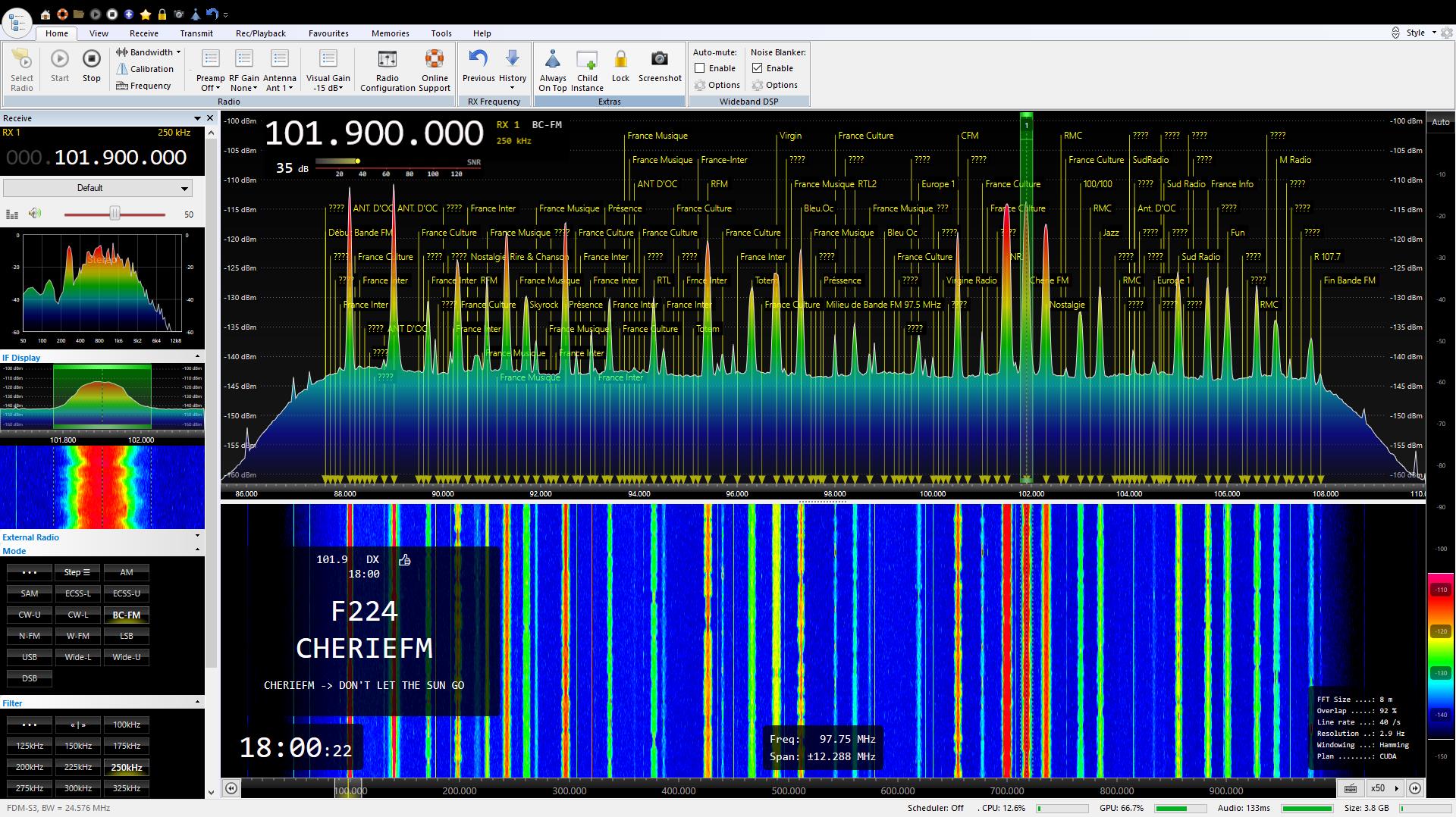

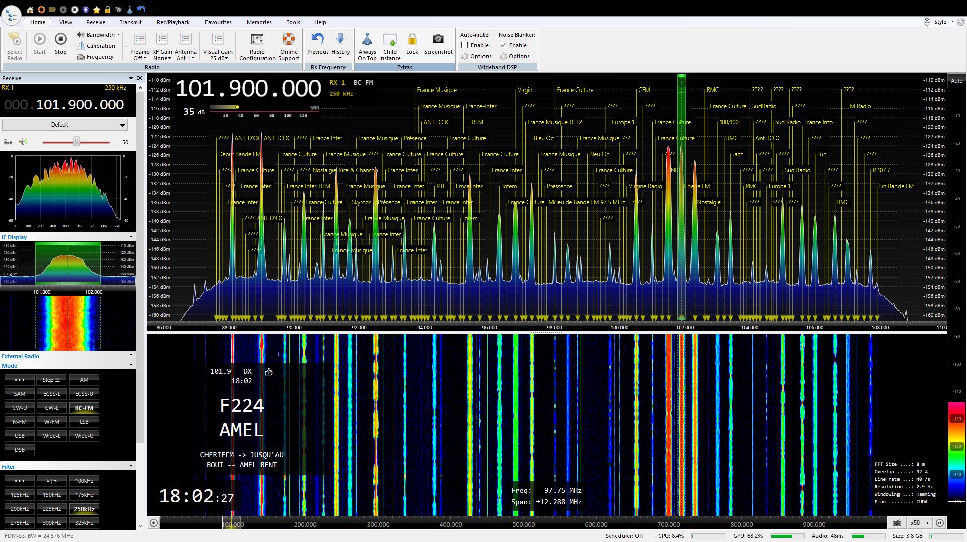

Suite of Saga FDM-S3 ELAD
Full shut down of the computer will restart the entire system.
Now, in my procedure, I completely stop the FDM-S3 because, It happened to me often at the beginning to leave the FDM-S3 on without stopping it (press the button on/off)
At the full restart, 50% of the launches, the SDR was not recognized, Console did not recognize it!
Now systematically press the button on the FDM-S3 stop button
Finally launch procedure with Bandwith at 3.075 MHz and Band set in the middle of the 88-108 MHz Band
Setting the Visual Gain = 0 and Scale auto = 0 to 160 dBm
OK launch works
Stop and relaunched with
Settings:
BW = 24.075 MHz
Visual Gain = 0
Scale = auto 0 to 160 dBm
Zoom = Mini
Contrast click = Auto

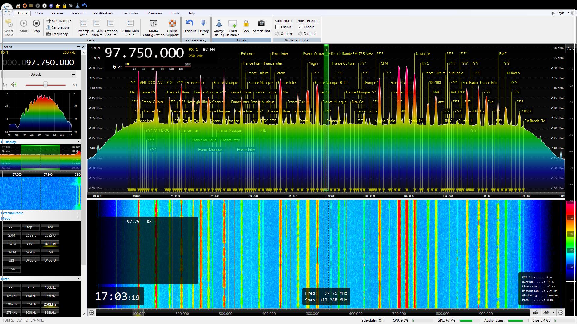

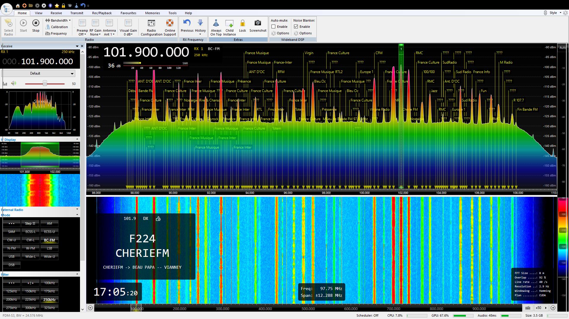

The FDM-S3, it Pulse!
Here at, with two Screenshot according to the settings described, just, above
Screenshot No.1 - Middle FM Band
Screenshot No.2 - Most Powerful FM Station
Simon, please, your reactions and advice, thank-you
Bernard

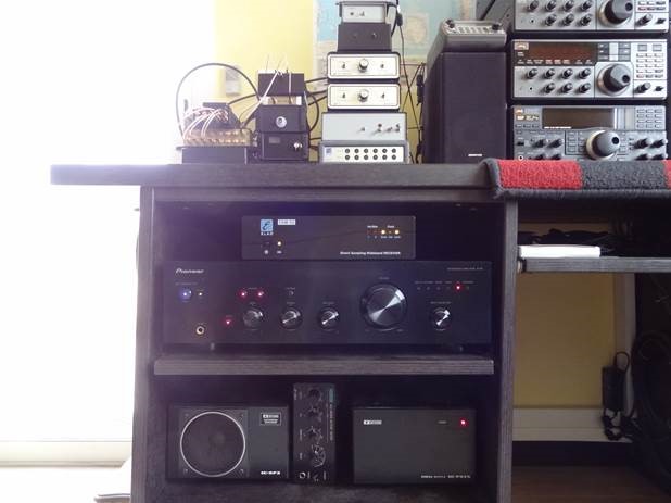

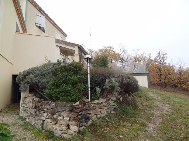

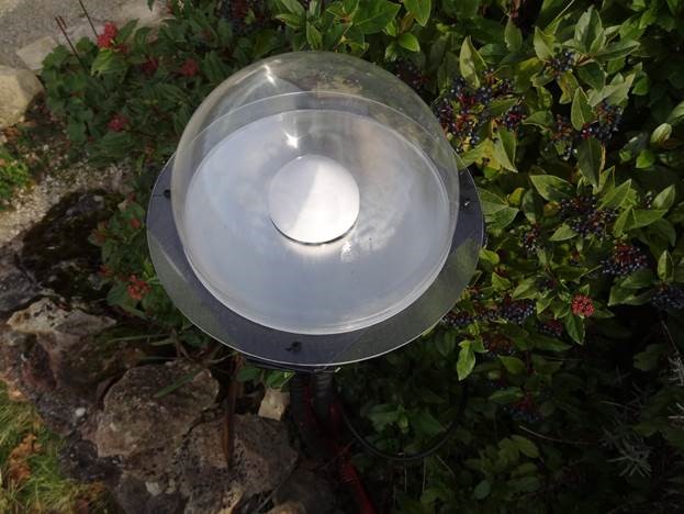

My FDM-S3 OCXO
For your information and with tree pictures
My FDM-S3, works wonderfully. It settled without any problems from the start.
My favorite software is the SDR Console V3 version 3.0.26 build xxx.
The FDM-S3 was recognized immediately without any blockage.
The version of my FDM-S3 is with an OCXO.
For its operation was implanted 12 meters from the shack an antenna GNSS Abracon AEACMK0660746-SG4.
On a mast with a diameter of 35 mm, height 1.5 meters above ground.
I placed an aluminum disc 1 mm thick of 200 mm diameter under the antenna.
The entire antenna is covered with a 200 mm diameter plexiglass dome.
This antenna is connected with 15 m of Amphenol LMR-400-DB coaxial cable.
Very good functioning and I visualize the proper functioning of this antenna by the software U-center_v20.10
Everything works remarkably well.

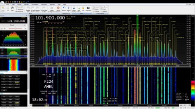

Setting Visual Gain = 0, -15, -25 (Three screenshot)
Complement information
- 03 SDR Console tmp.txt
- 03 Logfil
- (62.37 KiB) Downloaded 226 times
+ Directx Diagnostics
- FDM-S3 DxDiag.txt
- Directx Diagnostics
- (121.89 KiB) Downloaded 204 times
