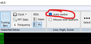

So can you please humour me for just one small trial (Jason too please, and of course Phill IZ1FKS if he's still reading this!). Can you please go to "View" tab in SDRC and have a look at the setting "Auto centre" (see my attached picture). If it is already off, then I am "barking up the wrong tree". If it is checked "On", can you please turn it off, and then check again that when you change zoom on SDRC you still get the frequency change?
The zoom level reset may be a separate issue? It's just the small unwanted frequency change when zooming I'm trying to understand first.

Max wrote: Sat Feb 24, 2024 9:20 pm Can you please go to "View" tab in SDRC and have a look at the setting "Auto centre" (see my attached picture). If it is already off, then I am "barking up the wrong tree". If it is checked "On", can you please turn it off, and then check again that when you change zoom on SDRC you still get the frequency change?
Sorry, forgot the picture (probably not needed):
