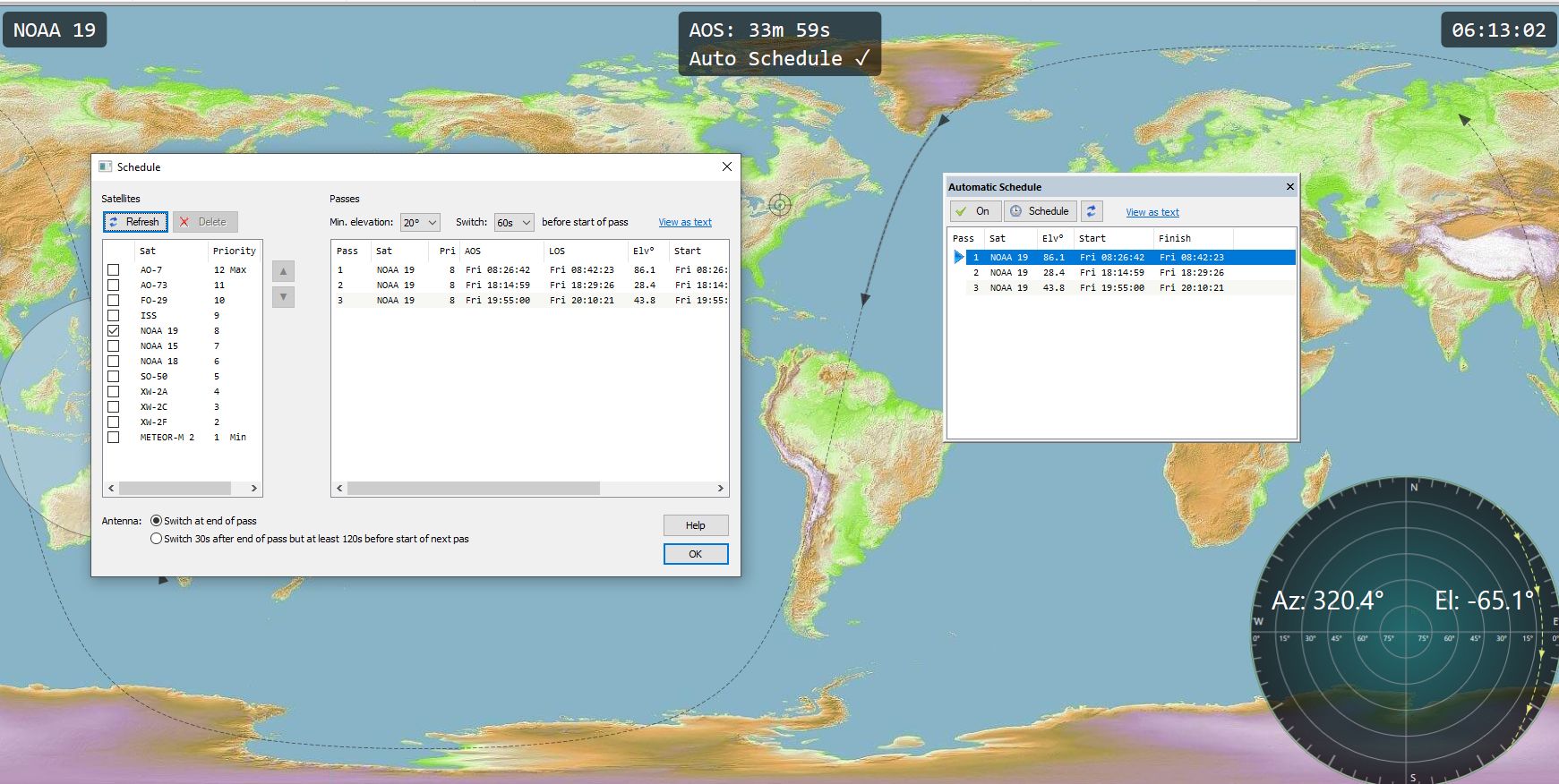

Thank you Simon. The "Min elev" works great. I tested it yesterday and today. It only records the passes with an elevation at or above the set elevation. I'll post a screenshot below showing the correct operation with NOAA 19. It did not record the earlier pass that was below the 20 degrees that I had set. Thanks again. I just made a £40.00 contribution for dog food.

VE3HST wrote: Fri Jul 02, 2021 1:53 pm Thank you Simon. The "Min elev" works great. I tested it yesterday and today. It only records the passes with an elevation at or above the set elevation. I'll post a screenshot below showing the correct operation with NOAA 19. It did not record the earlier pass that was below the 20 degrees that I had set. Thanks again. I just made a £40.00 contribution for dog food.
