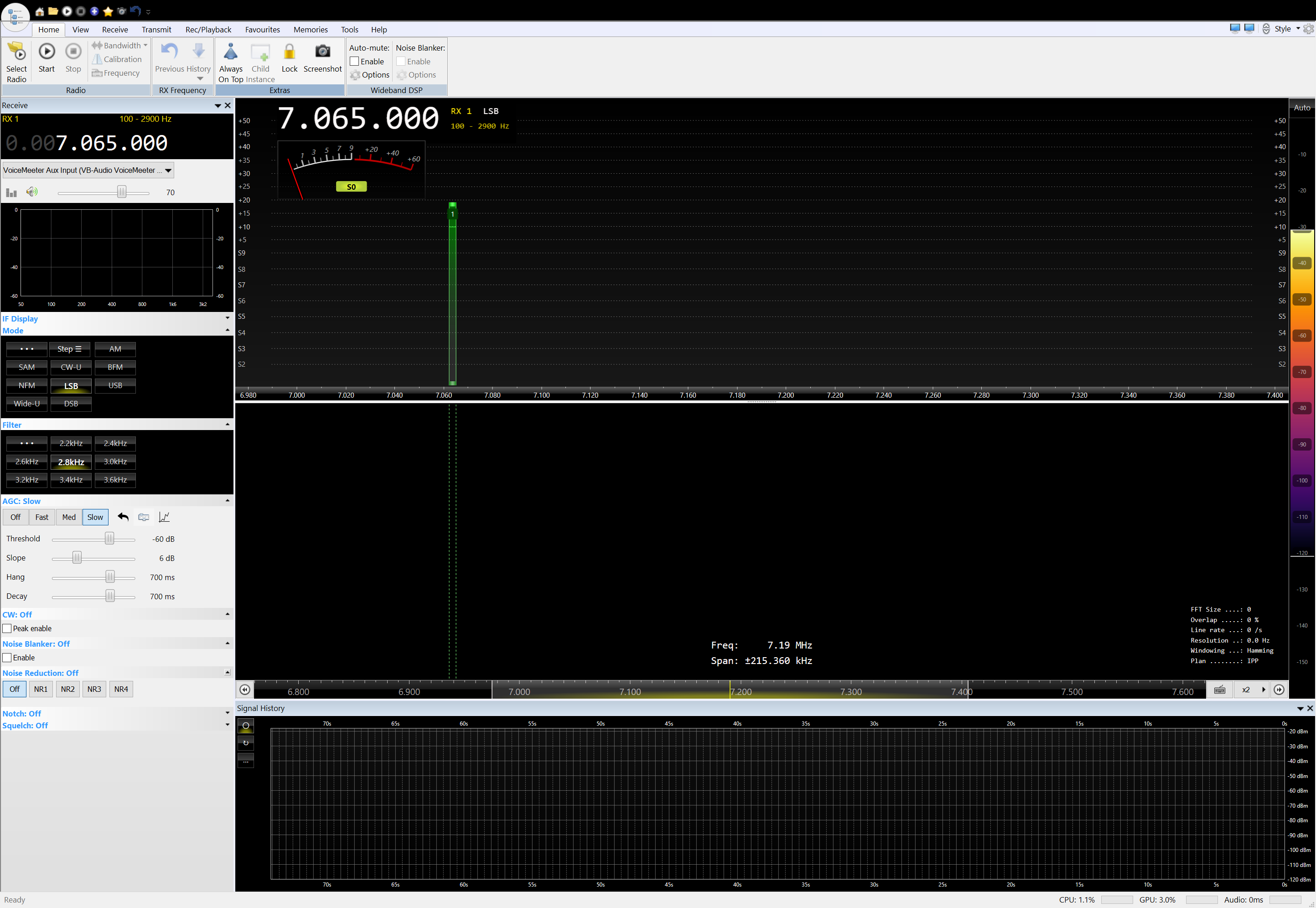

Re: Test Team - RX888 Driver & V 3.0.26
Simon,
Screenshot attached.
SDRC 'finds' the RX888 and the RX can be 'added', but 3.0.26 will not run without first running 3.0.25.
Rgds,
Charles.
Rgds,
Charles.

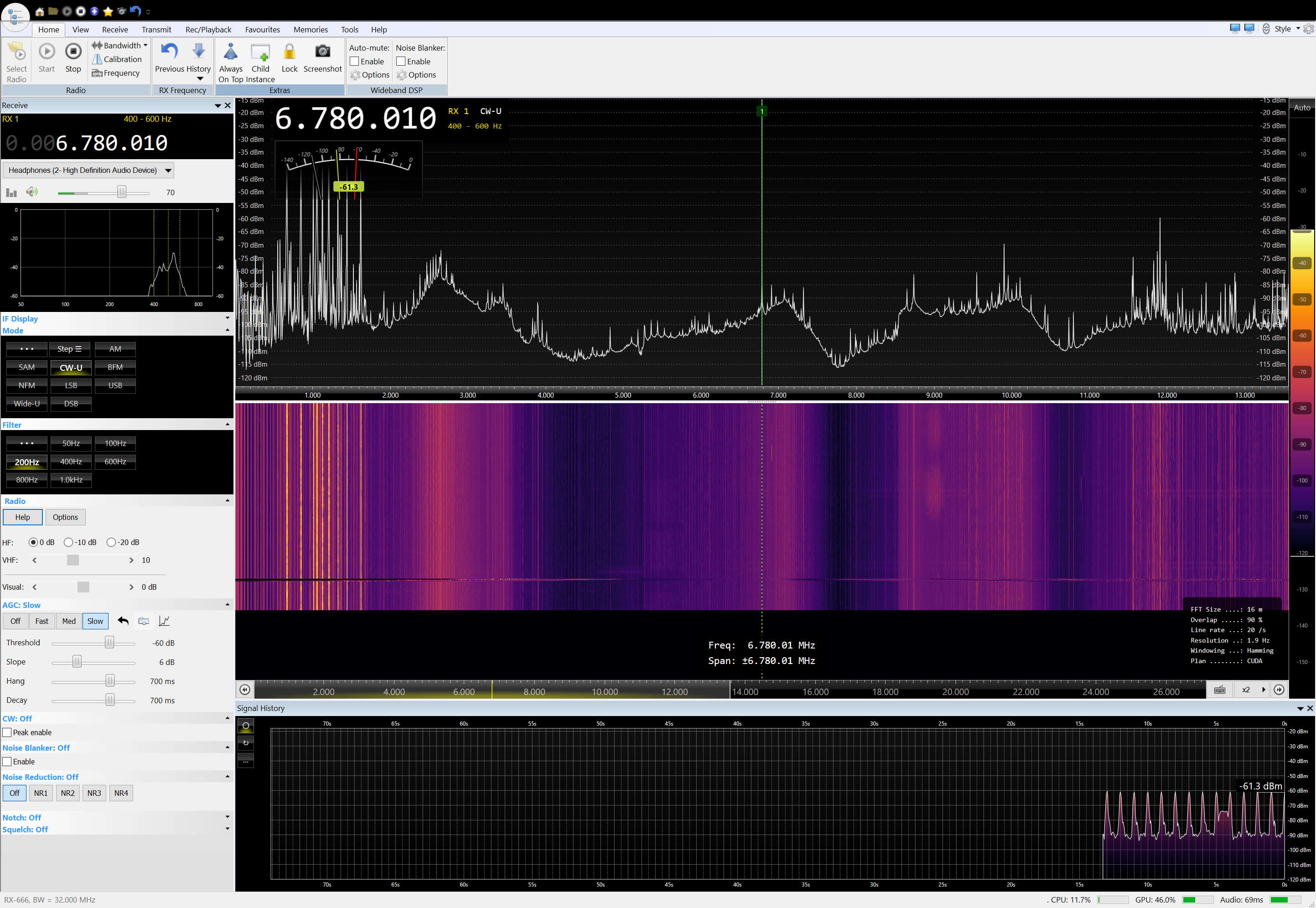

Re: Test Team & The RX888
Simon,
Solved my problem (or one of my many!
. Attached is screenshot of SDRC V3.0.25 with my RX888 running smoothly at 32 MHz BW. I upgraded to an i7-10700K CPU with m'board, memory, etc., etc. (They told me that 11th Gen will be available only next year ... and will be $$$.)
V3.0.26 still will not run, as it cannot seem to load the driver for the 888.
Thanks again for the s'ware and the assistance!
Regards,
Charles.
Regards,
Charles.
