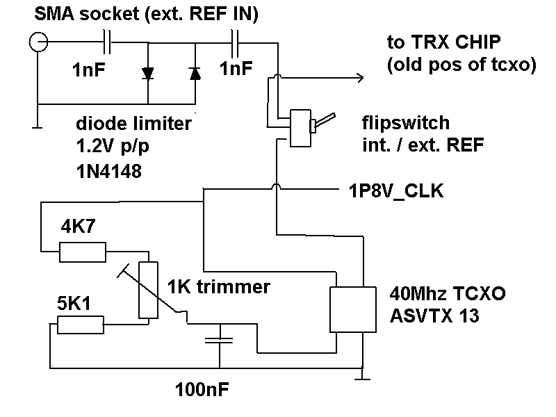

Hi Sigi
I converted my Pluto to 40MHz reference input yesterday, taking care with a scope to check that the levels were correct (or at least the same as it was with the internal oscillator).
However, I was about 500Hz off frequency when receiving a test signal on 144MHz. It seems there is an offset stored in the Pluto relevant for the internal oscillator. I reset this with SDRC to 0ppm and it now works fine.
Charlie
dg9bfc_sigi
Posts: 140
Joined: Sat Aug 08, 2020 10:43 am
Re: MODDING PLUTO
Unread post by dg9bfc_sigi »
in config file in the pluto you will find xo correction ...
xo = ......
fill in the 40 megs
xo = 40000000 ... save config and do a reboot
