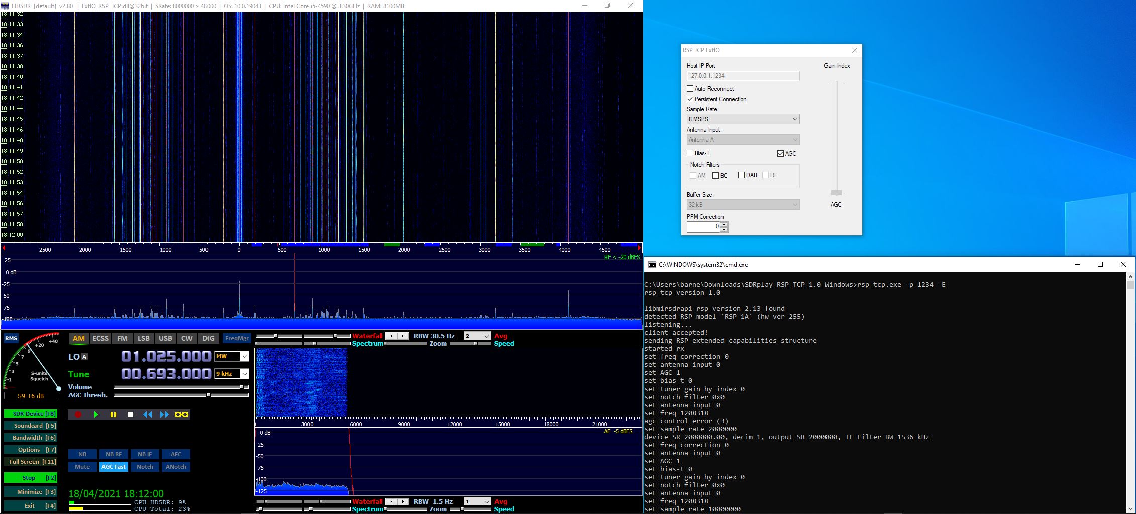

cjbazen wrote: Sun Apr 18, 2021 1:33 pm Yep, makes sense. I tested multiple sdr software and only found one (sdrsharper) that supports rtltcp and setting a custom bandwidth and setting it to 8MHz manually worked fine.
HDSDR supports rsp_tcp using the RSP TCP ExtIO.dll and works up to 10 MSPS.
I don't like that software though, I only use it for comparison during testing.
