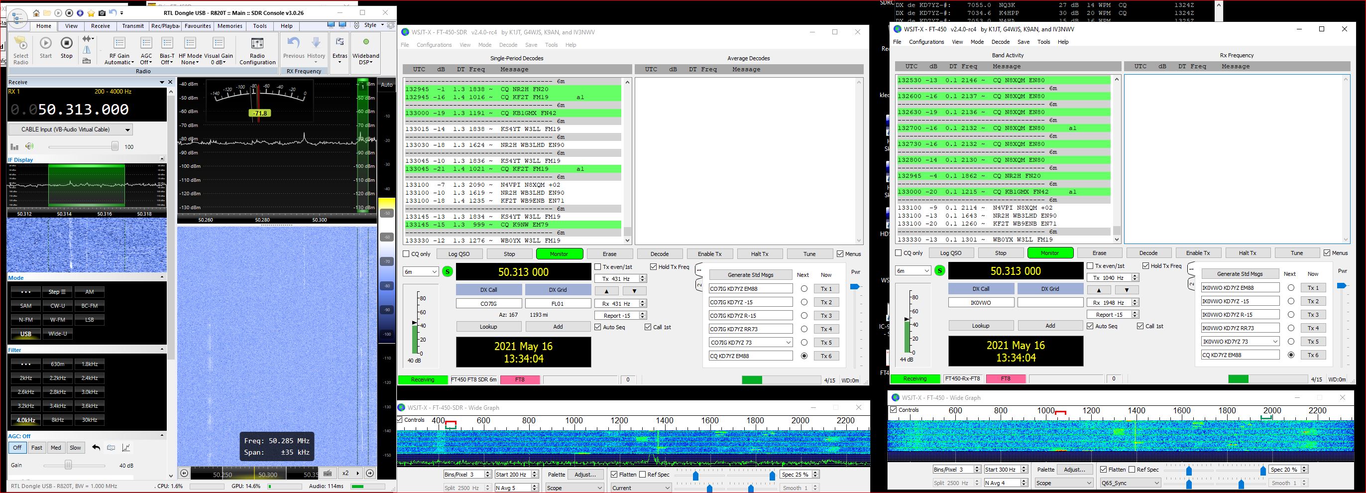

I use the VAC from https://vac.muzychenko.net/en/ to output Line-1 .
Then I use Line-1 as the Audio source in WSJTx RC4.
When using FT8, I see delay (dT) of up to 2.5 seconds. Typically the delay is 1.0 to .15 .
So, when I run the same WSJTx and use my rig's USB-Audio-Codec as the Audio-In source, I ge4t the expecte4d nominal 0.0 to .2 second dT showing up on the decode window.
My feeling is that the excessive dT variance might lead to "No Decodes" in many situations .

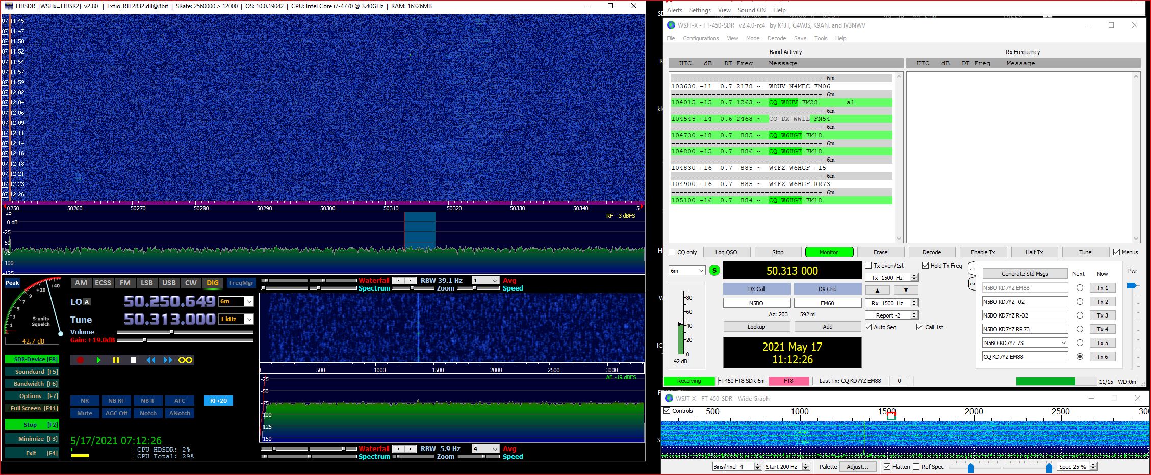

here's a screenshot comparison side-by-side WSJTx iterations.
Using Line-1 out of SDRC to WSJTx Audio In causes Delay

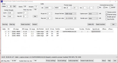

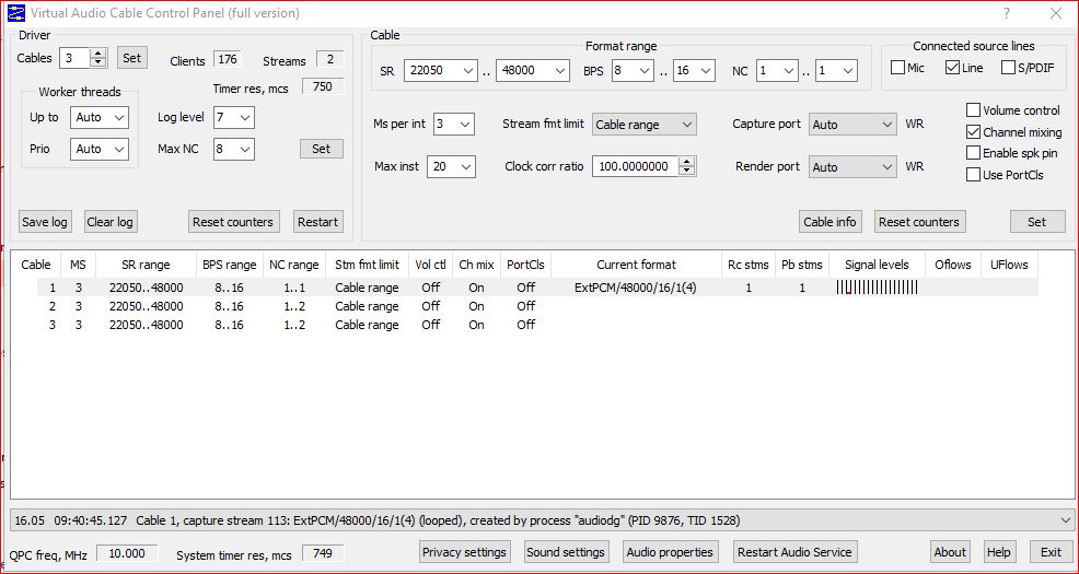

Let's see the VAC settings. You appear to be decoding OK.

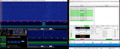

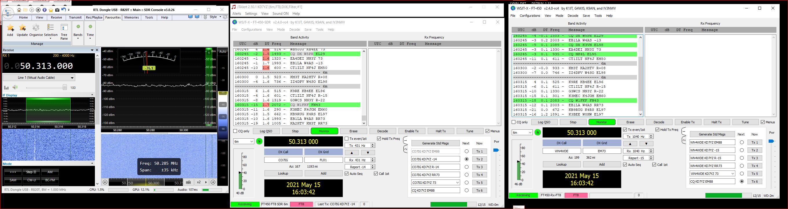

Re: Using Line-1 out of SDRC to WSJTx Audio In causes Delay

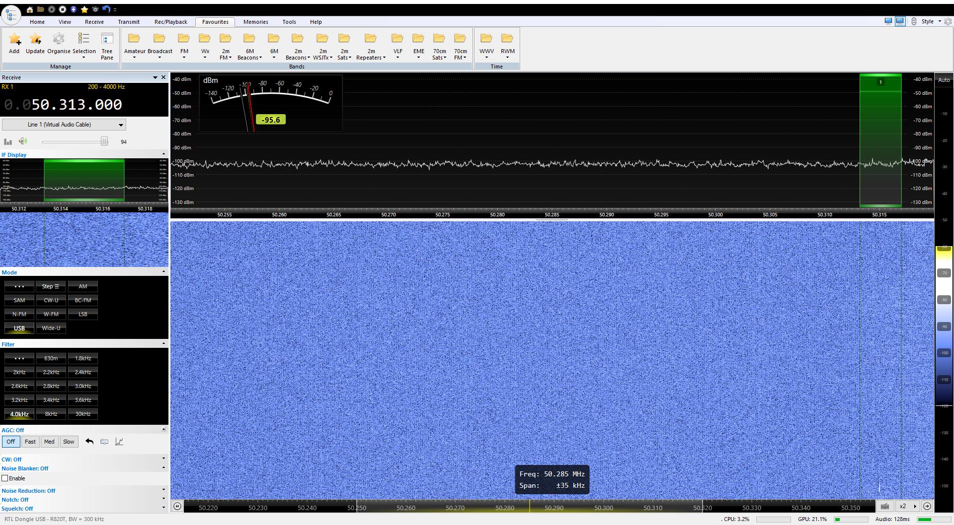

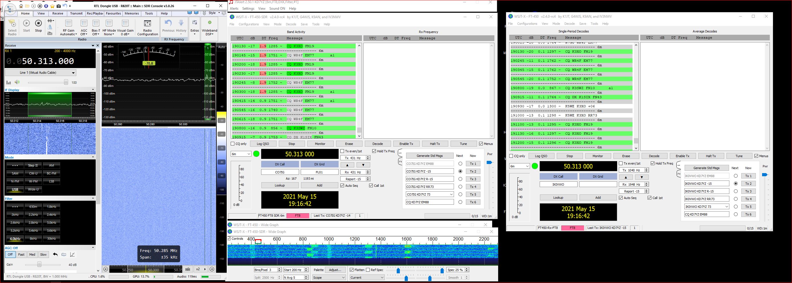

I am including three screenshots.
VB as a substitute for VAC made absolutely no difference.
That is the jpeg with VB & RTL .
What is significant is that if I restart SDRC, then the dT ALWAYS begins at 0.9. After perhaps 1.5 to 2 hours, I begin seeing the 2.5 dT
This is repeatable.
So, changing virtual audio cable software made no difference.
It isn't WSJTx, I believe, because as seen in the jpeg, the side-by-side comparison shows perfect dT's when seen through the USB-Audio-Codec source from the radio. --
Bob KD7YZ

OK, where do you see the time offset? I suspect your cheap RTL Dongle needs calibrating, so you have any other SDRs?
Hello Simon.

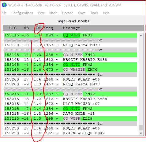

Time Offset, expressed as dT: I crudely circled the area inside WSJTx
While the NOOELEC dongle is cheap, admittedly, I am unsure where I would 'calibrate' the time offset. I believe I can, however, adjust the frequency-correction somewhere.
