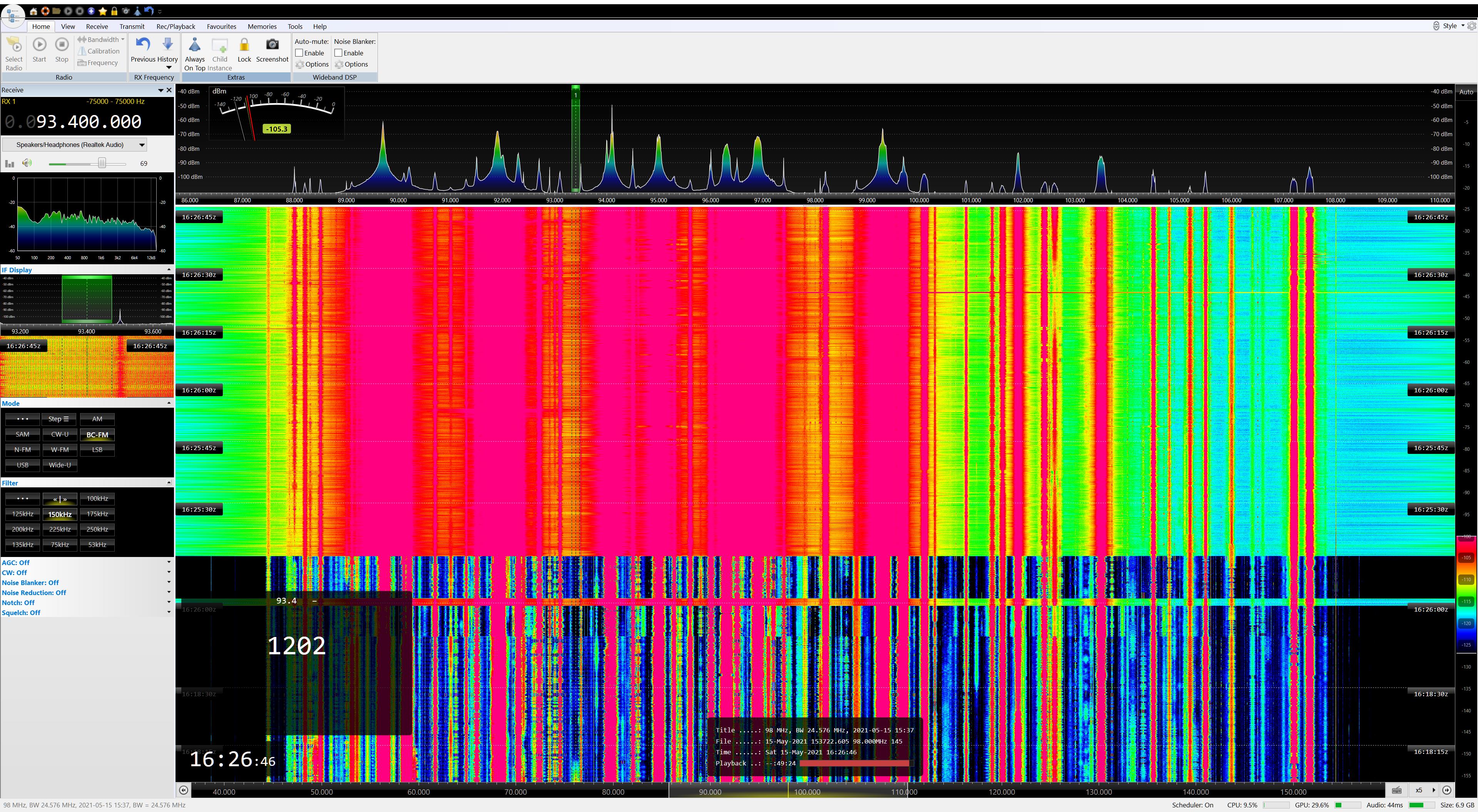

I'm getting an odd occurrence whilst recording in v3.027 with my S3. Randomly the waterfall will turn red and the audio goes very weird (see attached screengrab).
. It's almost like it suddenly overloads.
This happens when there's no interaction with Console by me. The only way to get Console back to normal is to stop processing and restart.
I have attached a log file from when this last happened. I'd be grateful if you could have a look at the log to see if there's anything glaringly wrong.
Thanks
Mike

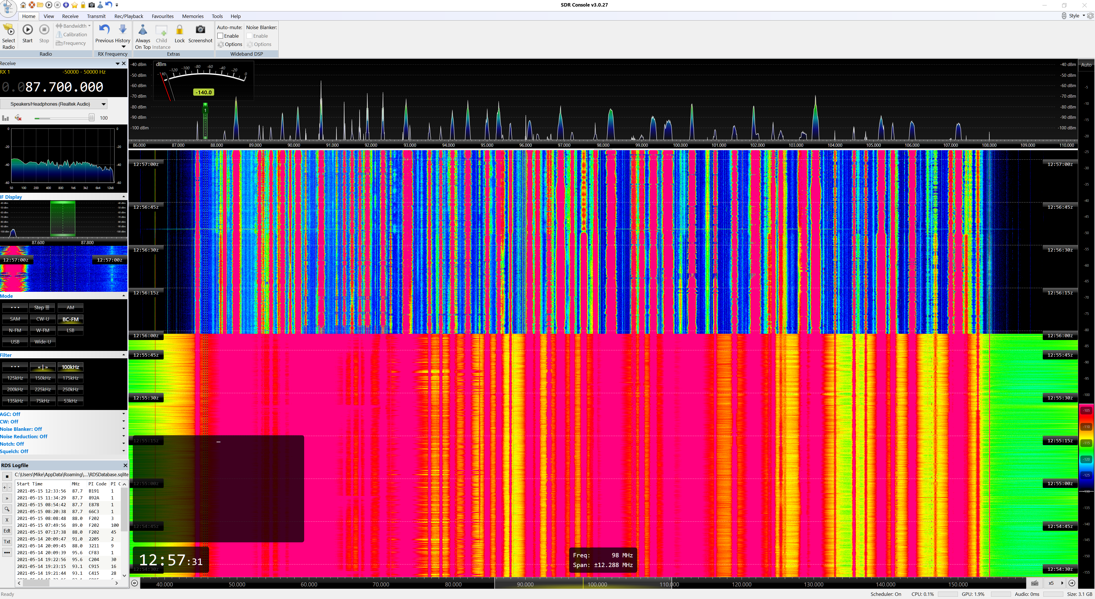

Here's a grab while Console is running.
I've moved the S3 to its own USB3 pci-ex card to see if that helps if it is a USB data problem.
Mike

Please show the FFT info: Ribbon Bar, View, Waterfall Extras, Statistics. Looks like a strong signal close by overloading you.
