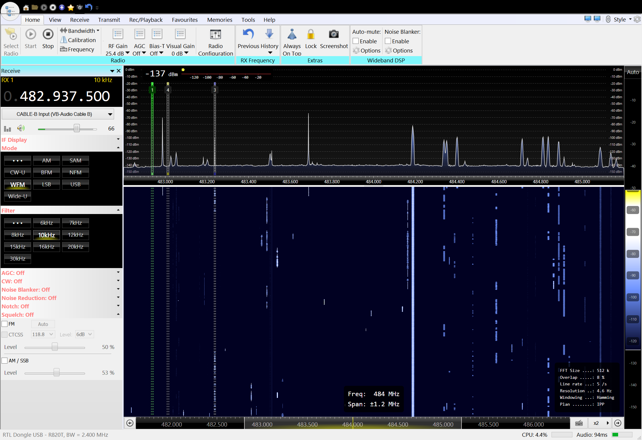

I thought that, given no decimation or other "tricks", maximum dynamic range is 20*log(2^(# of bits)) dB. So for an 8 bit RTL SDR the maximum dynamic range should be 48 dB. Yet I'm seeing upwards of 70 dB in the attached. The spectrum amplitude scale is relatively linear - I checked it against my HP8640B. AGC is off.
What am I missing?
