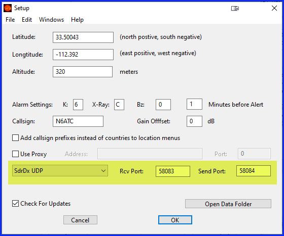

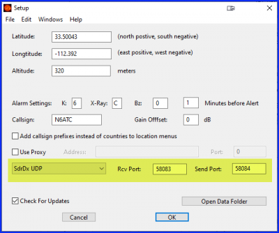

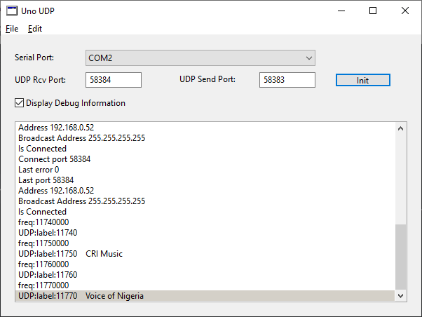

I have it configured like this:
COM2 is the VSP selected in Console
Next, you set up the dxtb in the Setup menu
