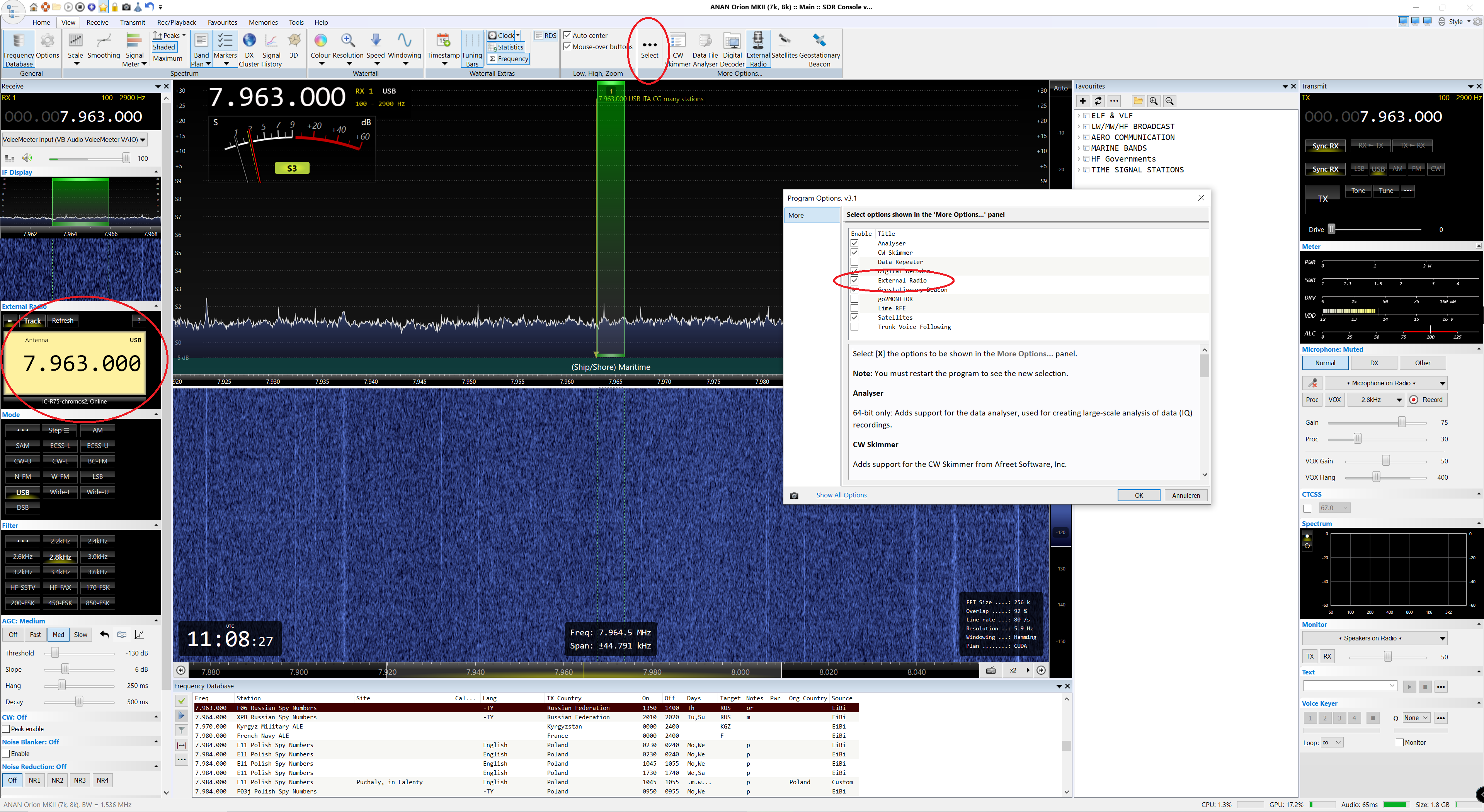

Update: As of today, I have abandoned HDSDR & HRD. Now using SDR Console 3.0.27 and all is working except I cannot get "External Radio option" under view within SDR Console to take and display within DSP window pane. I am running latest version of SDR Console 3.0.27 and Omni-rig 2.1
Any suggestions?

Re: RTL SDR & SDR Console
Does this pict provide any help?
73 Leon

Leon,
Thank you. Yes, I fixed the problem, but only after re-installing Omni-rig, the External Radio would show up in my DSP pane.
