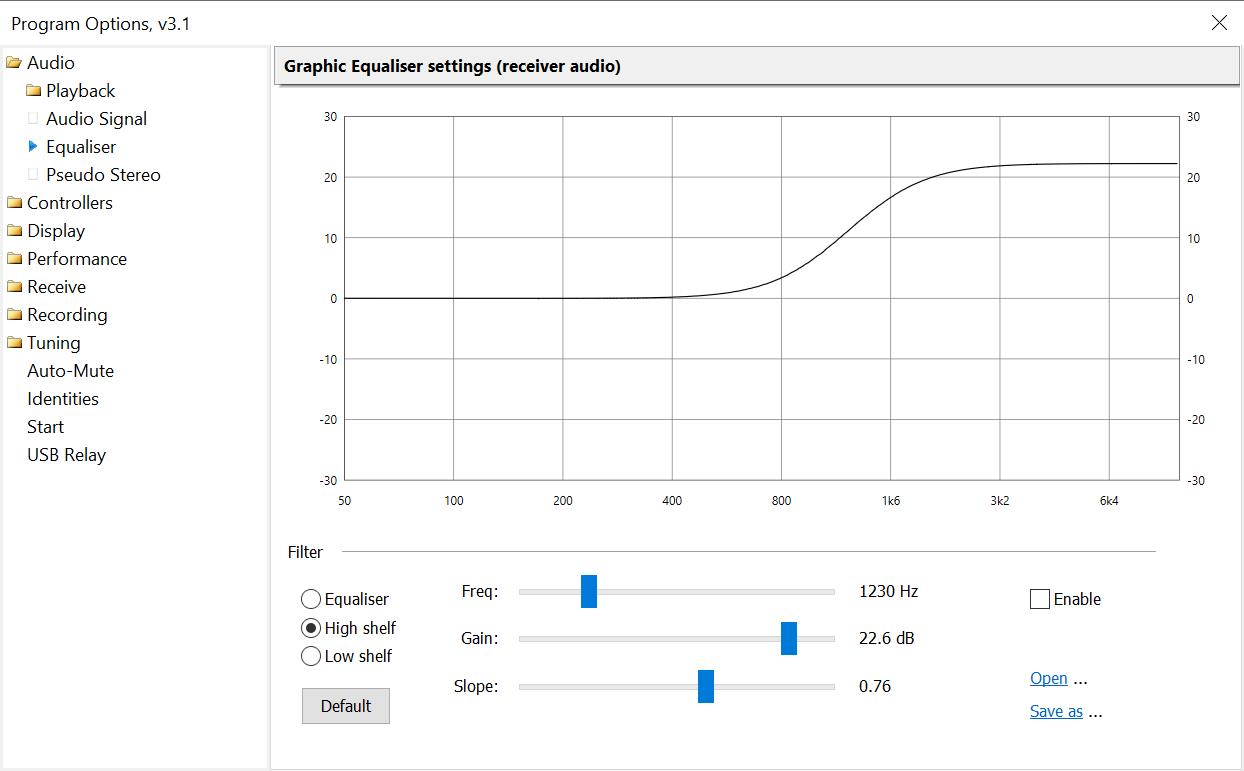

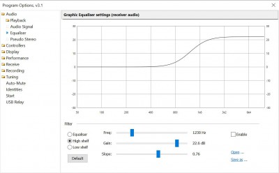

As jdow wrote, mobile phone videos are useless I'm afraid. Let's start with a screenshot, also look at the equaliser (see attachment).

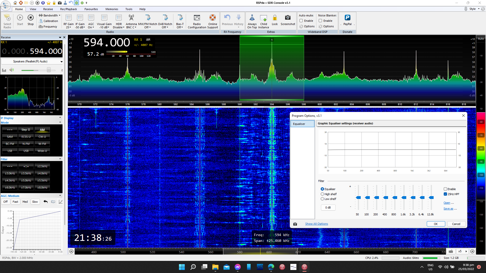

Here is a screenshot. I did try adjusting various settings in the equaliser. I have turned off audio enhancements. No change.

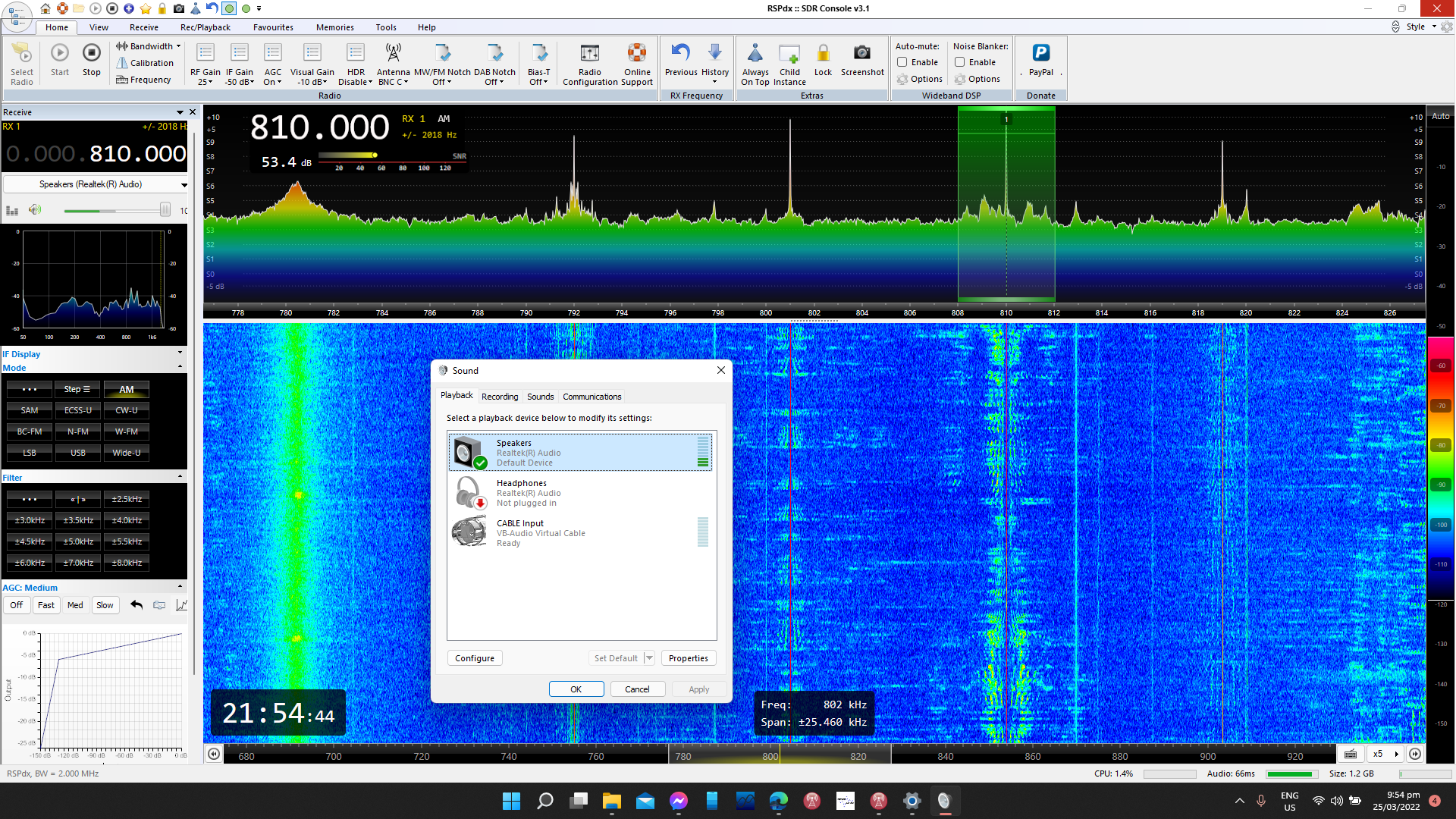

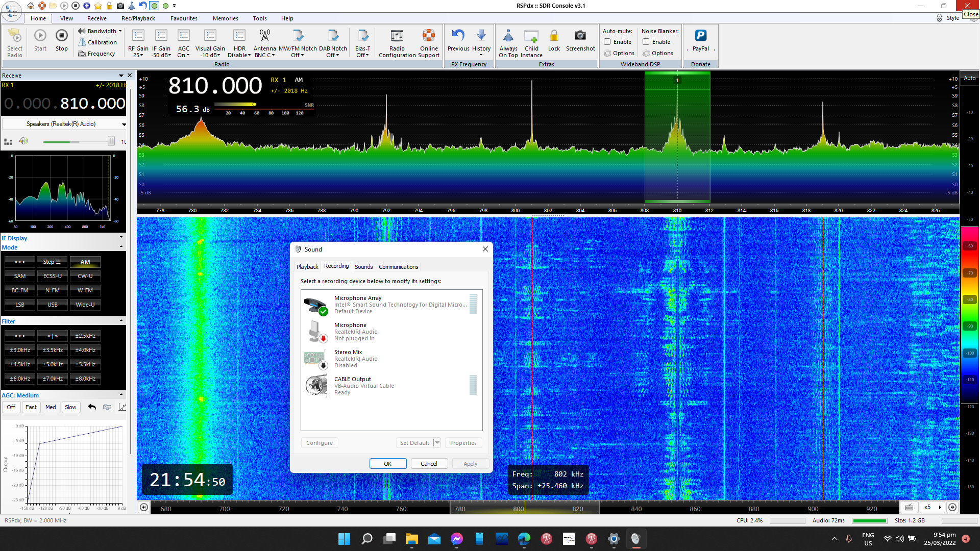

However when opening the sound settings I have discovered that when the Playback tab is selected, the clicking is evident. When the Recording tab is selected, it stops. Also when having the internet browser open in front of SDR Console causes it to reduce significantly, minimizing the browser so that SDR Console is on top brings the noise back.
Update 1: I've also found that disabling the Microphone Array has stopped it. However I need a microphone so I can't keep it disabled. I will keep working on it.
Update 2: The microphone was set to 16 bit 48 kHz, the speakers set to 16 bit 44.1 kHz. I have set both to 48 kHz and this has appeared to have solved the issue.
