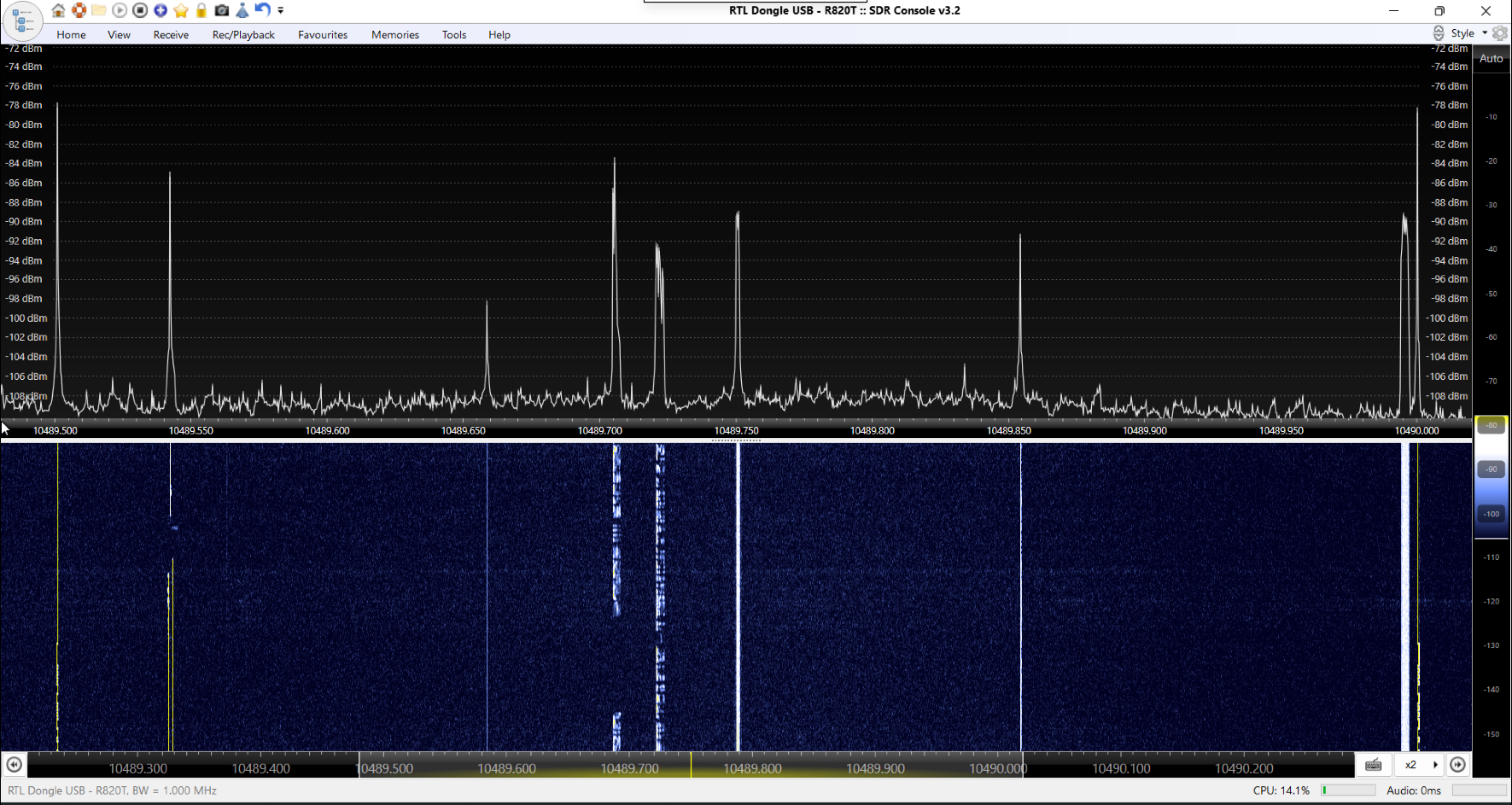

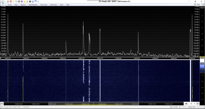

I use SDR console as spectrum display / waterfall to monitor the QO100 NB passband and monitor my transmissions.
I don't use it to listed to radio signals, only as spectrum monitor.
This means SDR console is run *without* a running receiver. I have the RTL dongle configured, I configured the transverter settings but there is no "receiver" - no big frequency display, no S-meter, no receive audio.
