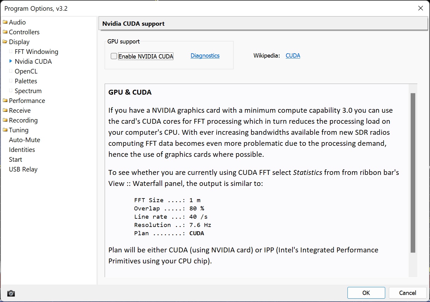

OK, sounds like a lack of resources. If you've enabled CUDA for the FFT then disable it.
You haven't told me much about your system. I don't really think it's much to do with the new SDRplay API but all things are possible. Web browsers can really eat up resources.

Hi Simon. Did a little more testing. Put SDRUno 1.42-0728 back on. And was able to crash the waterfall opening a few instances of FireFox. However, to correct my original post, when the waterfall freezes, the audio does too. There's a waterfall issue with SDRUno when I run the scanner function where it freezes under certain circumstances but the audio still plays so I think I was conflating that with the SDR Console issue.
Anyway, I did have the NVIDIA Cuda checked and I shut it off. That sort of seemed to make SDR Console more tolerant of background activity before it would crash but I'm not sure because it didn't seem always consistent. Also in the brief testing I just performed, SDR Console seemed more tolerant in general than the first time I had 1.42-0728 installed. So there might be some other contributing variable to this that I need to suss out.

A tentatively better way to describe this problem may be to say that SDR Console is less tolerant of resource depletion from background processes when the new SDRUno is installed and as a workaround may be somewhat more tolerant, but not perfectly tolerant, if NVIDIA Cuda is unchecked.
