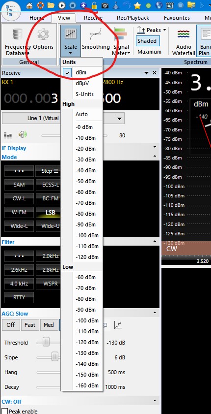

Thanks for the very kind answers to my request, but my question on the S-Meter full scale value has been misunderstood.
The View-Scale regulation only affects the power levels of the spectrum window, NOT the S-Meter's scale that remains with a full scale value of 0 dBm.
I would like to change the full scale value of the S-Meter when switched to dBm readings.
Re: S-Meter's dBm full scale value
IK0BGG wrote: Mon Oct 24, 2022 8:55 pm Thanks for the very kind answers to my request, but my question on the S-Meter full scale value has been misunderstood.
You can't at the moment.
