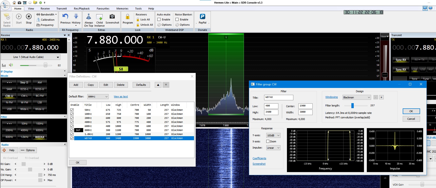

In the Modes, select "CW-U". You will then be able to program one of the filters with what you need and label it WEFAX. See the attached picture for all the filter entry number details rather than me explain it in words. Same principal applies to the RTTY offsets.
Happy WEFAX decoding!

I should have said the picture also shows my suggested setup in action decoding Hamburg Meteo with the correct frequency displayed, and filter set up with 3kHz bandwidth, correctly decoding the centred WEFAX tones at 1500 Hz and 2300 Hz. I've actually been using it all day with other WEFAX transmissions. All looks good.
Simon, not sure if you are reading this thread, but it might be a nice touch to provide additional CW-L and CW-U buttons as user programmable Mode buttons that recall their own set of default (user programmable in the same way as CW-U and L), but with user definable titles. That way when (for example) WEFAX mode button is pushed it could recall the correct default filter as I have described in my last post. It's basically adding an "Add, Edit" style menu to the Mode buttons three dots menu, the same as currently exists for the Filters now.
But having said all that it's no massive deal to select CW-U and a user definable filter "WEFAX" (or RTTY) as I have shown in my last post. It's just maybe a nice cosmetic option for the Datamodes folk?
